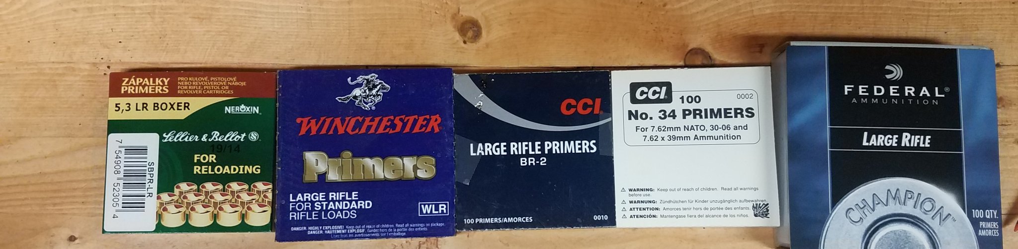

My next step is to reshoot the loads starting at mid 48 with 10 shots each of 5 ladders loaded with 5 different large rifle primers to eliminate the primer variable.
@RogueTanker What 5 primers would you be trying?

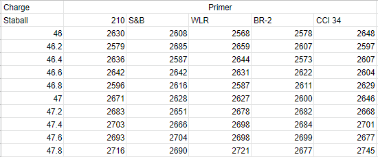

So here the results. I started to get heavy bolt lift and hard extraction on the top end.
Since, I was trying to eliminate the Primer Variable, I switched to Sierra 175gr soft points. i have alot of these, they're consistent and cheap. All other variables stayed the same. temps were a balmy 45° this morning. I ran all 50 shots quickly, across the same charge weight (i.e all 46.2 loads, then the 46.4, etc...). I will say the barrel was noticeably cooler than expected for the high ROF.
So it's looks like primers only had a small effect on the velocity. That leaves two answers from here: 1. the powder and data is slow or 2. the powder likes to be *significantly* over max to hit the published velocities.

How do you measure velocity?
You have crazy jumps in velocity with just .2 grains of added powder.
Charges dropped on a CM 1500 and measured with a magentospeed sporter with a fresh battery. I was thinking that might have been an issue so I put a new one in. I have used this brass with XBR 8208 and don't have such random movements. This powders seems to be up and down and all over the place. As most powders tend to trend upwards with increased loads, this powder just doesn't want to be consistent.

Do you have any 25 shot temperature "real world data" that you've conducted in the calibers you shoot competitively?
Just thinking, that's twice I've had two major spikes with a .2 change in powder at the top end. The first time I thought it was the different primer. Well I didn't see much of a change with the second test, until that last magnum load. Maybe in this round, there is a pressure threshold that has to be met before the velocity develops. Guess a round three is in order. Gotta say I'm fairly disappointed with this powder overall though. Things just aren't lining up.
Try 2.800” OAL like in Hodgdon’s data. You were within 10FPS with 46.2grs.
With the S&B and WLR primers I was right there. Then they promptly nosedived the next load. The erratic ups and downs don't seem like they'll translate to accurate and stable nodes. And if I loaded them to 2.8, I'll be jumping the bullets .160" to the lands. I can't imagine that'll work. But I could be wrong.
Don’t be scared to jump. When shooting heavy bullets close to the lands with too fast a powder you get weird pressure spikes. Seating the bullets deeper gives them more of a running start and eliminated this problem.
Also, a shorter COAL might put the bullet in a better jump node for ES/SD purposes.
I once had fits over this with Berger LRBT until I decided to find a shorter COAL with the same charge and got the ES under 10 FPS.
I routinely jump .140”+, shoot in the .2’s
