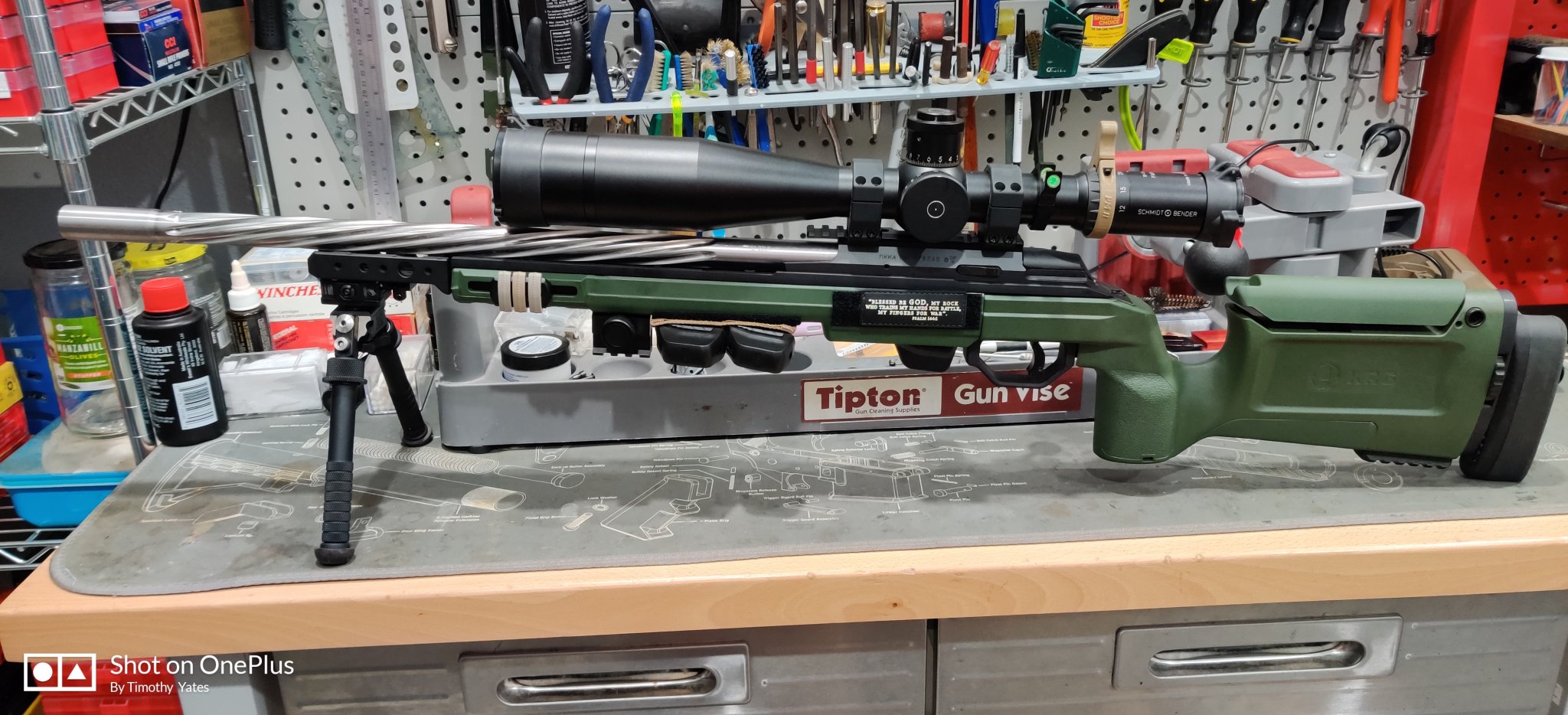

Here is what a fluted barrel will look like.
