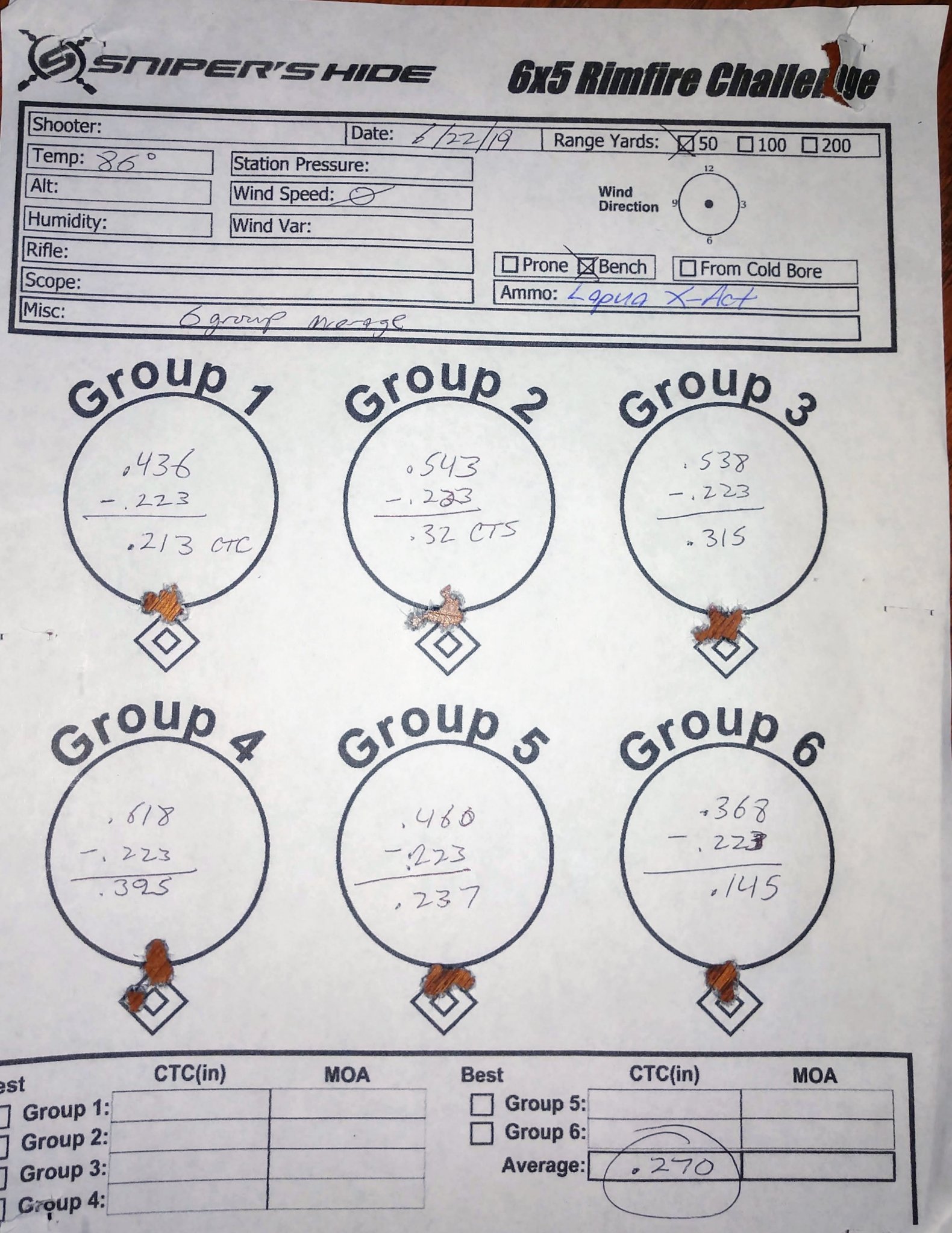

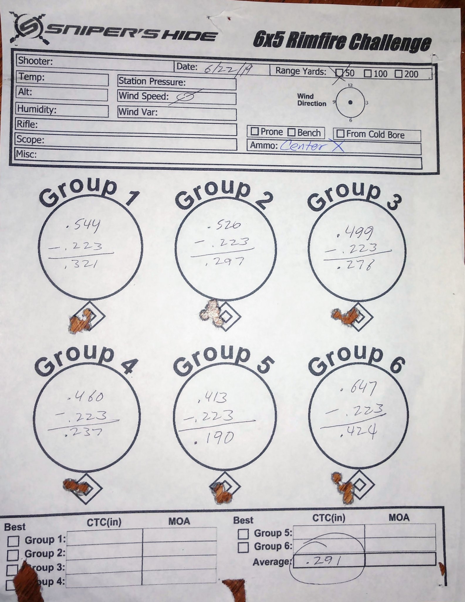

Found my 6x5 targets from a while back. This is the group buy barrel without tuner:

Wow, I won't lie, that look insanely good. Great shooting. I might just pick up one of the IBI barrel from brownells as my back up barrel when i get the extra cash.
If that is any indication, I cannot wait to see how would mine perform. Are those group you shot with the glue in barrel? I am getting mine with the set screw and i hope it doesn't affect accuracy that much.
Yes, that's the glue-in. It probably doesn't cause a very noticeable difference in accuracy and the regular set screw barrel can be glued in if you like. I had to remove a glue-in on a different rifle one time and I can guarantee it will never move unless you really want it too. They are very hard to take apart without heat.
I wish I kept the other targets with different ammo. It was averaging mid-3's with a good lot of CCI Standard. They only thing it hates is RWS R-50 for some reason. I'm probably the only person around who has had bad luck with that ammo. It shot so bad I didn't measure it.
