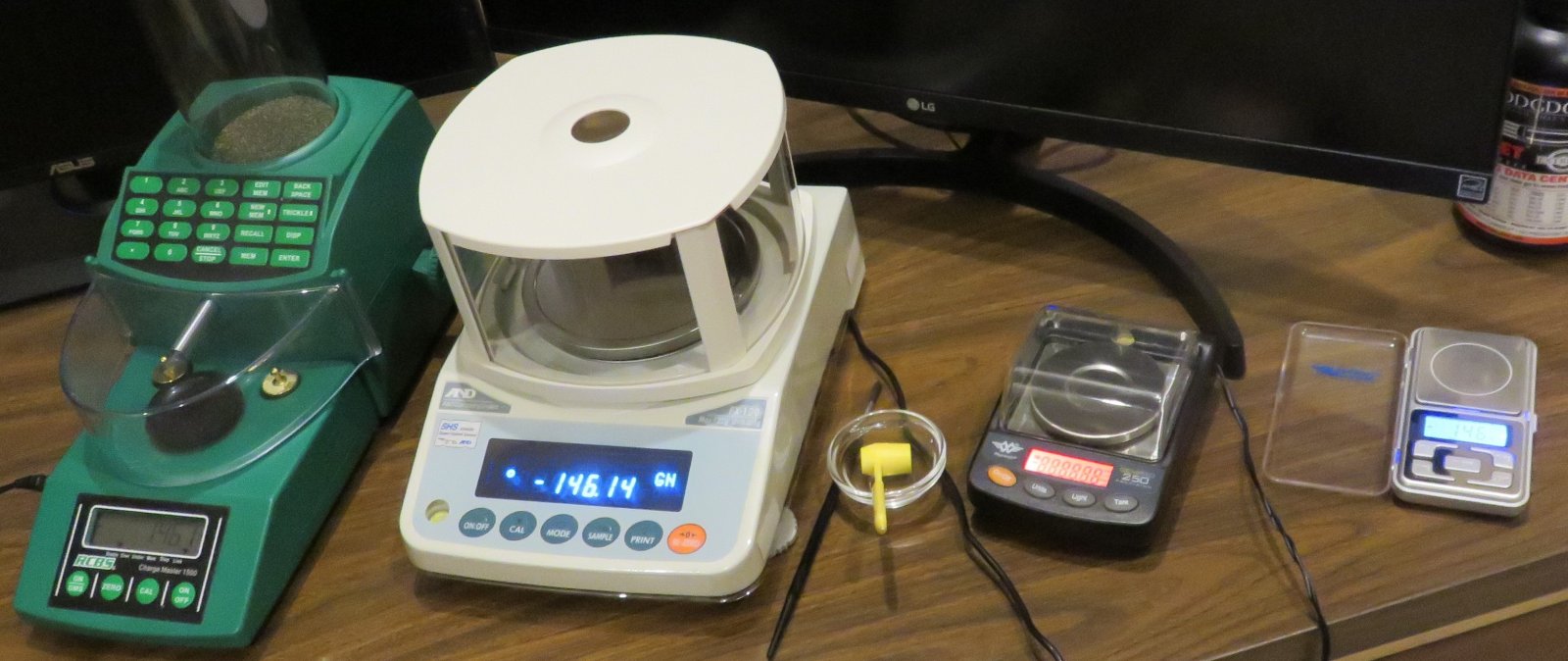

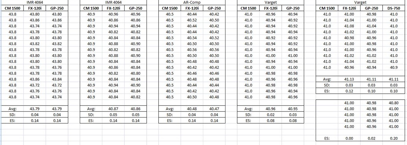

Here's a little comparison I did to compare my other scales to my Chargemaster:
