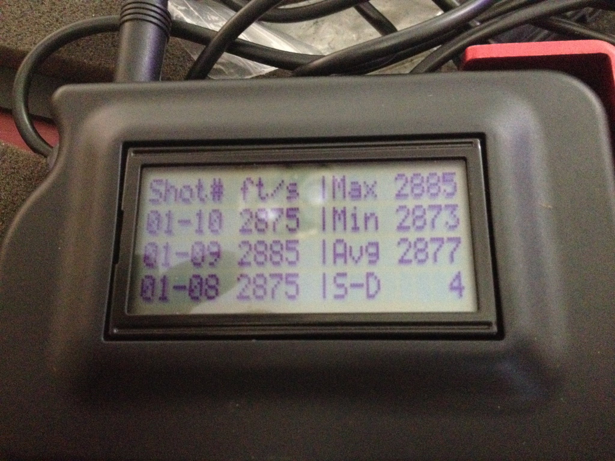

I use small rifle magnums in 223 and large rifle magnums {CCI250} in everything else. 22-250, 6 and 6.5 creed, 308, 280, 300wm. Never knew I was doing it wrong. :LOL:
I mean, I don't think any one is doubting YOUR loads or process lol. But it may not be the best advice to a brand new reloader. I use small rifle primers in my .38/.357 loads but I prolly wouldn't recommend it to a new reloader.
