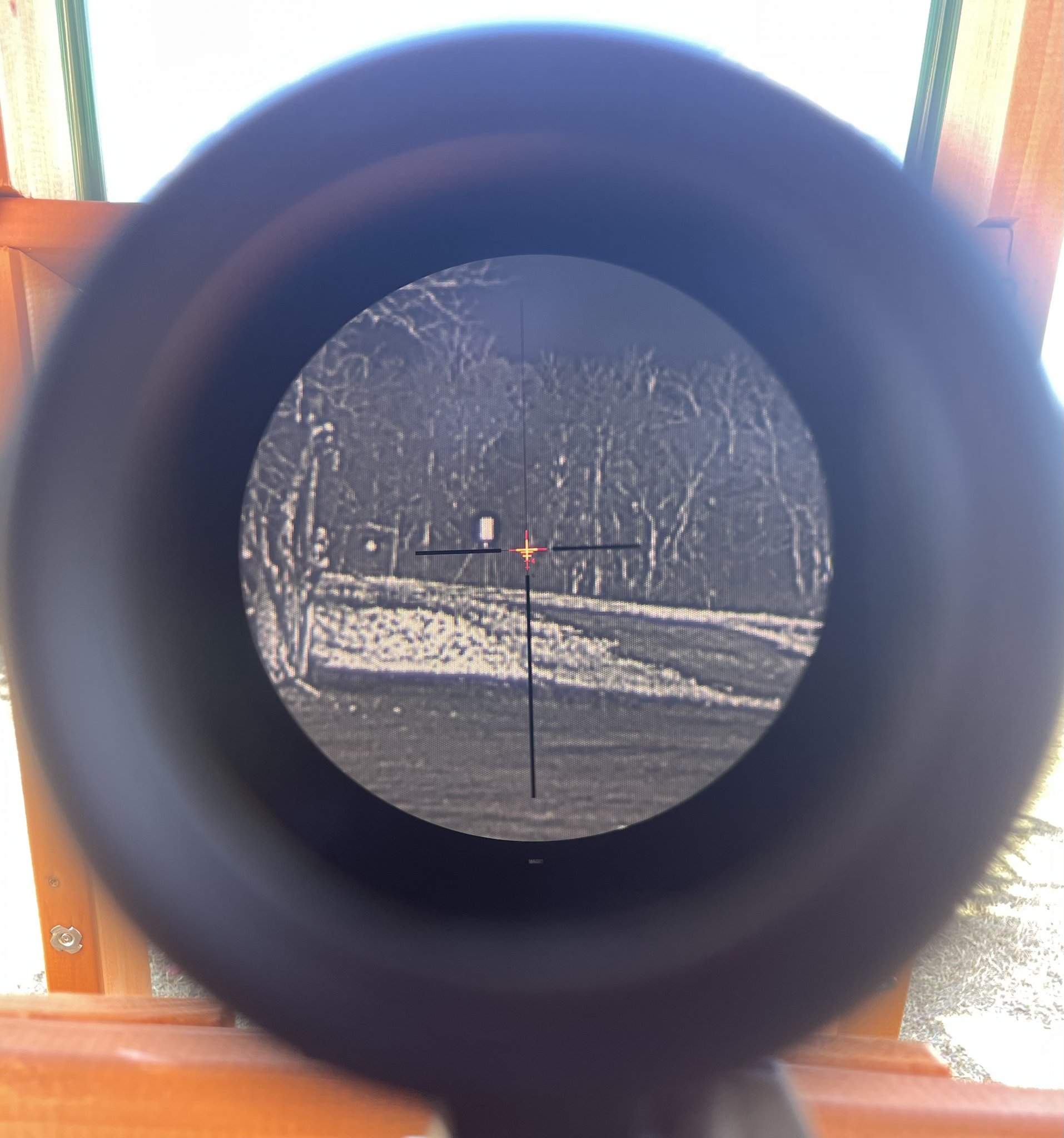

Below is a 4x Acog looking though it at 300 yards
We are opening up pre orders on these today!
My honest opinion on the little thing is I love it. I’ve used the voodoo, skeet x and all those ridiculously expensive monoculars and there’s absolutely no way in hell I’d pay that for those if this were available at only 6k. Even if the voodoo were 8k I wouldn’t get it over this. I’ll have a video of it in action as soon as the rain stops this week. If you have any questions ask away.
Below is a 4x Acog looking though it at 300 yardsView attachment 7809272
300 yards during the day :)

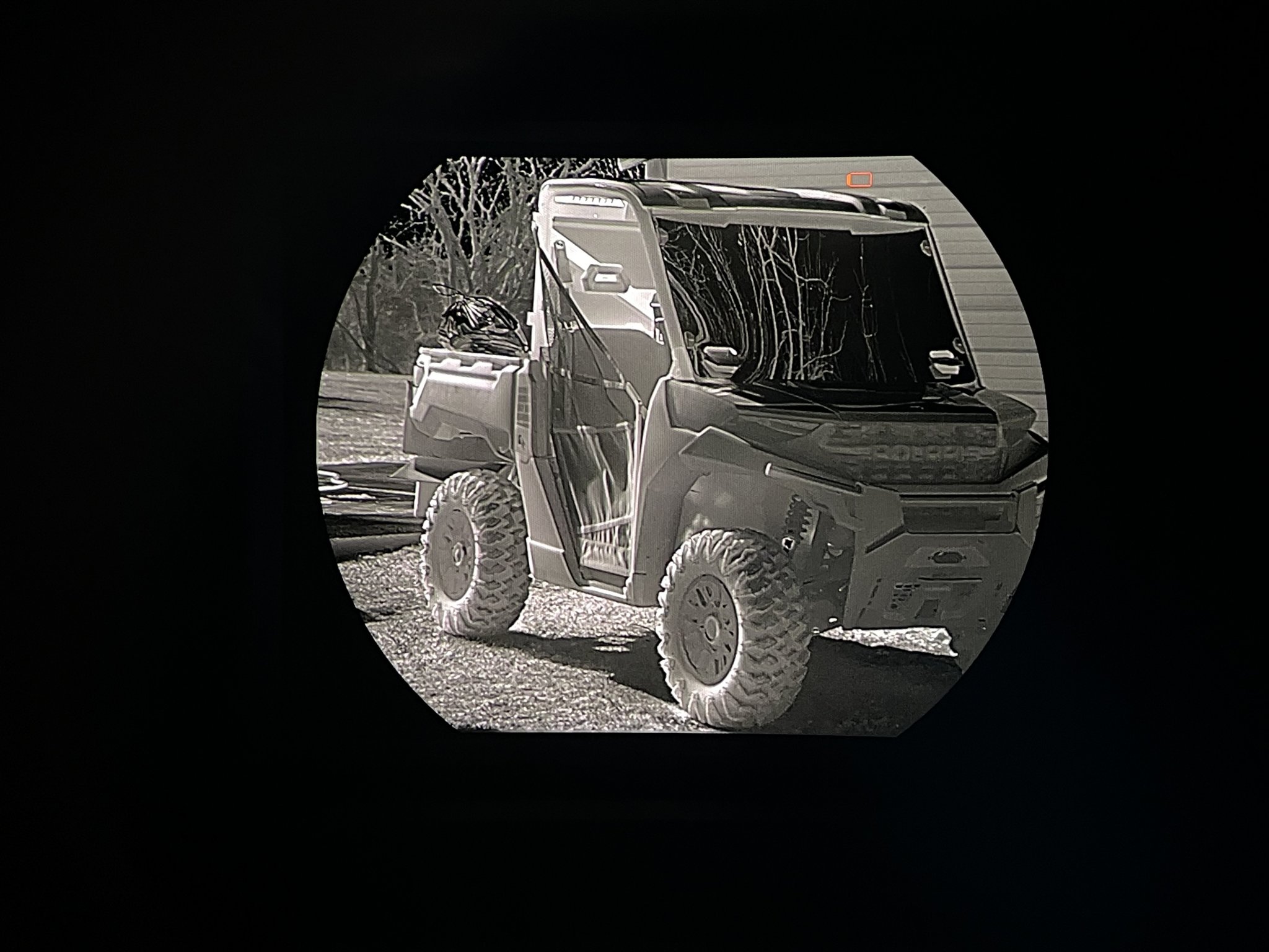

Where are people seeing that it has a round display? Maybe I missed something but I'm not seeing that on the iray site. That seems like it would make a big difference for helmet mounted and I've been hoping someone would take that step for awhile. The fov is a bit disappointing but it seems to bring a lot to the table for 6k.
Reactions: WhereNow&How
the sides are rounded, it matches up much better with a 14 when running it bridged with i2.
