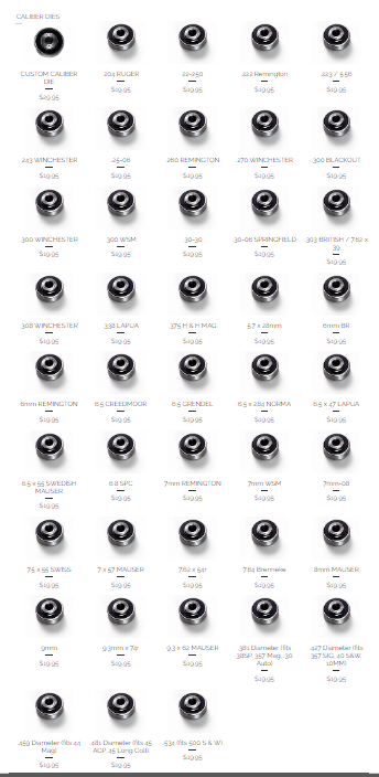

I can´t find a list of their caliber dies.
Do they have my calibers?
Lots. Its on the Shop page and you scroll down and they are at the bottom
Reactions: Jayjay1
Now I see, sorry, stopped there because I thought it had ended.
