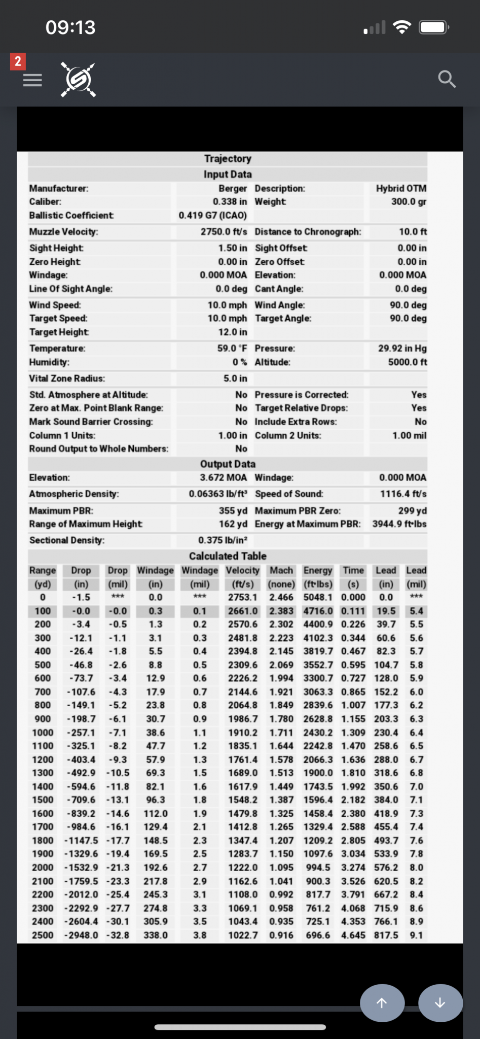

This pic was stolen off another thread here. But has drop for 300 Berger/338 LM at 2750 fps to 2500 yards. Theoretically if you put a 40 moa base on the 5-25 atacr with 120 moa of elevation the elevation available should be around 100 moa or about 29 MIL. Which would get to just shy of 2400 yards. But allow a closer zero.
