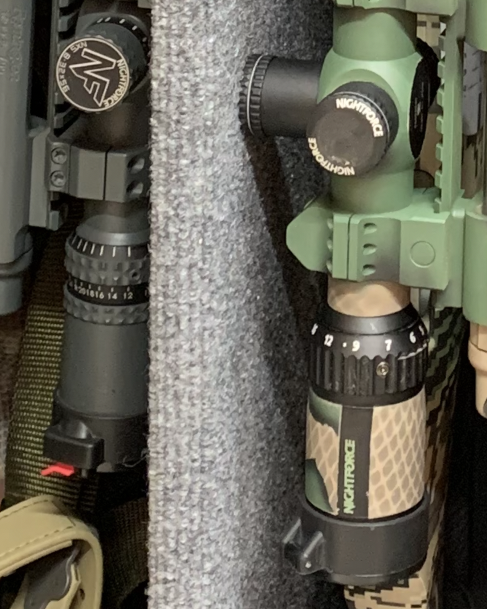

Just for truths sake, you're thinking about the ATACR line. The NXS line does not have rotating ocular bells.
Your gripe is not with the scope line the OP is asking about.
I am not mistaken. When an NXS is zoomed, the entire ocular rotates. That low power one MIGHT be different. However, for you to say that the entire line does not is most definitely not accurate.
I am not mistaken. When an NXS is zoomed, the entire occular rotates.
Not the case with the 2.5-10 NXS.
Unless the ones I've owned and still own are somehow different then all the ones you've seen.
One of us I misremembering and mine was in my hands as recent as yesterday.
I'll pick mine up this afternoon to make sure I'm not retarded.
On the left, NXS with rotating ocular as it zooms. On the right, SHV with non rotating ocular as it zooms.
That is fair.
Allow for me to restate.
The 2.5-10 NXS' ocular does not rotate when adjusting the magnification, so a flip cap will not rotate on you when you are using the scope.
I don't have much time behind the higher mag NXS' so I didn't remember them being like the ATACR's.
