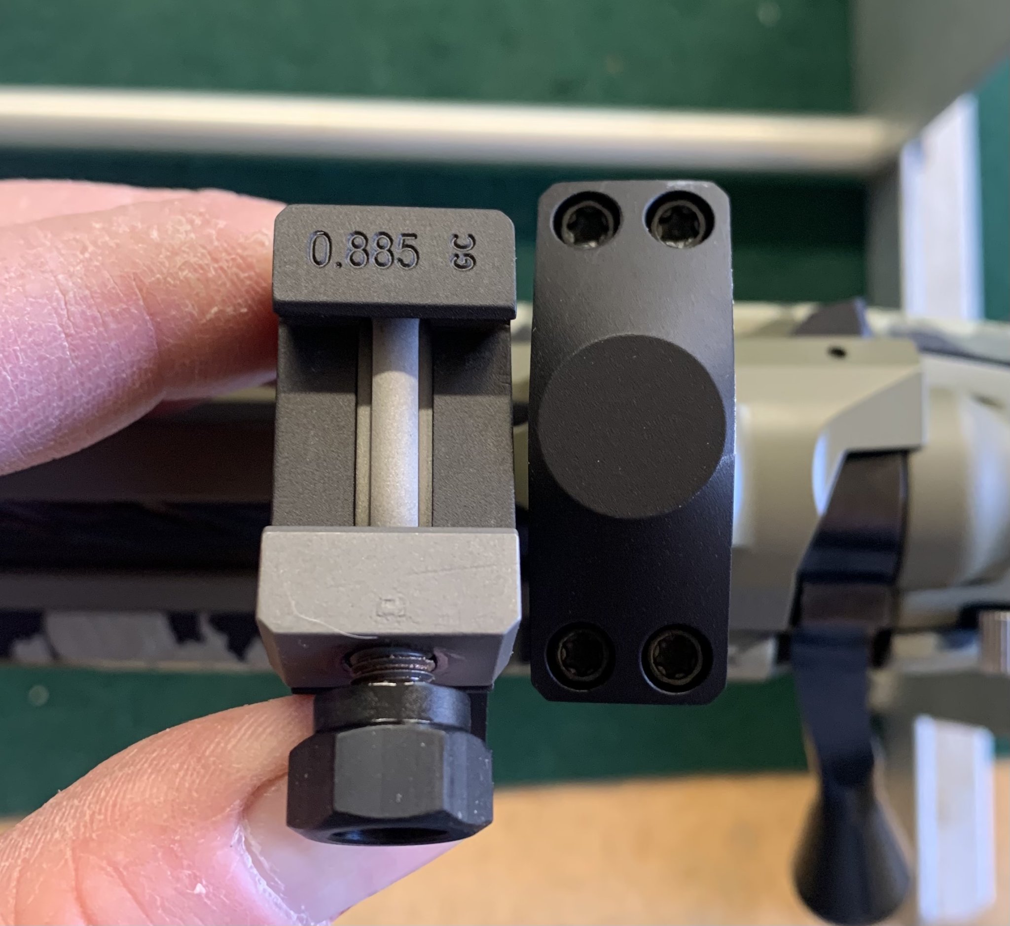

    Thanks for the info, I also emailed Nightforce, I’m expecting the same type of response. Here’s a pic next to a snug fitting Arken set, the size is noticeably narrower, I’m not against it, just wondering if there was a update, because they advertise a precision machine fit for pic rails.
    I understand what you're saying and it seems your NF rings are good to go. Some manufacturers have thicker recoil lugs that give it a nice tight fit but that can have drawbacks as tolerances start stacking between the rings and base. NF, like quite a few other manufacturers, is playing it safe by allowing some extra clearance between the lug and base slot to ensure compatibility across a wide range of picatinny scope bases.
    I can definitely see the point of tolerance stack.

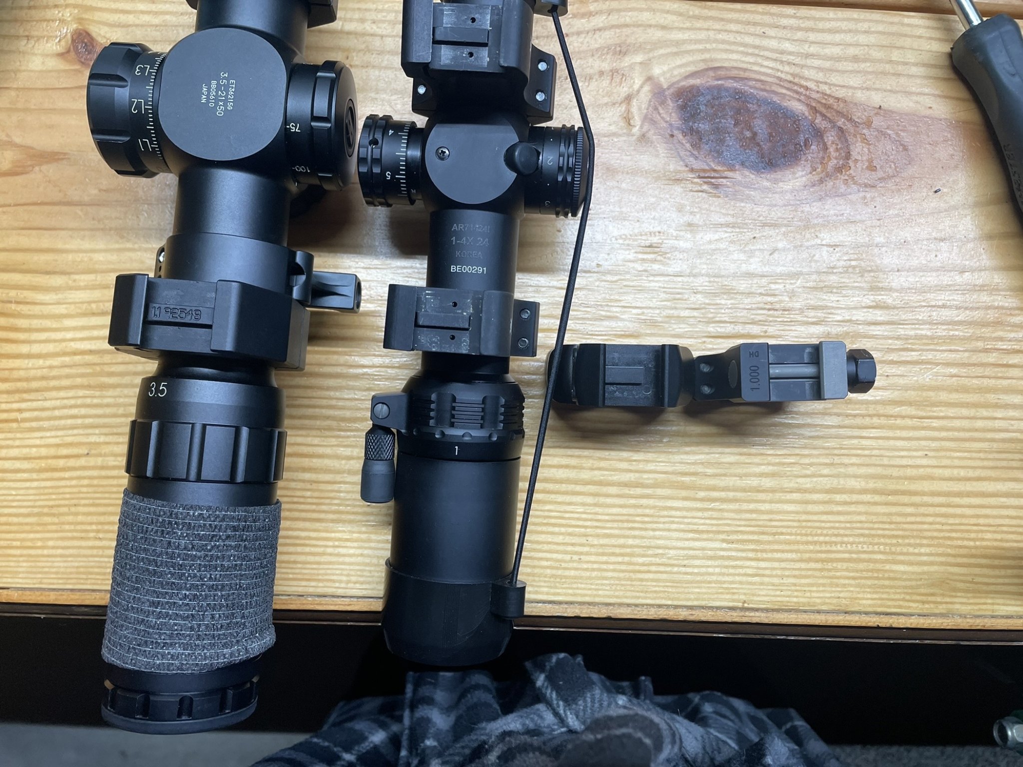

    I had to go down in the gun room and pull some scopes for pics.
    Left to right,
    Seekins
    Vortex
    And those air soft Arkens you see everywhere on everything, all three of those fit with less slop than the Nightforce. Period, it’s even obvious looking at them. Last is the beloved Nightforce rings. Look how cute those little fuckers look compared to the others.
    Less slop, means fits better here in Ohio.
