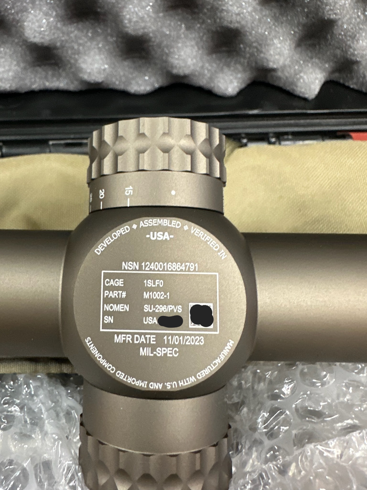

Rifle Scopes Nightforce Mil-Spec ATACR's are finally for sale! SU-294 and SU-296
All,
Just for some clarification- This is just a presale. We are still taking orders and they are availible....so any orders are official. These are on the way to our warehouse, and we will be shipping shortly. They will have the same limited lifetime warranty, and are serviceable.

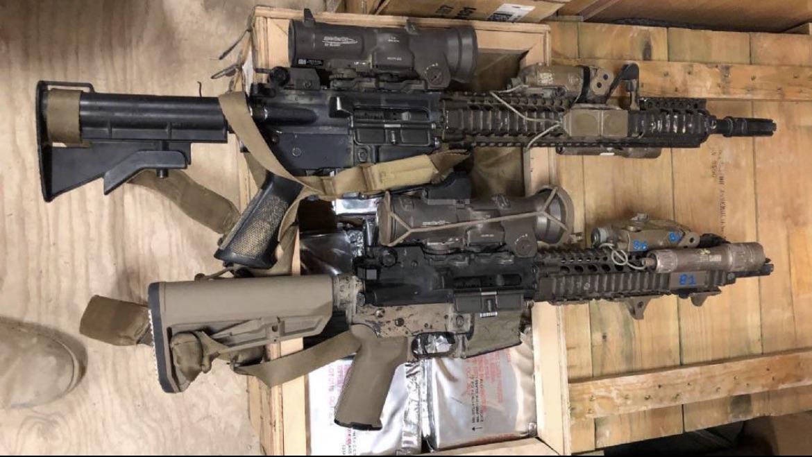

In regards to the ballistic drop being close between the 5.56 and 7.62 NATO ammo (after the initial zero), the Army SF has been using Elcan Specter 7.62 BDC scopes on their M4A1 and M4A1 FSP 5.56 rifles for a while. Apparently the 7.62 BDC lines up decently (not exactly) with the ballistics of the 5.56 in a 14.5" barrel. Here's a photo of Army SF rifles with the 7.62 BDC Elcan scope on the 5.56 rifles (M4A1 FSP 14.5" on top):
Having only 1 reticle to order saves the government in terms of quantity and money when acquiring new scopes, so it's understandable why they did this. The ballistics will line up decently enough to warrant a single reticle with 2 zero spots. They could have definitely tried to do something more with windage holdovers, but this is what they decided to go with. It might be confusing at first, but the guys being issued these scopes don't train until they do something right, they train until they can't do something wrong. I have no doubt in my mind that everyone issued the SU-294 with this reticle will be extremely proficient with using it.

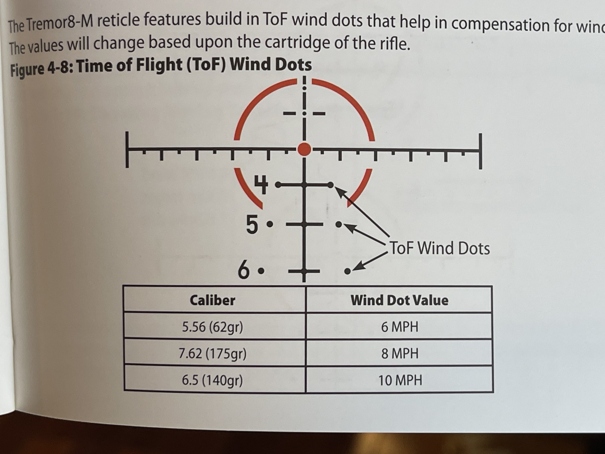

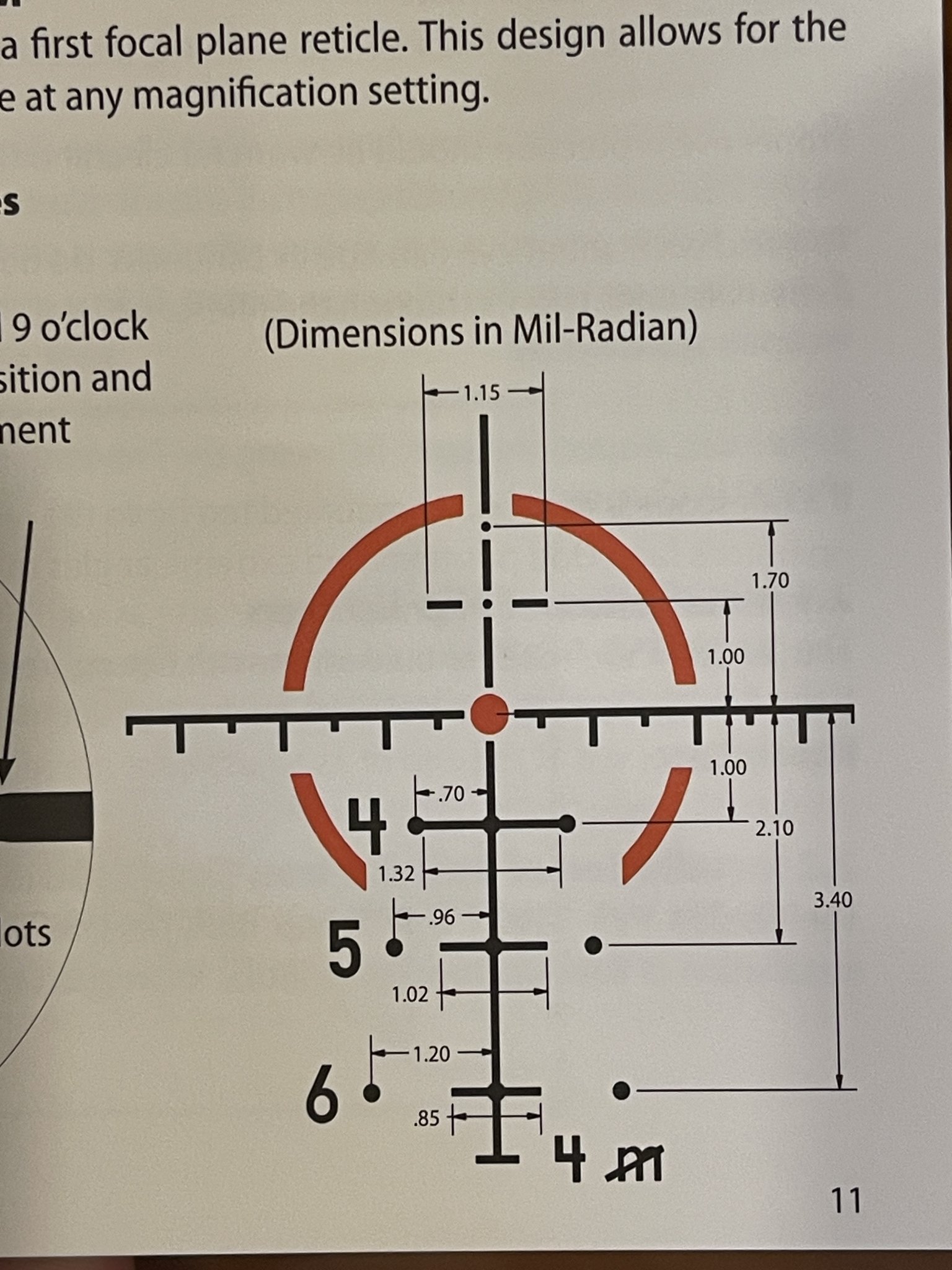

Ive been looking to see if there’s any documentation from NF or Horus as to what exactly the BDC holds are supposed to be for this optic. Can’t seem to find anything about it online.
I spoke with horus-they are not currently planning on updating their ballistic app with the tremor 8

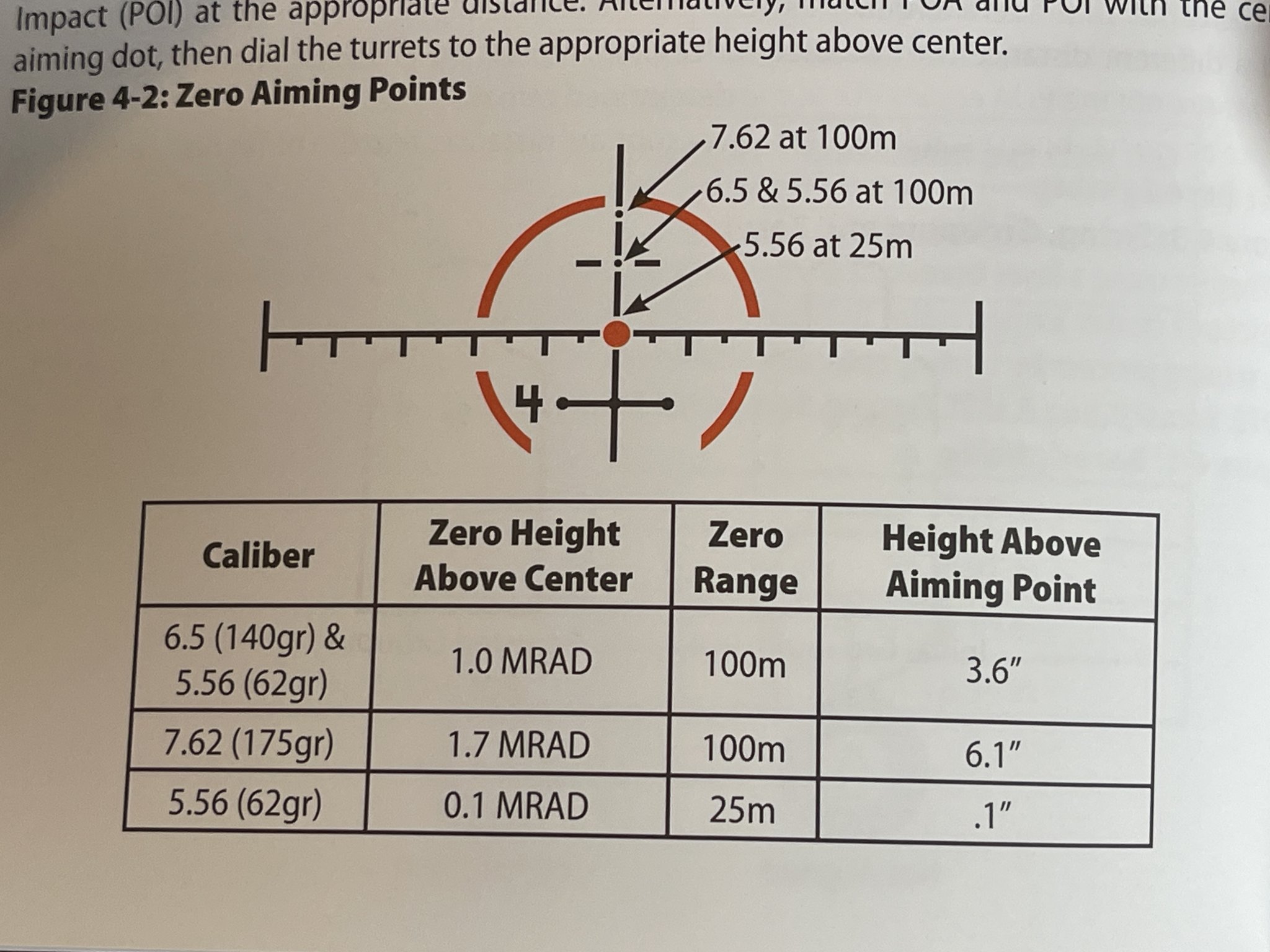

Load data
12.5 criterion core
Black hills 556 2650 mcv
fc-dmx
1.7 mount (2.94 HOB)
100y zero on the 1mil hold under dot(around 36y on center dot)
14.5 urgi
M855A1 2950 fps
1.54 mount (2.78 HOB)
tremor 8
Zeroed by manual
Dmx/t8 Mrad comparison
400y 1.3/1.0
500y 2.4/2.1
600 3.8/3.4

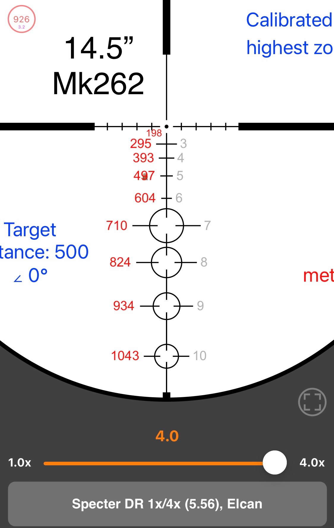

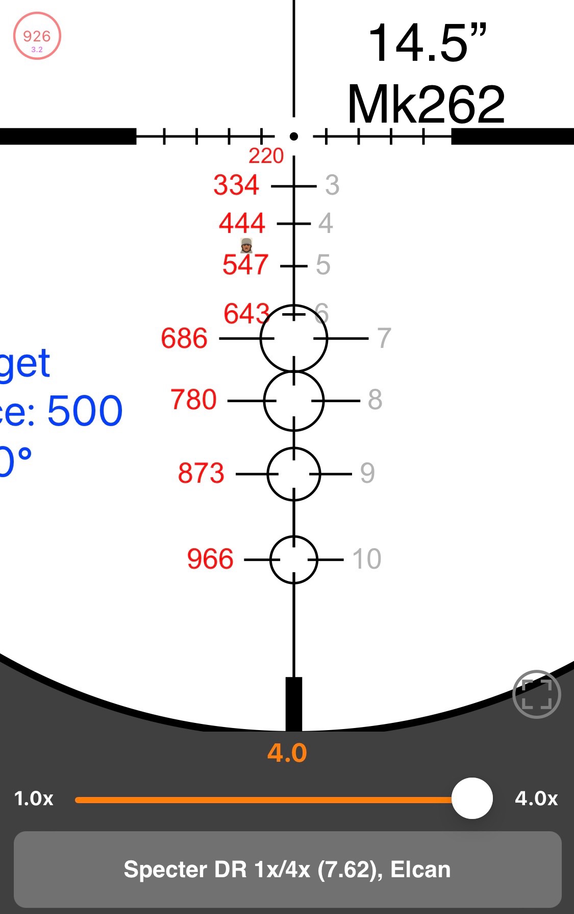

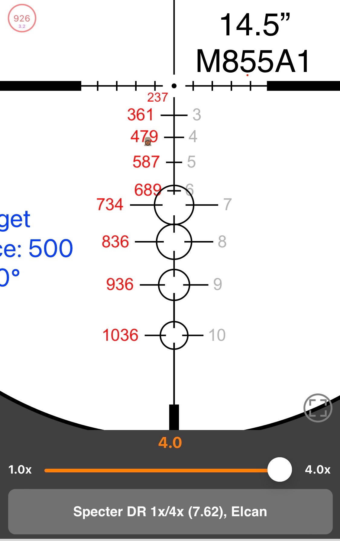

Eh, kinda works. It’ll get the job done, but the 5.56 reticles are better from a 14.5”. The 7.62 reticle works great on a Mk18 with Mk262 (maybe with M855A1, but I don’t have that MV data).
These are in meters with the 7.62 reticle
14.5” M855A1:
14.5” Mk262:
These are in meters with the 5.56 reticle
14.5” M855A1:
14.5” Mk262:

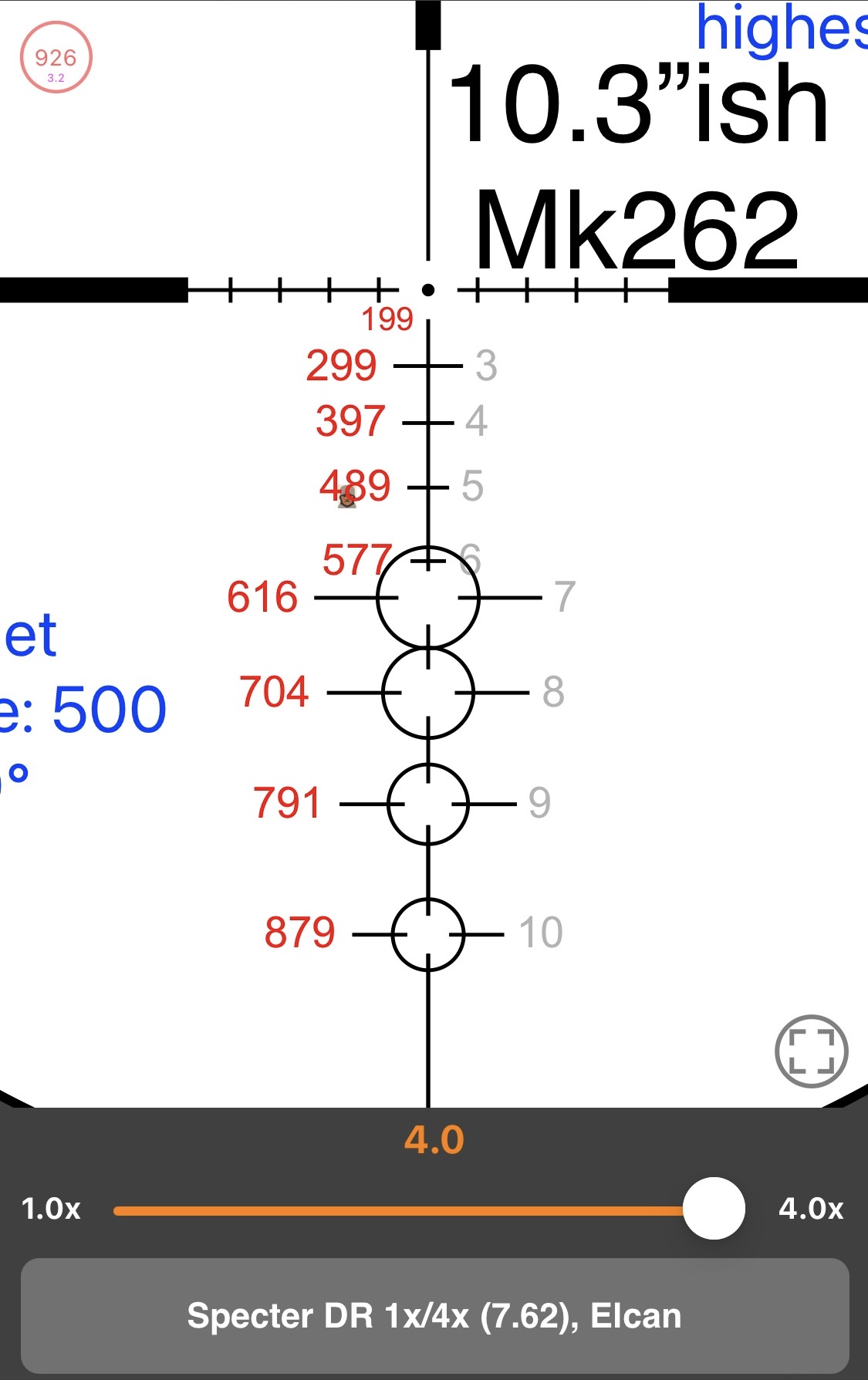

And then, the 7.62 reticle with Mk262 on a MK18:
The center isn't actually what's zeroed... It's the 100m hold under.
I understand that’s what is preferred, but if NF is highlighting the center dot is 25, that seems to indicate they realize soldiers are going to end up needing to zero at 25 when a 100 yard range isn’t available. Then, confirm zero at the 100 meter hold under when such a range is available.
The people who are issued these will always have the correct range to zero it. This reticle is very very particular and requires that. The 25m center can vary but the hold under cannot.
The 25m estimate is for a reference point for hob at 1x and close distances.
