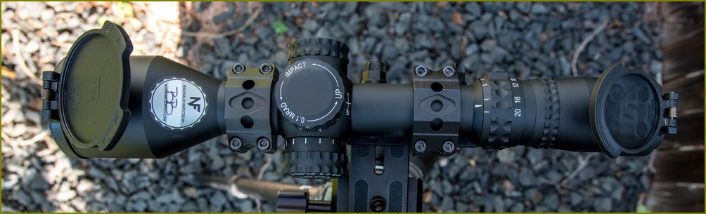

    Build Quality and Ergo
    The NX8 appears to have excellent build quality – without putting the scope through the wringer like underwater, freezing, etc. just the overall look and feel of the scope is well done. All finishes are nice and well executed. Some may balk at the 30mm tube but NF engineers were able to squeeze 32 mil of elevation which is more than some 34mm designs. However, it’s not all roses as the design of the NX8 pushes the turret housing forward which means there is very little room for a ring or mount between the turret housing and the front objective bell, this may make it more difficult on some rifle platforms to mount in the correct location. Nightforce also opted not to use a fast focus diopter which means there is lots of turning of the diopter to get it right (more on this later), but they did make the diopter locking which is a nice feature and I’ve also read the ATACR series suffers from a moving ocular when you adjust magnification which would definitely annoy me since I like to use caps. Speaking of caps, another nice feature in a $2k scope is the NX8 comes with NF branded Tenebraex caps, a very nice accessory to be included.

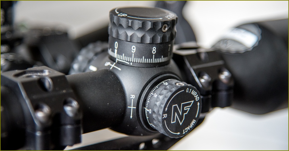

    Turrets
    Being my first Nightforce scope I did not know what to expect but based on rave reviews from other owners online I had the expectation that NF scopes excel optically and mechanically. My first experience with the turrets was a bit underwhelming to be honest. Compared to Minox ZP5, Kahles, Schmidt, Leupold Mark 5 and others, the NX8 turrets don’t have the snap I was expecting. Where other turrets have a distinct click or clunk between each .1 mil mark, the NX8 has a more muted sound and oddly enough, the windage turret has that more distinct click that I wish the elevation turret had. With most other scopes it’s the other way around, usually the elevation turret feels the best and the windage is lacking. But, “man does not live on clicks alone”, and while muted the NX8 turrets are precise with very little play and easy to dial elevation, in the end I do not think I would have a problem accurately dialing and the spacing of the 10 mil per rev turret is nicer compared to the tight spacing of the 15 mil per turn and greater variety found in other scopes. The windage is capped which is a very nice feature for those who don’t tend to dial wind and don’t want that turret getting bumped while moving around in the field.

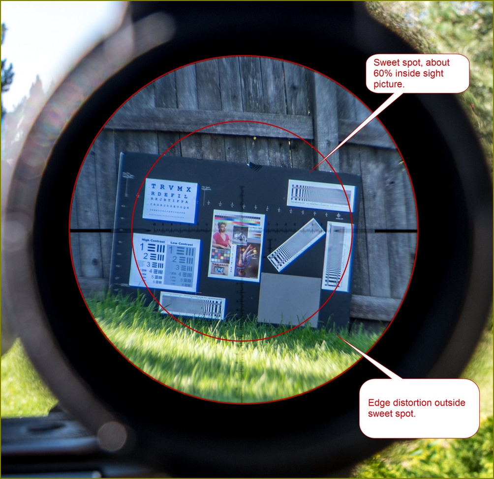

    Image Quality (IQ)
    I’m going to break down IQ into four categories – Contrast, Resolution, Color and CA
    Contrast
    The NX8 shows really good contrast when your eye is in center. The NX8 appears to be on par with the K318i within its sweet spot.​

    This is one area where I thought the NX8 was really going to struggle, but it was very difficult for me to induce any strong CA even in my test target with white on black, the NX8 handled CA exceedingly well. Compared to the Kahles, CA controlled appeared to be on par if not slightly better in some situations which is very impressive indeed as the K318i controls CA very well and only bested by the ZCO ZC420 in the ultra short category.​
    DISCLAIMER: DO NOT USE THE BELOW IMAGE TO JUDGE IQ, THE NX8 PERFORMED MUCH BETTER THAN THROUGH THE SCOPE IMAGES CAN CAPTURE.​
    EDIT 03/30/2022: The above image is representative of the original copy I had of this scope, I have since reviewed another copy of the scope which did not exhibit the edge distortion displayed above.

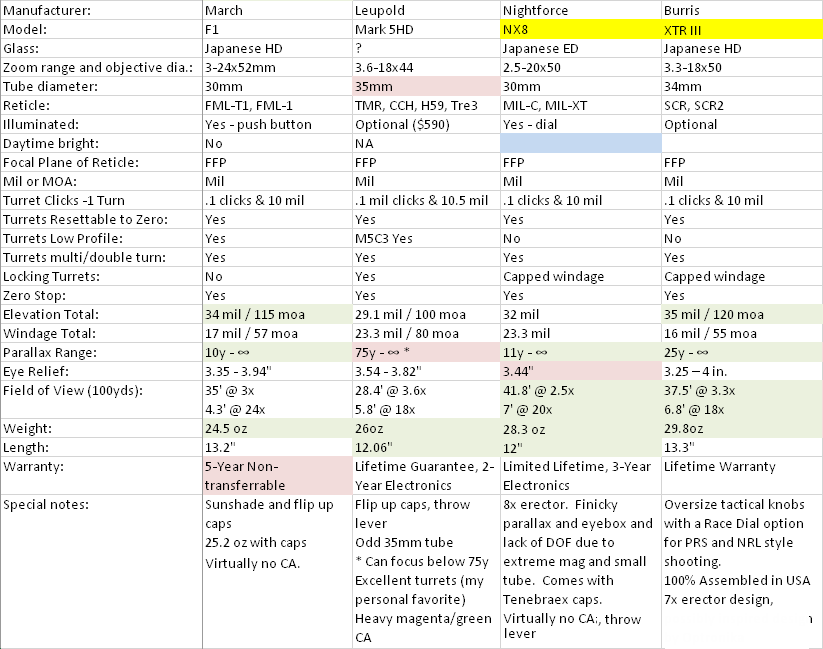

    Both the Leupold Mark 5HD 3.6-18x44 and the Burris XTR III 3.3-18x50 are going to be direct competition to the NX8 with regard to weight, size and price. The XTR III is an unknown at this time but early reports are promising so I'll just focus on the NX8 and the Mark 5HD as I had the Mark 5 last year and am familiar with it. Here is a bullet point list I made previously that might be helpful here:
    • Tube size: NX8 = 30mm | Mark 5 = 35mm: Advantage NX8 (more common)
    • Illumination: NX8 includes red/green illumination | Mark 5 charges premium for illumination: Advantage NX8
    • Turrets: NX8 has "soft" turrets | Mark 5 has distinct clicks with clever locking mechanism: Advantage Mark 5
    • Reticle: NX8 has Mil-C and Mil-XT | Mark 5 has old style TMR or Horus style: Advantage NX8 (personal preference)
    • Ergonomics: NX8 has narrow mount options | Mark 5 is shorter but limited mount options with 35mm tube: Tie
    • CA control: NX8 has minimal CA throughout mag range | Mark 5 has heavy CA: Advantage NX8
    • IQ: NX8 has edge distortion | Mark 5 struggles to deliver resolution *: Tie
    • DOF/Parallax: NX8 has narrow DOF and finicky parallax | Mark 5 has more forgiving DOF and parallax: Advantage Mark 5
    • Close Focus: NX8 can focus to 11 yards | Mark 5 can focus to about 50 yards: Advantage NX8
    • Low Light: NX8 has 50mm objective | Mark 5 has 44mm objective: Advantage NX8 (however, Mark 5 has excellent low light performance)
    • Magnification: NX8 is 2.5-20x50 | Mark 5 is 3.6-18x44: Advantage NX8
    • Warranty and CS: Nightforce has Lifetime with good CS | Leupold has Lifetime with questionable (of late) CS: Advantage Nightforce
    * My copy had issues with resolution; however, other reports have shown excellent resolution, this may be due to sample variance.
    Obviously the NX8 has more "advantages" above, but we all have our personal preferences and each shooter needs to decide for themselves what matters most and make your decisions accordingly. If you're more a turret guy then the Mark 5 has a definite advantage, but if you're more a reticle and illumination guy the NX8 is the way to go. Burris says around September for the 3.3-18x50 but only in non-illuminated version and I like illumination so will have to wait further, though glass should be the same in both, it will be interesting to see early reports. It is my desire to keep the NX8 around long enough to get the Burris XTR III 3.3-18x50 and do a comparative review between both, I will also be able to compare against the March 3-24x52 which I've had but it's been a while so it will be beneficial to have them side by side.
    Here's a quick comparison of specs between these scopes
