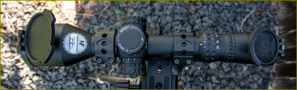

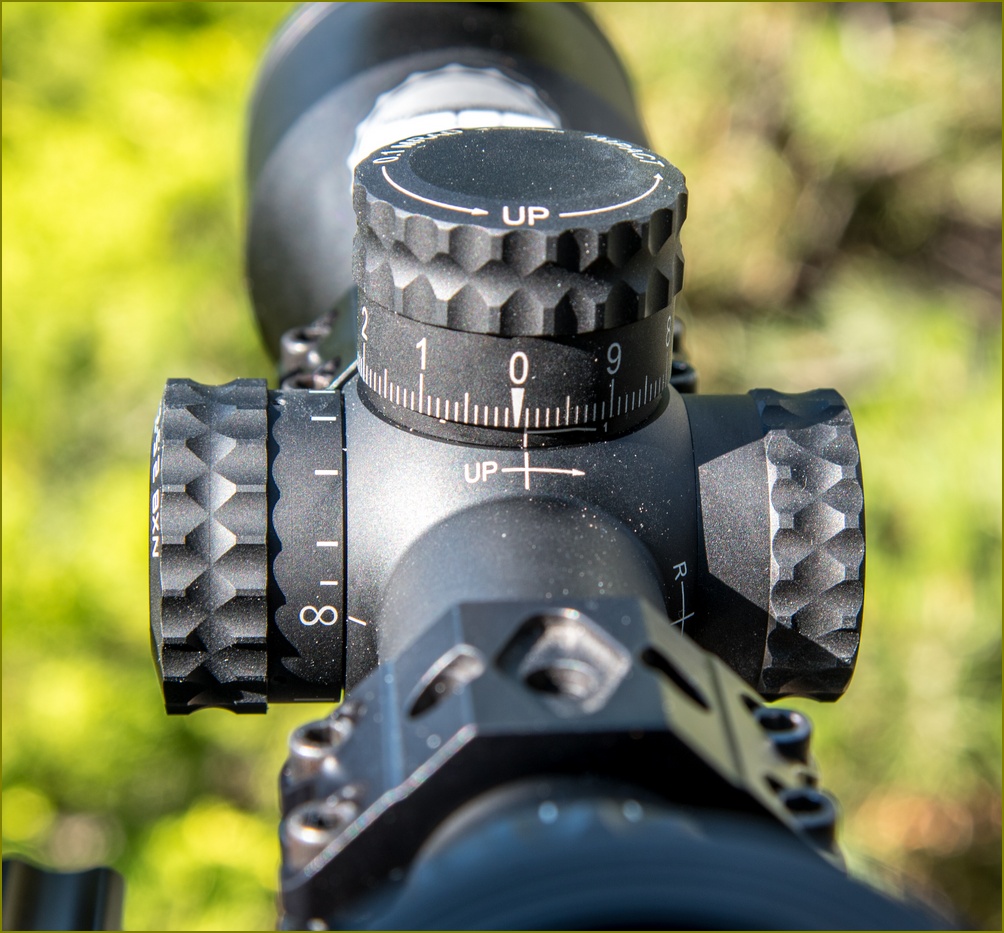

Backstory
When the Nightforce NX8 long range scopes were announced I raised an eyebrow. Over the years I’ve had or used many different long-range scopes from the budget category all the way into alpha class, but in all that time I have never owned a Nightforce and the reason is because they never made a scope that appealed to me. The ATACR F1 series was the first that really drew my attention, but the 5-25 is a hefty beast and has poor FOV performance at the low end. The 4-16x42 drew my attention but I rarely opt for scopes with objectives smaller than 50mm because most of my scopes get used in low light situations. I realize they recently came out with the F1 4-16x50 but this only happened after other manufacturers were already offering 3x/4x – 18x/20x and I prefer having more than 16x at the top end, if Nightforce had an ATACR F1 4-20x50 I’d be all over that. I think it's safe to say that nobody was expecting Nightforce to come out with this NX8 long range line and offer a 2.5-20 and 4-32 scope and certainly nobody was expecting these scopes to come in at the $2k price point. The Nightforce NX8 is using an 8x erector design in a short body similar to the March F series scopes. I’ve owned two of the March scopes in the past and their lackluster FML-1 reticle and finicky depth and parallax have always had me wanting more even though they impressed optically. So, the question that has been on my mind has been – where did NF compromise in order to build an 8x erector scope in a short body and sell it for $2k. I am already familiar with the compromises that March had to make with their design, but the March scopes also cost more than $3k if you want illumination. For the most part, online reviews of the NX8 have been nothing short of praising this scope for all it offers with no glaring compromises and I realized that in order to find out for myself I would have to purchase the scope and put it through some initial testing.

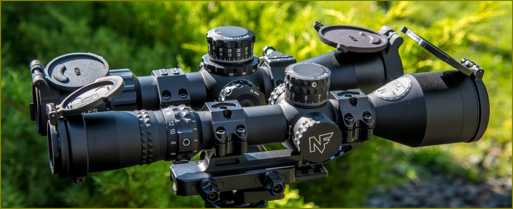

Build Quality and Ergo
The NX8 appears to have excellent build quality – without putting the scope through the wringer like underwater, freezing, etc. just the overall look and feel of the scope is well done. All finishes are nice and well executed. Some may balk at the 30mm tube but NF engineers were able to squeeze 32 mil of elevation which is more than some 34mm designs. However, it’s not all roses as the design of the NX8 pushes the turret housing forward which means there is very little room for a ring or mount between the turret housing and the front objective bell, this may make it more difficult on some rifle platforms to mount in the correct location. Nightforce also opted not to use a fast focus diopter which means there is lots of turning of the diopter to get it right (more on this later), but they did make the diopter locking which is a nice feature and I’ve also read the ATACR series suffers from a moving ocular when you adjust magnification which would definitely annoy me since I like to use caps. Speaking of caps, another nice feature in a $2k scope is the NX8 comes with NF branded Tenebraex caps, a very nice accessory to be included.

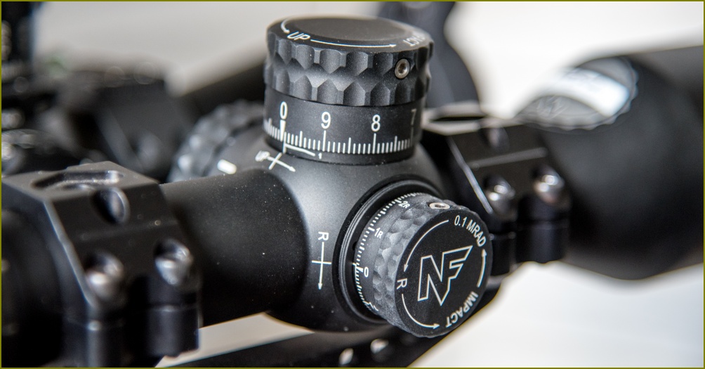

Turrets
Being my first Nightforce scope I did not know what to expect but based on rave reviews from other owners online I had the expectation that NF scopes excel optically and mechanically. My first experience with the turrets was a bit underwhelming to be honest. Compared to Minox ZP5, Kahles, Schmidt, Leupold Mark 5 and others, the NX8 turrets don’t have the snap I was expecting. Where other turrets have a distinct click or clunk between each .1 mil mark, the NX8 has a more muted sound and oddly enough, the windage turret has that more distinct click that I wish the elevation turret had. With most other scopes it’s the other way around, usually the elevation turret feels the best and the windage is lacking. But, “man does not live on clicks alone”, and while muted the NX8 turrets are precise with very little play and easy to dial elevation, in the end I do not think I would have a problem accurately dialing and the spacing of the 10 mil per rev turret is nicer compared to the tight spacing of the 15 mil per turn and greater variety found in other scopes. The windage is capped which is a very nice feature for those who don’t tend to dial wind and don’t want that turret getting bumped while moving around in the field.

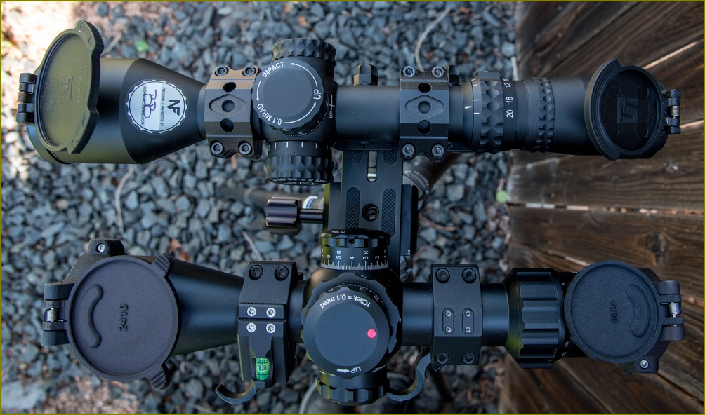

Conclusion
Putting an 8x erector into a short body has its limitations and NF engineers were not able to overcome those limitations (at least for the price point they are selling at). The narrow depth of field and heavy edge distortion of the image especially at lower magnifications along with the finicky parallax has me still wanting for more from the NX8. While I like the Mil-C reticle mag range and illumination, there are just too many other drawbacks for me with the NX8 personally. It’s too bad because I really wanted this scope to exceed my expectations and while it has in some areas, it has not in others. I am sure there will be plenty of shooters who are not bothered by these shortcomings and will be quite pleased with this scope.
Other $2k class scopes I have used would be the Leupold Mark 5HD 3.6-18x44 which had much better turrets and DOF/Parallax; however, my copy did not do that great in overall IQ and the sweet spot of the NF NX8 was quite a bit better than the Leupold. I've had the Steiner T5Xi's and their CA was so bad they were immediately returned. The Bushnell LRTS 4.5-18x44 and Tract Toric 4-20x50 are lower priced but suffer from heavy CA; however, the do have impressive IQ for the price. At a little higher price point the Vortex AMG 6-24x50 is a better all around scope (overall IQ, turrets). But none of these scopes offer an 8x erector inside a short body, so in reality Nightforce has no competition from any scope at this price point.
I realize there are many who will not “see” the same issues that I see and will claim their version has no edge distortion or is not finicky with DOF or parallax, etc., I am simply pointing out issues that I see based on my experience with lesser and better optics. There are compromises with most every optic and we all have personal preferences when it comes to some of these features. I think for many, the Nightforce NX8 2.5-20x50 will be a favorite, it certainly fills a niche we have not seen before at this price, kudos to NF for being bold enough to bring something like this to market.
