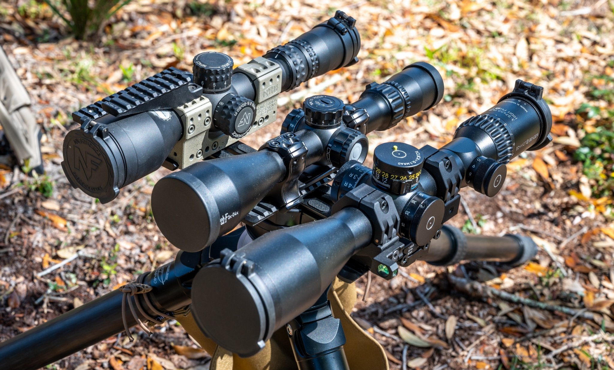

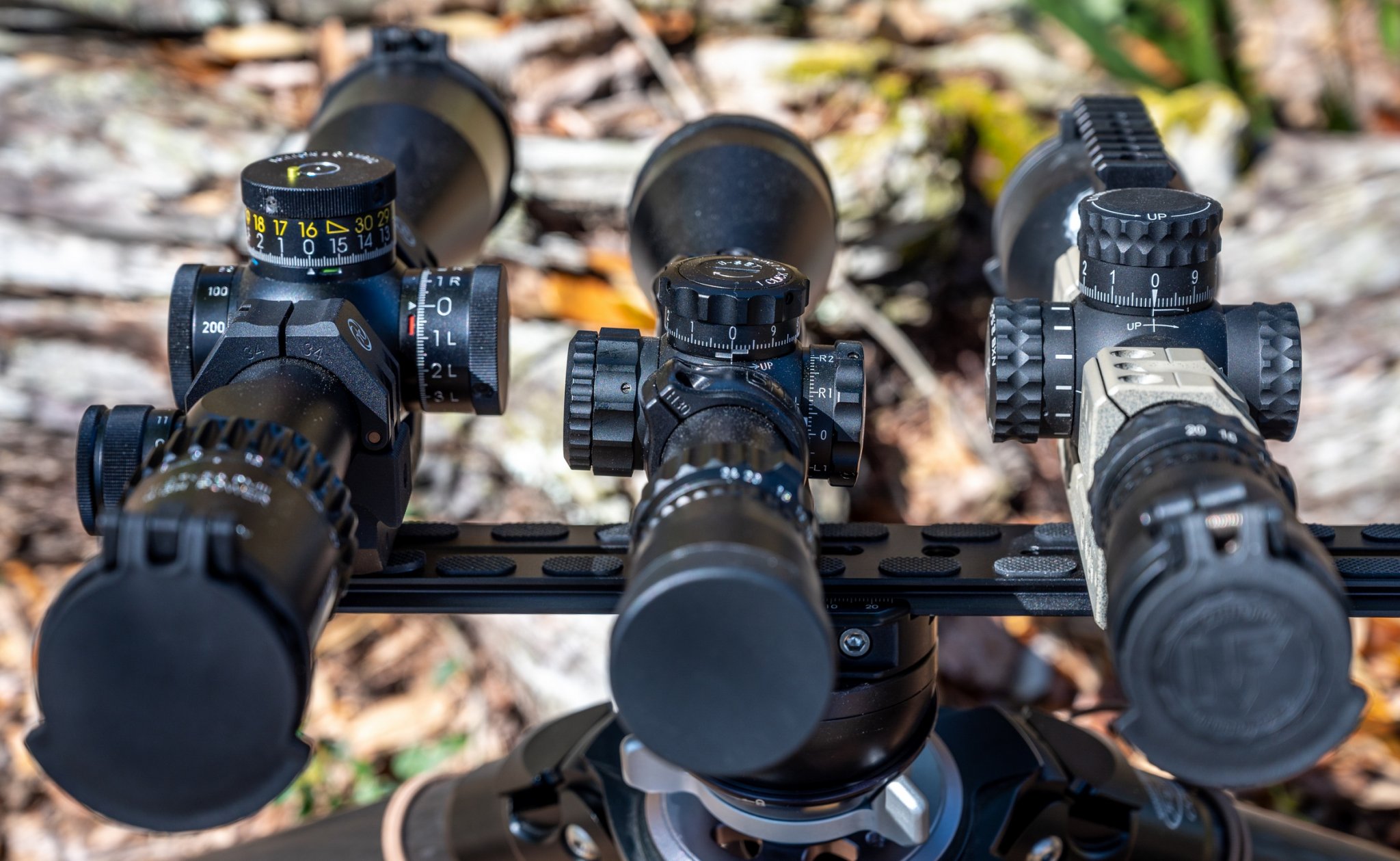

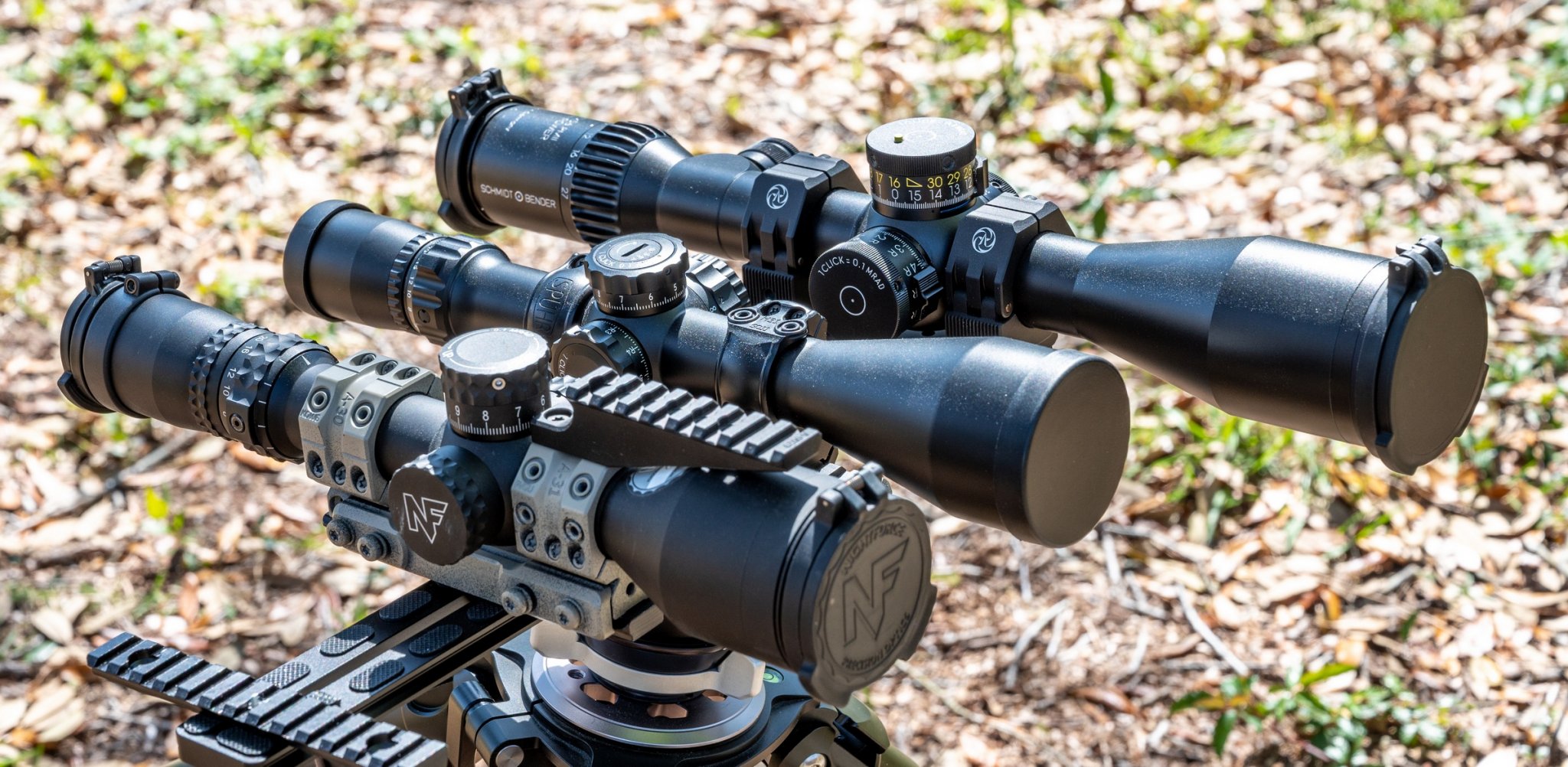

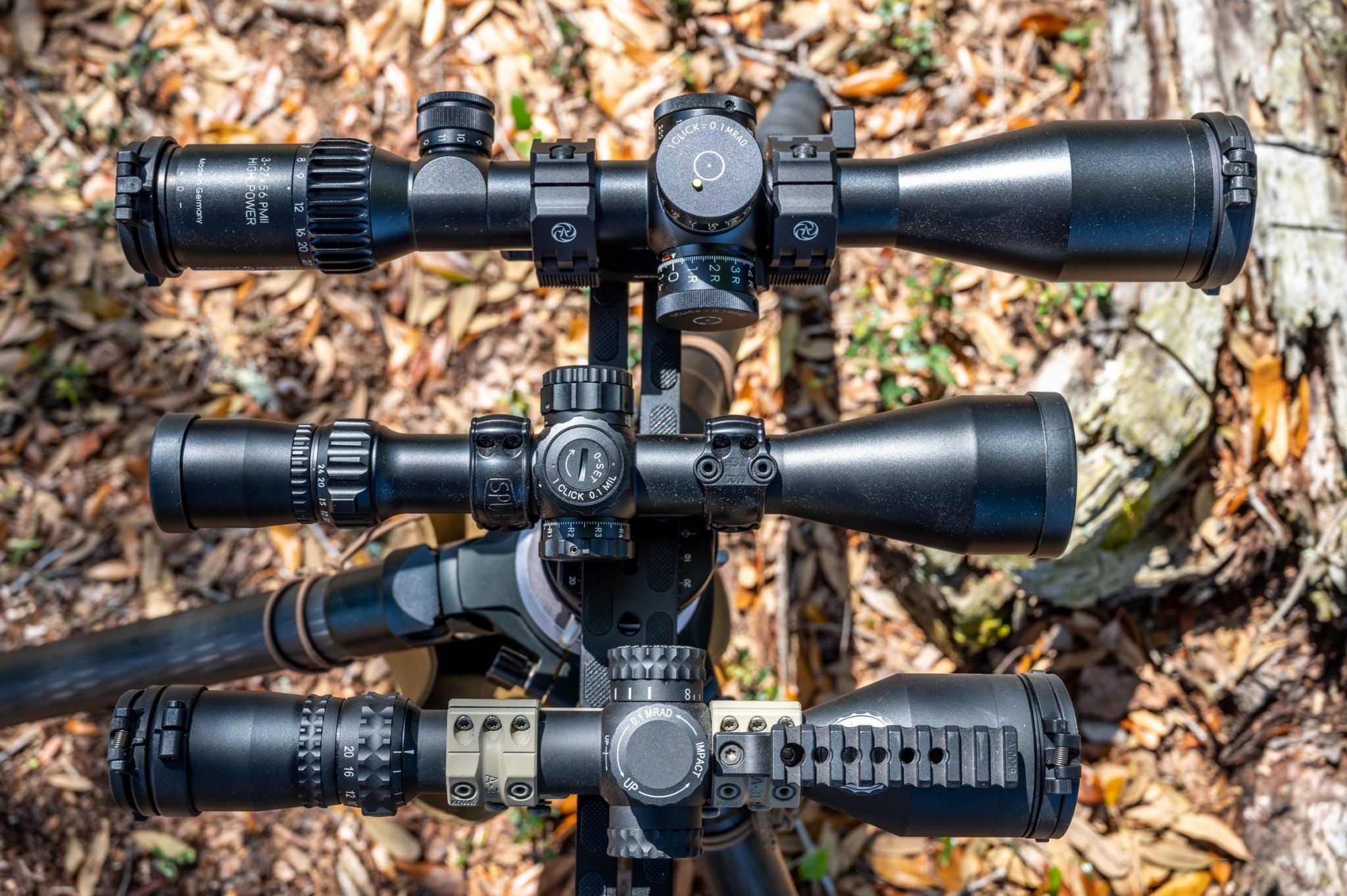

    THE SCOPES​
    Nightforce NX8 2.5-20x50, March 3-24x52, Schmidt 3-27x56
    The reason I chose these three is because they represent the most common high magnification mid-range optics on the market today that start at 3x or less and extend to 20x and beyond. With Schmidt’s latest US pricing, the 3-27x56 is at near unobtanium levels while the March has been out a number of years and can be had for just under $3k price and the NF NX8 represents the “budget” class at just under $2k. The Schmidt has a 34mm tube while the March and Nightforce come in with the skinnier 30mm tube.

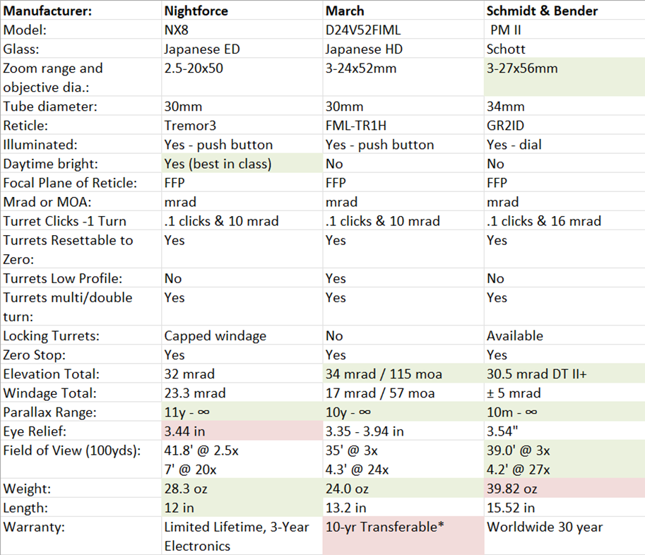

    SPECS​
    The below specs are provided by the manufacturers which provides a good baseline for what these scopes offer. Highlighted in red is a potential drawback and in green is a potential benefit.
    TURRETS​
    This review does not cover the accuracy of each scope but covers the functionality – since any manufacturer is capable of producing a lemon it’s always a good idea to test your scope to ensure its mechanical accuracy.

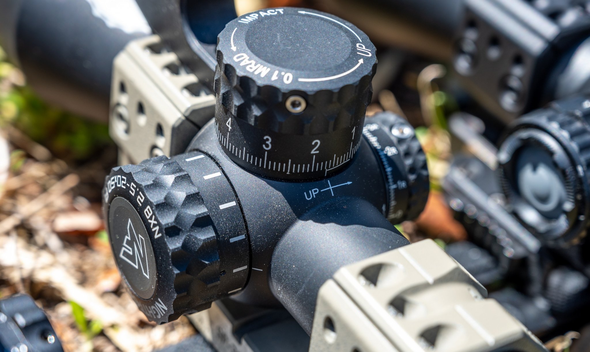

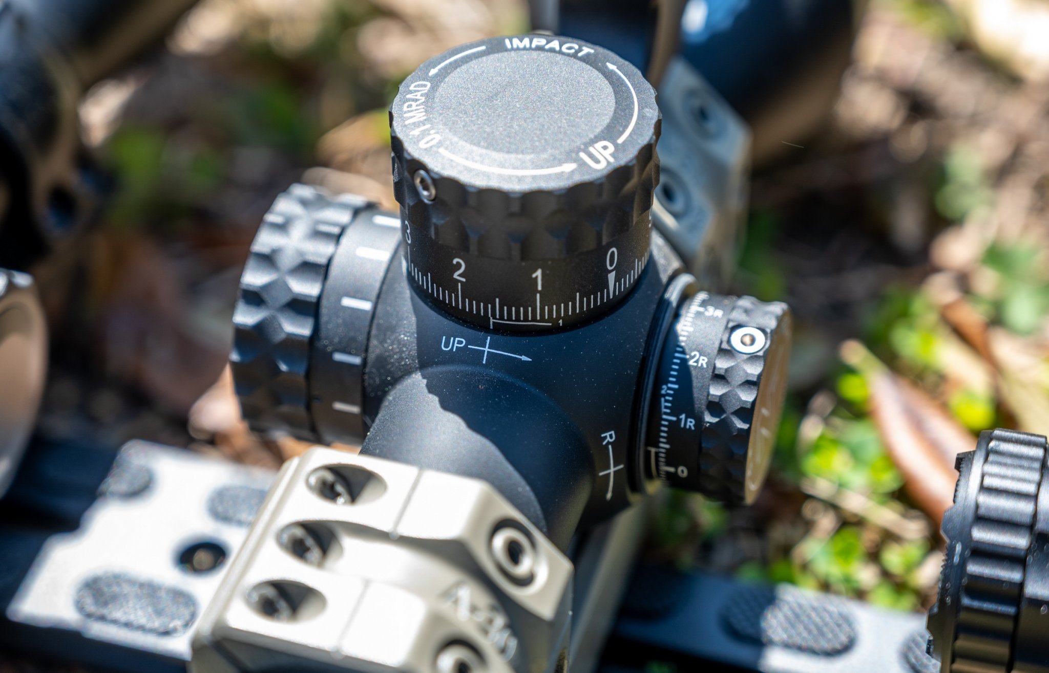

    Nightforce NX8 2.5-20​
    I wrote the following in my previous review and will repeat it here because turret feel and functionality appears to be mostly the same between new and old: Compared to Minox ZP5, Kahles, Schmidt, Leupold Mark 5 and others, the NX8 turrets don’t have the snap I was expecting. Where other turrets have a distinct click or clunk between each .1 mil mark, the NX8 has a more muted sound and oddly enough, the windage turret has that more distinct click that I wish the elevation turret had. With most other scopes it’s the other way around, usually the elevation turret feels the best and the windage is lacking. But, “man does not live on clicks alone”, and while muted the NX8 turrets are precise with very little play and easy to dial elevation, in the end I do not think I would have a problem accurately dialing and the spacing of the 10 mil per rev turret is nicer compared to the tight spacing of the 15 mil per turn and greater variety found in other scopes. The windage is capped which is a very nice feature for those who don’t tend to dial wind and don’t want that turret getting bumped while moving around in the field. Turrets are translating which means the turret rises and lowers when spinning through the different revolutions.

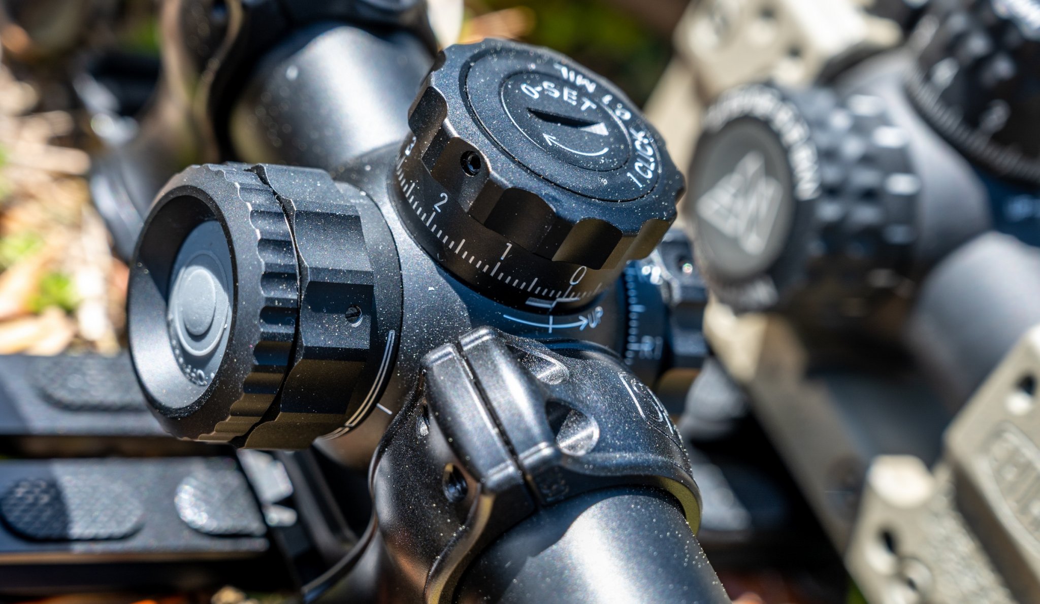

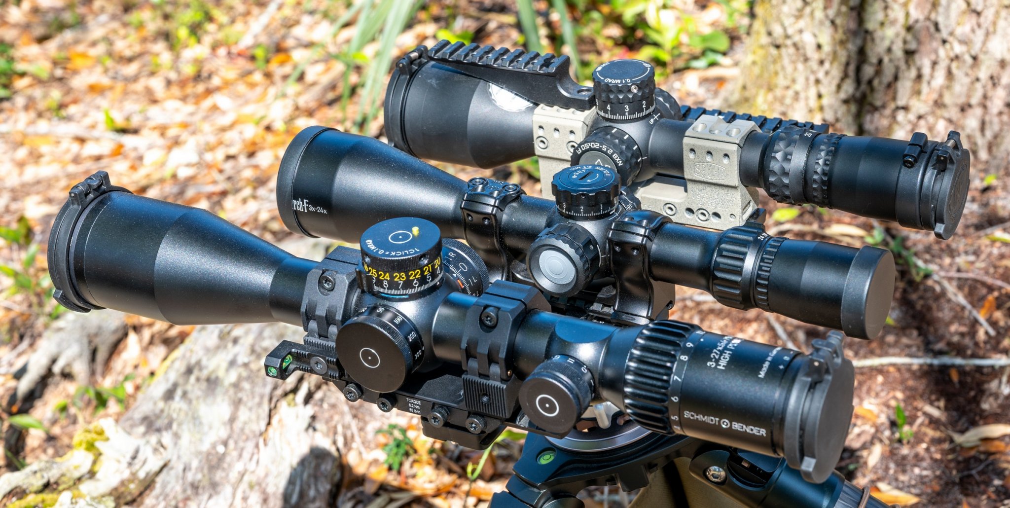

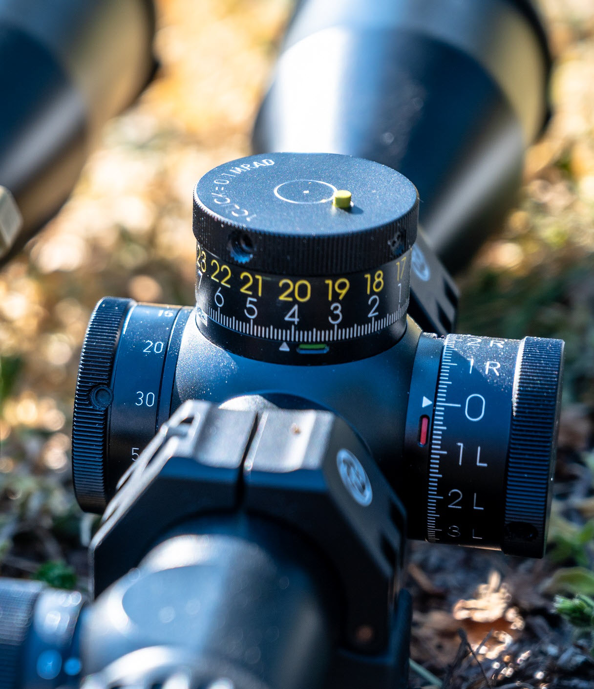

    Schmidt PM II 3-27 DT II+ turrets​

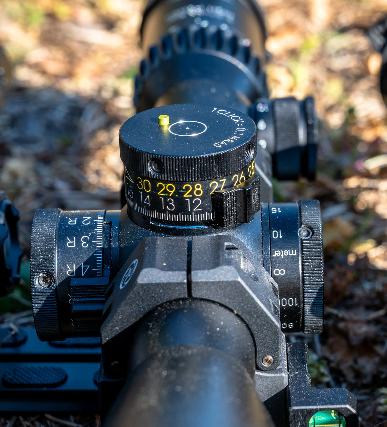

    These turrets are completely different from the traditional design Schmidt has offered in the past, they are somewhat lower profiled and a bit larger in diameter, but the main difference is in how they function. These turrets have a very solid and distinct click value with minimal play between clicks – Schmidt engineers did their homework on this one. Turrets are non-translating which means the turret does not rise or fall when spinning through the different revolutions. The added benefit of the DT II+ system is you have a lever for both elevation and windage that allows 3 settings: Locked, Unlocked with MTC and Unlocked without MTC (for those who may not know, MTC stands for More Tactile Clicks which means every full mrad value the click is stiffer than the rest providing a “more tactile” response). When in the locked position there is no play or movement in the turret. It should be noted that I had issue with previous generation MTC turrets, the full mil stronger click was so strong it would cause me to inadvertently overtravel by .1-.2 clicks coming out or going back (for example: if I had a solution of 5.1 mils I would overtravel to 5.2 or 5.3 and would then have to dial back causing delay) the DT II+ MTC has rectified that and feels like the ideal resistance without having to jump forward to get out of the full mrad value. The Schmidt turrets are non-translating which means the turret does not rise or fall when spinning through the different revolutions. I would rate these turrets as the best yet from Schmidt and Bender and arguably close to Tangent Theta in quality.
    Turret Mechanical Assessment criteria (ratings: = (equals) > (greater than) ranked highest to lowest):​
    Turret Click Spacing Ranking:​
    March 3-24x52 >= SB DT II+ > Nightforce NX8
    My rankings for turret click spacing have to do with both the distance between clicks and the resistance between those clicks. This is more or less a personal preference, but my hand feels better with wider spacing and good resistance but not too much. While the NX8 had better spacing, the mushy feel brought the rank down.
    Turret Click Feel Ranking:​
    SB DT II+ > March 3-24x52 > Nightforce NX8
    This can be very subjective, but I am drawn to more distinct click feel and audible feedback with very little play between marks.
    Turret Alignment Ranking:​
    SB DT II+ > March 3-24x52 = Nightforce NX8
    I define turret alignment by the ability for the turret hash marks to fall directly on the indicator mark and not being offset while running the turret out to the extreme and back. Because of the nature of translating designs, they do rise pretty high above the center mark which gives a slight perception you are off mark if your eye is not perfectly centered. I much prefer the non-translating designs that do not rise and fall so preference is given for these designs.
    Turret Reset Zero and Zero Stop Ranking:​
    In order to reset zero on the March, Schmidt and Nightforce scopes you have to loosen the side hex bolts on the turret housing, then spin the turret to align zero and re-tighten, this is typical of most long range scopes today (zero stop on S&B is around 0.6 mrad below, March allows you to set where you want it with a coin, NF has a rather lengthy but somewhat easy process to set using external and internal hex nuts).
    Total Travel Adjustment (Elevation) Ranking:​
    March 3-24x52 34 mrad > Nightforce NX8 32 mrad > SB DT II+ 30.5 mrad
    Pretty self explanatory. There is variation of windage adjustment but as I almost exclusively hold wind with the reticle, this does not play a factor for me and therefore is not evaluated (however, the spec sheet above shows the exact amount for each scope for those who are interested).
    Turret Locking Mechanism Ranking:​
    Schmidt DT II+ > Nightforce NX8 – NA = March 3-24x52 - NA
    The Schmidt DT II+ locking mechanism is one of the best I’ve seen as it allows you to turn the locking feature on or off with a mechanical lever separate from the turret housing itself; whereas, neither the March 3-24 or the Nightforce NX8 offer a locking feature, although the NX8 does have a capped windage turret which gives it a slightly higher rank.

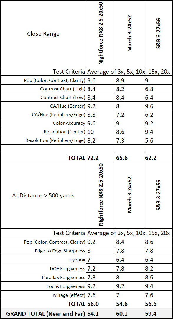

    Optical quality Test Results (higher numbers are better)​
    Testing at comparable magnification is tricky since the way magnification rings are marked is not reliable.

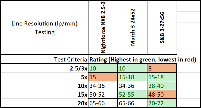

    Resolution Line Chart (LPI)
    It’s one thing for me to look through a scope and judge resolution based on a 1-10 ranking, but it’s quite another to look at line charts and determine how many lines I’m able to resolve at a given magnification, my resolution testing above is a good “first impression” but the line chart does not lie and provides a more quantitative result. For most results you’ll see a range – it is hard to resolve exact values with your eye and I would try to narrow it down as best I could but sometimes eye strain, perfect alignment, etc. would get in the way.
    Overall Optical Assessment Results:​
    Nightforce NX8 > March 3-24x52 > Schmidt 3-27
    If this was based on the first Nightforce NX8 2.5-20x50 I received right after release of the model I can just about guarantee the NF would have come in last in almost every category, but NF has done a lot in the years since initial release to rectify a lot of the optical issues, so much so that I now recommend this scope to those looking for a well rounded 8x scope. I was as surprised as I imagine some of you are with my results, how can the $5500 Schmidt 3-27x56 rank last in this category and the reason is that Schmidt tried to do “too much” with the design; however, in their defense they designed this scope for a military customer that required the extreme mag range and given the huge range it covers the overall quality of the scope is impressive. The March 3-24x52 really struggles above 18x, so much so that I typically tell potential buyers that it makes for a really nice 3-20 option, but there is so much optical distortion and CA above 20x that I really don’t feel it is very usable, some may disagree but I’ve had several copies of the 3-24x52 now and they all exhibit similar characteristics. I would love to see March give this design a fresh upgrade and see if they can’t improve upon optical performance along with a wide angle eyepiece like the 4.5-28x52; where the March excels is in the lower magnification range and combined with the FML-TR1H reticle, if that’s where you intend to spend most of your time then March comes out #1.

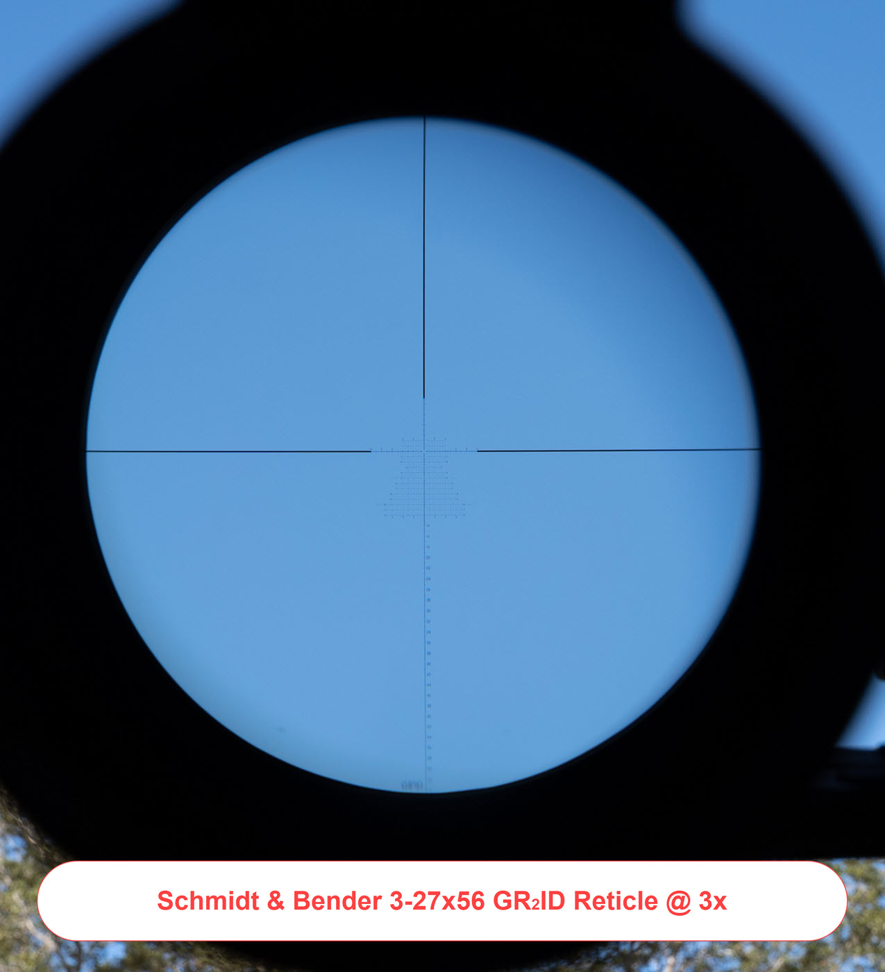

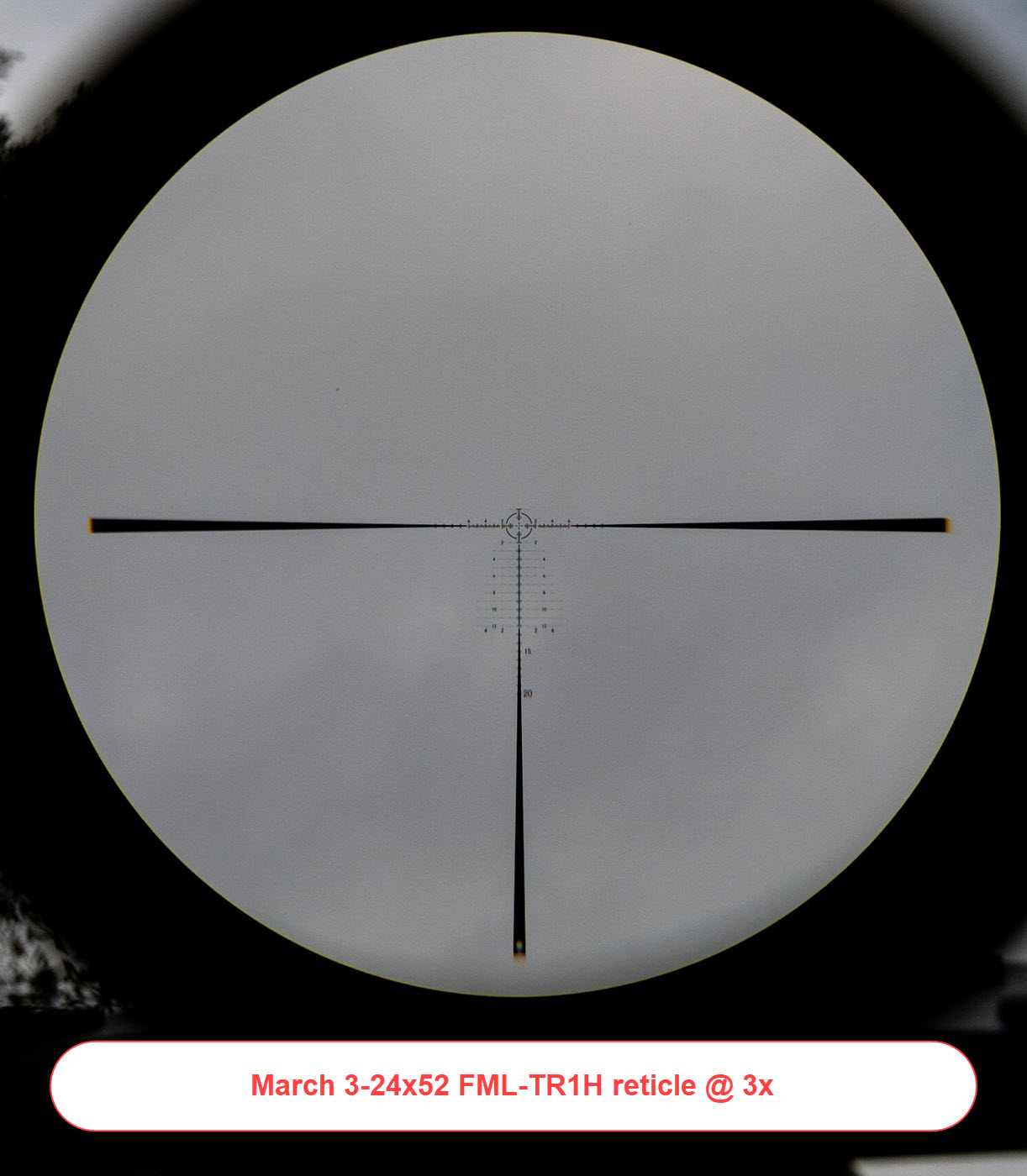

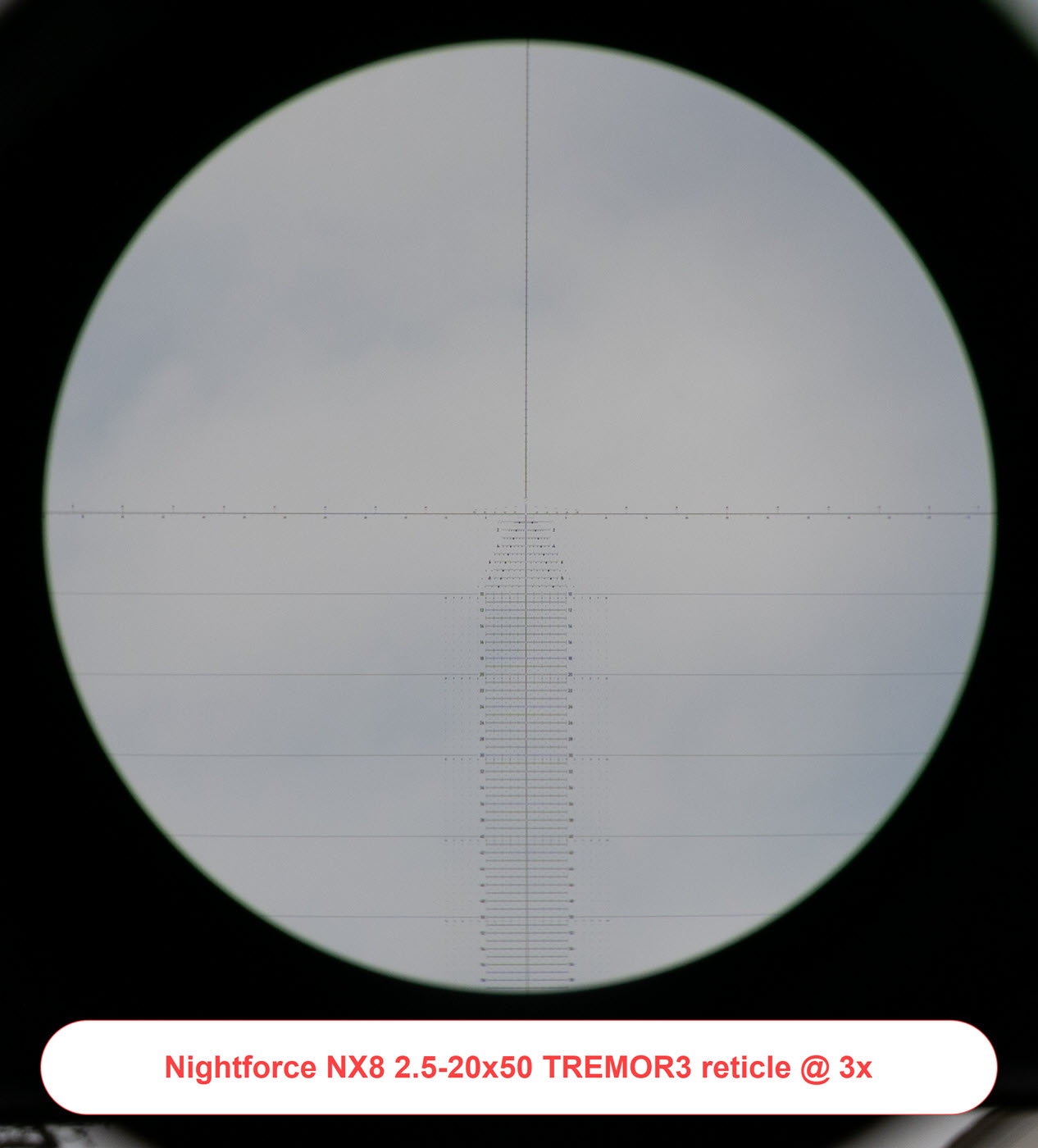

    While I am not reviewing reticles here, it is worth mentioning that the March now offers the FML-TR1H reticle in the 3-24x52, this is essentially the same FML-TR1 used in the 4.5-28x52 and 5-42x56 scopes but with an aiming enhancement quadrant (similar to an LPVO) for use at low magnification. Neither the Schmidt nor the Nightforce offer anything like this. IMO, this innovative reticle really makes the March worth considering if you feel you are going to have close range opportunities with this scope.
    Do not use these images to judge optical quality, they are for reticle reference only. Here are the Schmidt and Nightforce reticles at 3x, neither of which were usable at 3x as they quickly got obscured by almost any background:

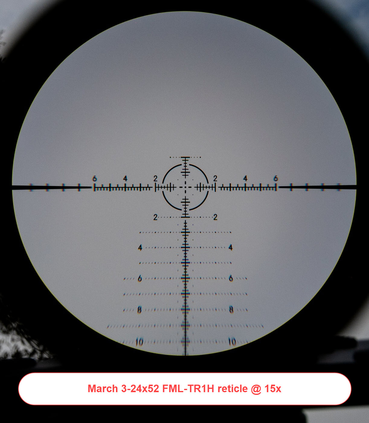

    Here is the March FML-TR1H at 3x, even without illumination this reticle is easy to pickup even on busy backgrounds, I would like more manufacturers to adopt this idea from the LPVO market into the MPVO market, while I do not consider these scopes as true MPVO the NF NX8 does come close at 2.5x on the bottom.
    Here is the March FML-TR1H at 15x which is what I consider the sweet spot for this scope. Ignore the distortion you see in the reticle below 4 mils, that was my inability to perfectly align my camera with the focal plan of the scope.

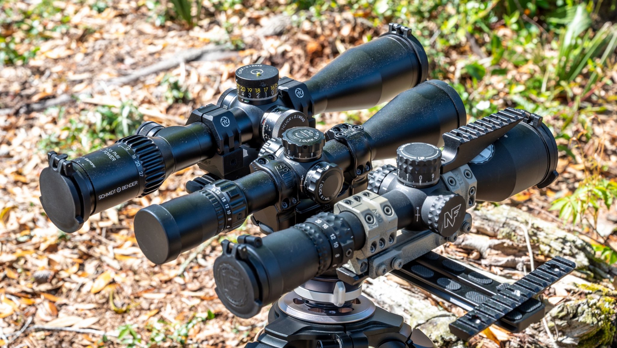

    So here is my personal opinion on each of these scopes
    • Nightforce NX8 2.5-20x50: If you need a short-bodied scope that has class leading FOV with impressive IQ then this scope is a very compelling option I just wish they offered a better reticle – I would love to see the FC-DMx reticle for this scope. DOF and Parallax can be somewhat finicky and edge to edge sharpness is dependent on eye position indicating that eyebox is a bit finicky as well, but this newest scope faired better in this department than the early release model had.
    • March 3-24x52: Decent optical performance with really good turrets but have a hard time recommending it for anyone wishing to use above 20x. 3x and 15x seem to be this scopes sweet spot. But where the March lacks in optical performance it makes up with one of the lightest scopes in its class and with the FML-TR1H reticle makes for a very compelling DMR and crossover/hunter platform. Similar to the NF NX8 this scope is somewhat finicky with DOF and parallax but not too bad, eyebox gets really tight above 18x and CA and optical distortion are a hindrance beyond 18x as well.
    • Schmidt & Bender PMII 3-27x56: A high price to pay for a massive magnification range, one must ask yourself if you really need 3x at bottom do you really need 27x at top? This scope is a good example of trying to do too much so don’t expect it to compete optically with the best of the best (like TT, ZCO or even Schmidt's 5-25), that said, if you need the huge range you’ll appreciate all this scope has to offer. But the scope is a beast and if you’re limited with rail for clip-ons you may find the two other scopes in this review to be more enticing. This Schmidt has a very thick periphery which can be somewhat distracting but the sight picture is excellent. There was slight focus shift at 20x and parallax forgiveness quickly fell off above 10x. IQ distortion at periphery from 3-9x is a bit distracting, this scope seems designed for performance above 20x where it excels. This particular scope struggled more with flare than the others.
    So there you have it, for those interested in extreme magnification it is clear that you are "giving up" some optical performance so you have to determine whether the "juice is worth the squeeze" and for the price you pay on these scopes you may be better served by some of the lesser erector scopes that cover almost as much range but offer better overall optical performance. That being said there are many satisfied owners of each of these scopes using them effectively in the field.
    Overall Turret Mechanical Assessment Ranking:​
    Schmidt DT II+ > March 3-24x52 > Nightforce NX8
    I’d like to reiterate that my rankings are biased towards features, feel and functionality that I prefer so please keep this in mind – where I prefer more distinct sounding clicks you may prefer more muted clicks and would therefore rank other scopes in almost the opposite order in which I have.
    MECHANICAL ASSESSMENT OF MOVING PARTS​
    Besides the turrets you have other moving parts on a scope: the magnification ring, the parallax adjustment and an illumination module, which all require some type of adjustment. Sometimes manufacturers make the resistance too hard or too light. These parts are evaluated based on “resistance” which allows them to turn freely with two fingers, but not so loose that they could get bumped out of position accidentally. In addition, if resistance is so high that turning a dial would cause POA to shift - this would be considered a negative.
    Mag Ring, Parallax, Diopter and Illumination Mechanical Assessment criteria (ratings: = (equals) > (greater than) ranked highest to lowest):
    Magnification Ring Movement Ranking:​
    Schmidt 3-27 >= March 3-24x52 = Nightforce NX8
    The ideal magnification ring resistance (IMHO) is one that can easily be turned with two fingers – not so hard to turn as it may now affect your POA and not so light that a brush of your hand (or light bump into a barricade, branch, etc.) is going to change the setting. The S&B 3-27 exhibited excellent resistance and smoothness. The March and Nightforce NX8 had really good resistance and sufficiently smooth.
    Parallax knob Movement Ranking:​
    Nightforce NX8 = March 3-24x52 = Schmidt 3-27
    The parallax on the March, Nightforce and Schmidt scopes were all outstanding offering what I’d consider the right amount of resistance while being very smooth.
    Parallax Adjustment Forgiveness:​
    What exactly is parallax “forgiveness”? I define this as how finicky it is to adjust the parallax dial in order to get parallax properly set for the distance to target from the scope, keep in mind that the parallax dial is doing two things: 1) focus the image and 2) correct for parallax misalignment which can cause you to miss a target at distance, keep in mind that with some scopes the two are not always the same, meaning that when you adjust the dial to ideal focus you may still notice some parallax misalignment and vice versa if you adjust for perfect parallax correction the image may be slightly out of focus (sometimes finetuning the parallax can assist). These are all high magnification scopes with the Nightforce NX8 and March boasting an 8x erector and being relatively finicky throughout the range while the Schmidt 3-27 with it’s 9x erector appeared to be more finicky above 10x. Due to the nature of the design of these scopes you are going to have to fiddle with the parallax knob more than you would 4x, 5x and even 6x erector designs.
    Diopter Adjustment Rankings:​
    Schmidt 3-27 >= March 3-24x52 > Nightforce NX8
    The Schmidt and March offer a “fast focus” diopter allowing for quick adjustments with a lock ring to help against slippage but it’s wise to use some kind of semi-permanent marker to mark the ideal setting for your eye. If you have not seen my PSA on setting up your diopter, it is attached (though I’d also recommend you check out ILya’s video which goes into greater detail), so you can look at the process to better set your diopter for your eyes (if you are used to the blank wall or blue sky method only you may be missing out on maximum performance of your scope).
    Illumination Dial Performance Rankings:​
    Nightforce NX8 > Schmidt 3-27 >= March 3-24x52
    There is no question that Nightforce offers the widest range of features with illumination – you have the ability to select between red and, the only downside is the push button feature instead of a dial and no auto-shutoff. There seems to be a love or hate relationship with Schmidt and Bender’s illumination tumor, but the rheostat function is very smooth – no auto-shutoff. March is using a rubber cover over a push button for on/off functionality with presses between settings similar to NF. March has an automatic shutoff after one hour from being turned on which will help save battery (I have often left illumination on and forgot to turn off only to find my next outing there is a dead battery).
    Illumination Daylight Bright, Coverage and Bleed:​
    Nightforce NX8 >> March 3-24x52 > Schmidt 3-27
    Nightforce DigIllum has one of the brightest reticles on the market and is what I consider to be daylight bright (keep in mind I’m not talking Aimpoint or other RDS bright) for a long-range scope which is to say it can be seen in bright midday sun, the entire reticle lights up and there is no discernable bleed even at highest brightness in low light (the only other reticles I know of that come this close are the ZCO and Zeiss LRP S5, maybe the new Vortex G3 6-36). The Schmidt 3-27 and March 3-24 comes in at a very distant second and was ever so faint in daylight and barely visible in shadow, only center cross lit up on the Schmidt while March lights up center and the quadrant, bleed was minimal on both.
    Overall Mag Ring, Parallax, Diopter and Illumination Mechanical Assessment Rankings:​
    Schmidt 3-27 > Nightforce NX8 > March 3-24x52
    When including everything above, it’s pretty close between them all as they all have some features that are slightly better than others, if illumination is your game the NF NX8 is clearly head and shoulders above while the overall features of the Schmidt seem to be more refined than the others while the March does most things well. Again, take my rankings with a grain of salt because they are based on “my” preferences for the most part.

    How do you think the new FML-TR1H reticle in the March compares with the old FML-1 ?
    Obviously the new one has a tree and is more practical, but the pictures on 3x seem to indicate the older reticle is more visible at lower magnification.
    Is that the case when looking through these in person?
    Well I never had the scopes side by side, but the FML-1 was a super thick reticle that worked pretty good at 3x, if you don't mind how thick it is at higher mags then that could be an option. The FML-TR1H blends the best of both worlds, usable at 3x without being obnoxiously thick above 15x... my 2¢
