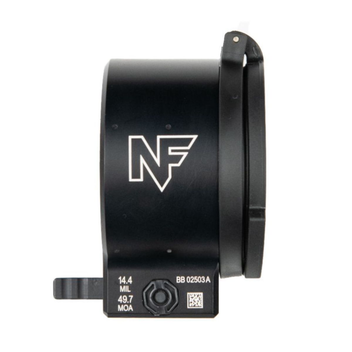

    I saw this at SHOT 2 years ago, this was behind the scenes and was something I referred too as a winner
    As Nightforce fans continue to push the boundaries of what is possible for target distances, some riflescopes lack the necessary elevation travel. We created the Wedge Prism with extreme long range shooters in mind.
    The Wedge Prism is a clip-on accessory that mounts to a forward or continuous MIL-STD 1913 Picatinny rail to increase the effective elevation travel. It optically shifts the incoming image to the riflescope by a precise elevation value, which directly adds to the available elevation travel within any riflescope.
    Key Features:
    • 50 MOA/14.5 MRAD* or 100 MOA/29.1 MRAD* elevation shift variants available for extreme
    long-range use
    • Quick Detach MIL-STD 1913 attachment ensures consistent elevation shift when installed
    in the field
    • Compatible with all brands of riflescopes
    • Exact elevation shift measured for each unit and engraved for reference in the field
    Includes: MOLLE padded carry case, flip cap lens cover, lens cleaning cloth.
    * The listed optical shift is a nominal value. The actual shift varies slightly and is measured and engraved on each unit.

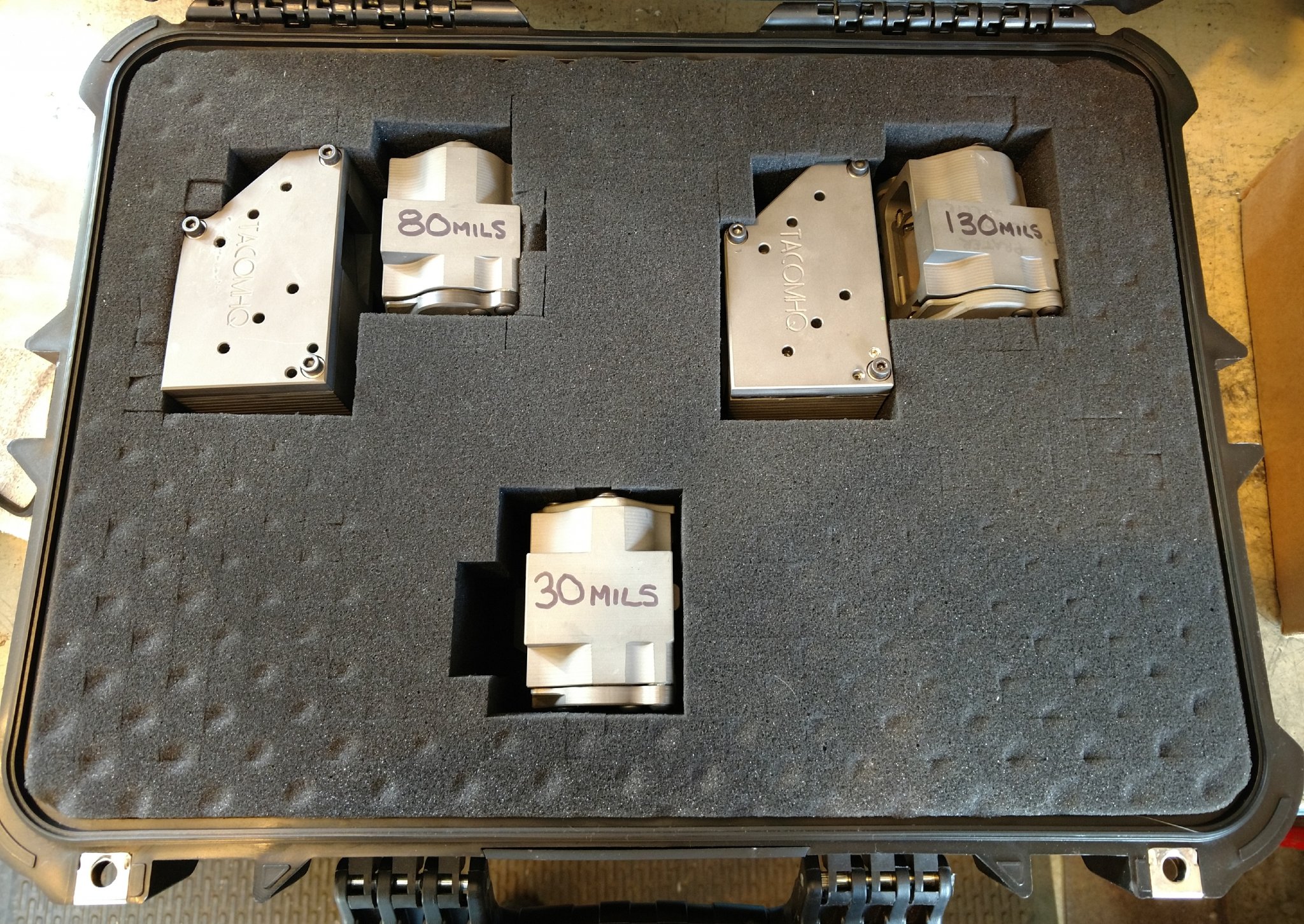

    Found this on tacomhq's website:
    "Increase max point-blank (MPB) range of weapons by 40-100%"
    I am going to raise the BS flag on that. MPBR is a function of the bullet trajectory (the flatter, the further out is the MPBR) and has nothing to do with how you optically shift your POA.
    They mean: Increase your zero range by x percent

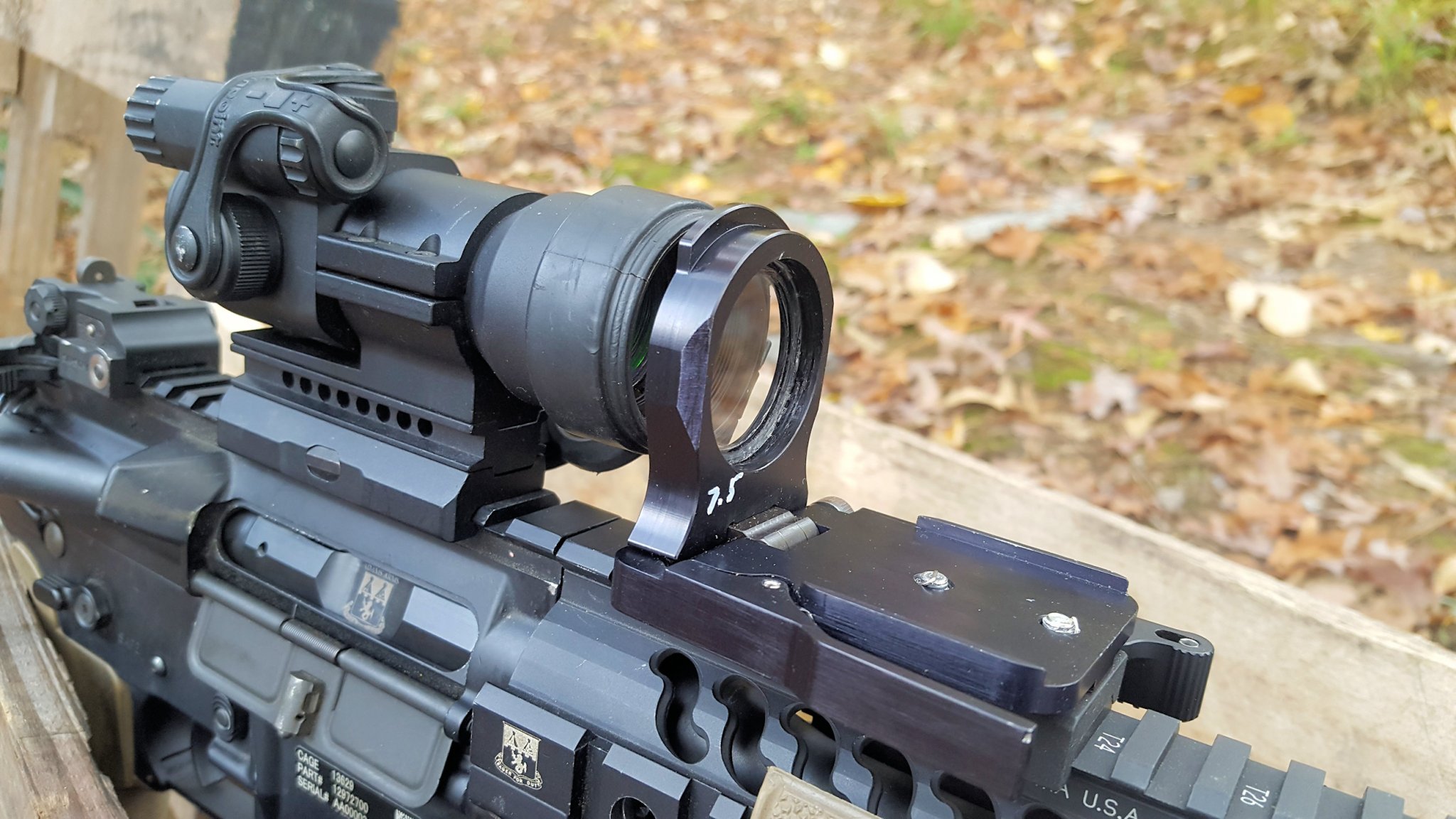

    That's pretty cool, but how does it shift the light? It doesn't look like it has a prism in it like others I've seen that are way larger and more clunky. Is it like polarization or something?
    It's a piece of glass with non-parallel surfaces. Like this. The deviation angle in the second picture is the mils you are adding.

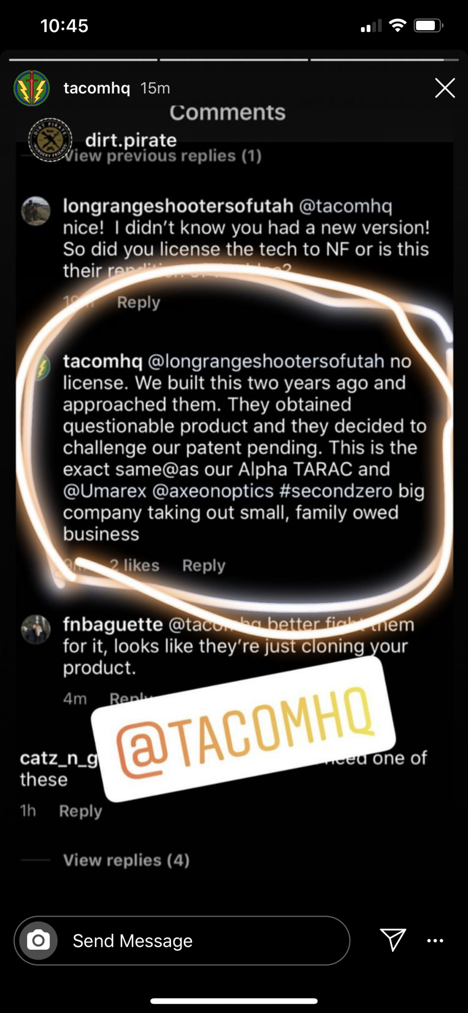

    TacomHQ ain’t happy ???
    If that’s true, it’s a shame and people should really think hard about supporting this kind of infringement. So many in the shooting community are up in arms about not buying Chinese products and then are fine with stuff like Zermatt violating Vudoo’s magazine patent.

    This is just a variation of the tacom idea. The tacom uses mirrors and has a lot more elevation. I don’t see how this is a patent infringement, just the same concept. With the micro thing being a couple hundred dollars less then the NF I can see plenty of people sticking with tacom.
    Actually, the Alpha and Bravo Tarac are simply lenses. The Alpha Tarac is no doubt the inspiration for this optic accessory. You are confusing it with the Charlie Tarac.
    Taccom has the same style product the Alpha, it's a single flip-up lenses system

    So the Alpha TARAC is often used in conjunction with red dots and LPVOs but TACOMHQ has made higher MOA/mil versions available the entire time they've (we- full disclosure, I work for them- though all posts an opinions offered by me are not representative of TACOMHQ) been in business. In fact, there is a model that attaches to the scope objective via magnets, just like the Charlie -pic attached. The original incarnation of the Charlie TARAC looks oddly similar to the one NF just "invented."
    The original incarnation of the Charlie was designed to be small and lightweight and was originally available in the ~50 MOA and ~10-20 mil ranges. However the first military orders were all upwards of 30mil (mostly 50mil) and that required more clarity under magnification than can be granted by an optical wedge without incurring a lot of extra headache and cost.
