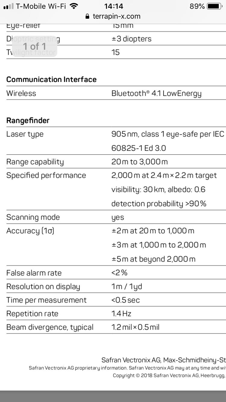

The steel at 1760 yds and at 2000 yds were 36" square... and it wouldn't range either. Freshly painted white.
NATO has a standard: 2.3m x 2.3m with 10% reflectiveness.

The Applied Ballistics guys had a good standard setup for the big LRF test they did and the sizes were reasonable. Little bigger than some steel targets but way smaller than cars and glass buildings.

Accuracy rated higher than the TERRAPIN X??

What I have found the biggest difference to be using all these lasers is the actual target.
We can hit big stuff like a house or vehicle and most will give you a reading. But once you go to an actual target, the field narrows rather quickly. I was using the Nikon Black 4K last week and unit will hit rocks and the side of a hill at 2000 yards, depending on the light, but it won't hit a target. I found it stopped hitting actual targets around 1200 yards in most cases.
The Sig Kilo2400AB will get targets to 1 mile but they have to be reflective. None reflective targets hover around 1500. The reticle, the doughnut is just too large and on top of that, you have to determine where in that circle is actually sending the beam. Which is why, when you range stuff like a house it works greats, but you end up missing small targets.
The Terrapin will get targets to about 2400m, after that it will hit houses and whatnot farther.
Just hitting a house really far away does not tell the story, we shoot targets, not houses and cars, and billboards.
We need a standard like an IPSC target, Vectronix stated this, a 2m plate at 2000m is the spec.
