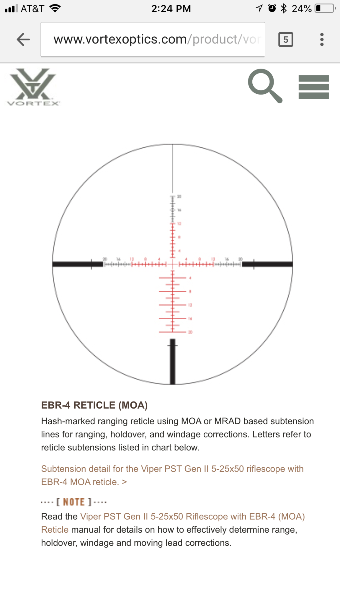

How sure are you it’s a strike eagle ?You sure it’s not a PSt gen2 in SFP ?
Can you guys point out how or in what ways the vortex is better in the above photos ?
Good catch. I deleted my strike eagle comment because, truthfully, I didnt even realize the gen2 PST had a SFP option when I posted... so disregard lol
To my eyes:
1st pic: resolution all-around is better. Slight red hue in Nikon.
2nd pic: most obvious is the bush at 9 o clock with better contrast.
3rd pic: small rocks at bottom half more defined. Nikon looks smeared. Big boulder at 9 o clock is also more detailed.
Branches at 11 o clock distinguishable vs blob.
And yes, just to reinforce the point above, this is the SFP version of the Gen II.
Overall the resolution and the contrast look better in that PST Gen 2. Granted this is a camera taking picture through a scope, but if the images are taken with the same settings, the PST Gen 2 looks to edge out the Nikon.
