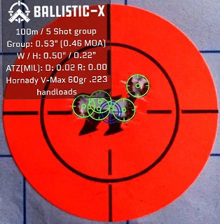

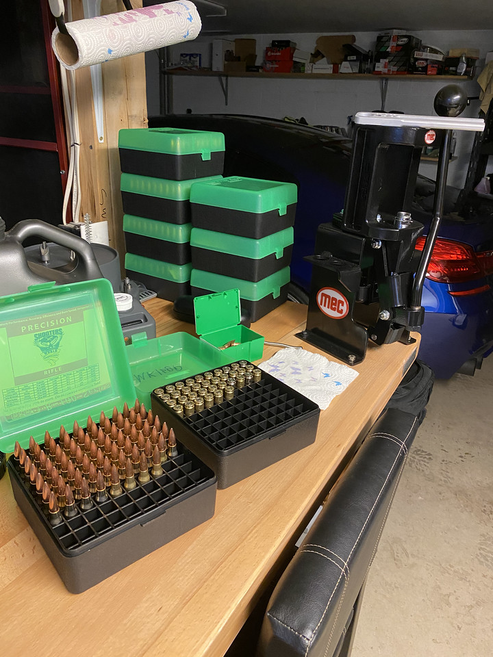

O that sucks!! Been there done that when i loaded my first batch of 223 for my very first AR, Sized them but did not get shoulders bumped back enough, rounds would chamber and fire, But the lock up was tight, could not extract a live round sometimes after it was chambered. Did not find i had the issues as i always shot the gun dry, Found the issues during a 3 gun match...... lucky for me i was able to get a bushing shoulder bump kit and was able to run the ammo and bump them back a few thousands. Had about 1200 rounds.......
Now for ANY of my ammo loading, even lots of 50 or 100 round batches for hunting, If any part of my process is changed, New rifle in same caliber, dies, seating depths, new shell holders ext, I load up small test lots and shoot them. I do often use case gauges witch may or may not give you a false security.

Too late, I already pulled them all. It was a pain in the ass but I think the bullets will be okay, they were soft seated and I pulled them with the press and a creedmoor grip, most have no marks at all.
