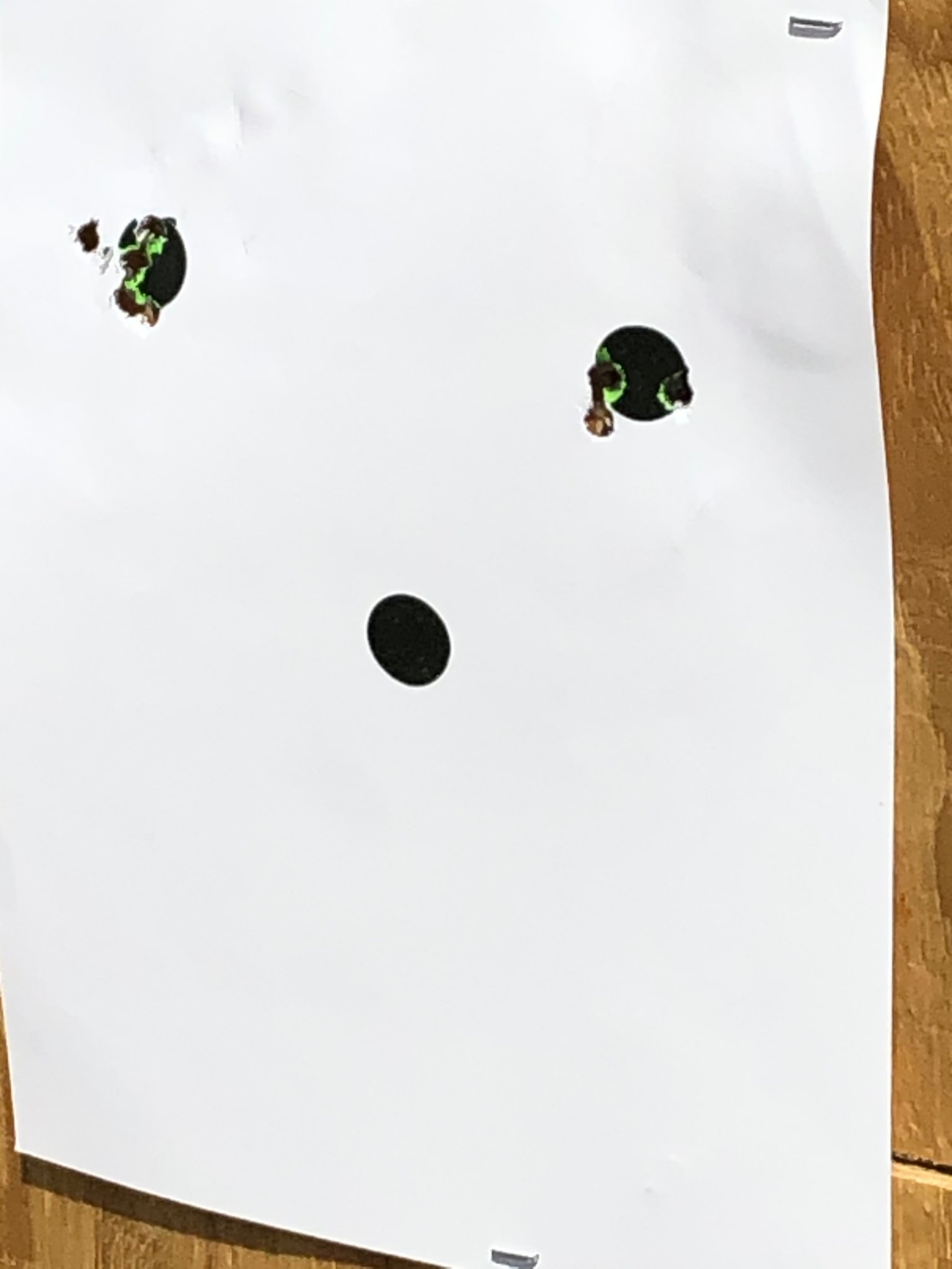

I loaded 130 g ELD-m in Lapua once fired, shoulder pushed back .002"/.003".
CCI450 primers. .020" o
ff lands .
I loaded one round of each charge of H4350
42.7
42.9
43.1 2861 FPS
43.3 2856 FPS
unfortunately my chronograph didn't pick up the first 2 charge weights.
shot in a little breeze left to right
the 43.
Shot thru a Ruger American rifle that has about 150-180 rounds thru it.
group on right with the 4 different charges. The black dot is about 3/4" in diameter.
I think I'm close on in a node?
I'll load some more up and re try keep track of each shot.
Didn't see any treasure signs, maybe go up another .3 grains.
I was just surprised how good the group was with all the different charge weights.
hopefully i can get good chrono velocities on all the shots also.
I'll re do tomorrow and post results.
Thanks
ya, its a Ruger 6.5 with a 22" barrel. At 43.3 grains i'm over max by about .3 grains depending who's reloading manual you use.
Primers aren't flat bolt opens ok. I'm using the Lapua brass CCI450 primers. I can bump up a little more but I think I got to be close to max.
