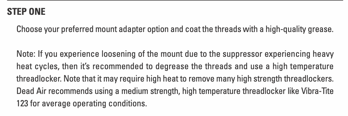

Out of the Nomad Ti manual.
I'd call Dead Air, but their recommendations are contradictory. The primary recommendation is grease, except that they recommend Vibra-tite for "average conditions." WTF?
I use a bit of moly grease and tighten with the spanner wrenches as tightly as I can with a single hand on my Nomad. Mag or a bit more over the course of a 3 minute stage is the typical duty cycle. Not glowing hot, but hot enough to melt a poly-tarp (ask me how I know). No issues with loosening of the body from the mount.

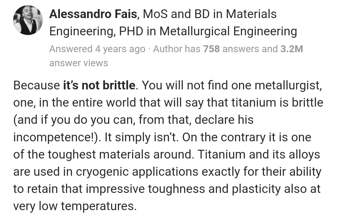

If you don't understand why Titanium is brittle and fragile, then maybe you should do some metallurgical study...
If you don't understand my explanation, then maybe this will help...
That's just a safe number that is recommended by suppressor companies... How desperate are you to be right? Because you're 0-2 right now. 😂
Also, most companies that offer F/A rated titanium cans are really selling hybrid suppressors, with a 17-4 SS, inconel, or stellite blast baffle or first couple baffles, then the rest are titanium.
Normally I wouldn't recommend using Quora as a citation, but since you provided the link, let's take a scroll:
Titanium is used for stuff like suspension springs and turbine compressor blades and IC engine valves (both intake and exhaust) and connecting rods and F-14 wing boxes and implanted artificial joints, so maybe we're shouldn't be too hasty to call it "brittle" or "fragile" or suggest that it is poorly-suited to high temperatures.
It is expensive, and difficult to process, and completely intolerant of fools. These attributes should not be confused with other blanket statements that get repeated by those who don't know any better.
I've heard that above 800F, titanium turns into melted butter, but like a particularly fragile and brittle form that is not at all suited for use on popcorn. Complex stuff, but easy to understand on the internet.
I mean...... how do you come back from this? Simply reply with what is a cute username?
