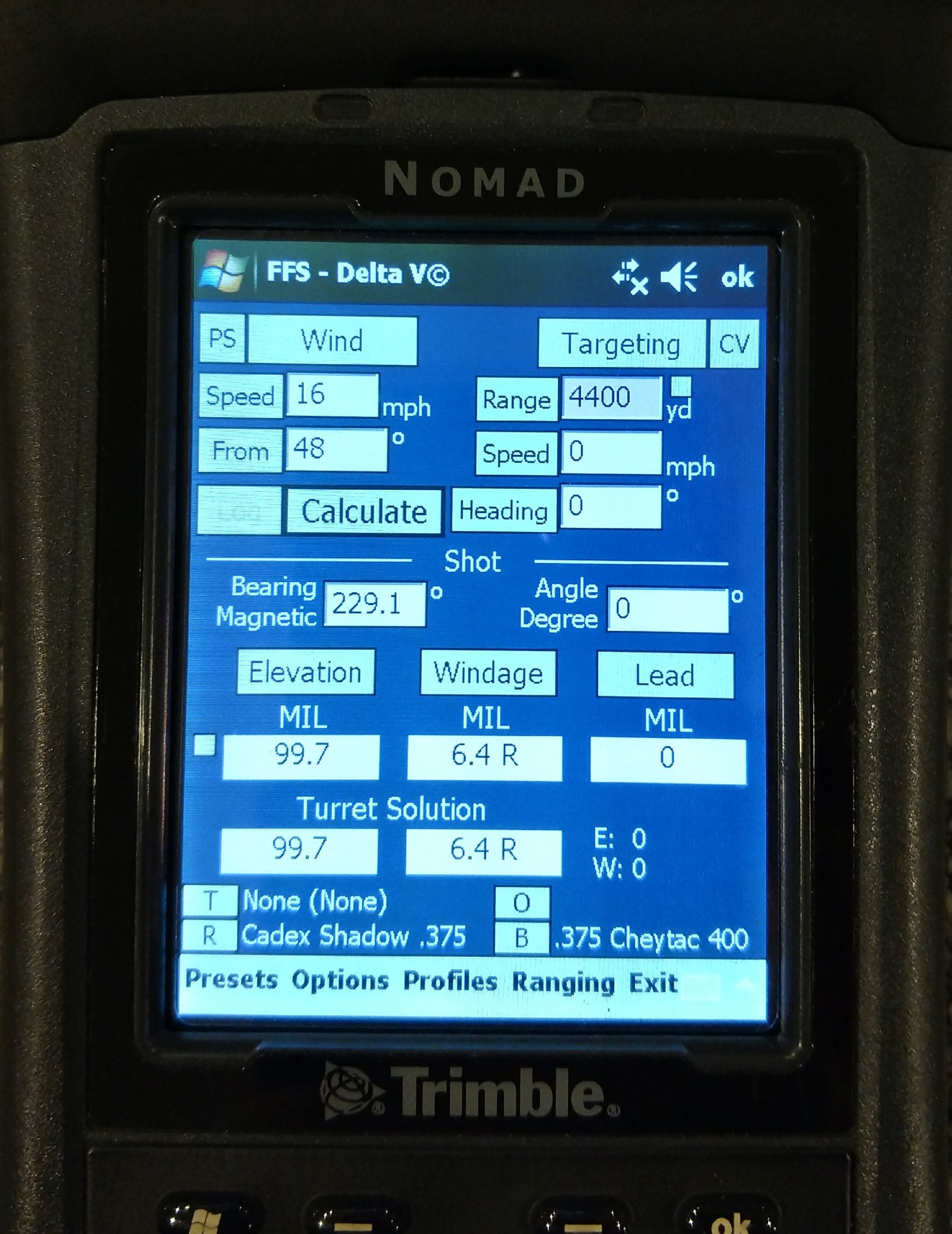

By the looks of the screen shot i think it is a single wind zone.
Up on top of the screen next to the PS tag, the wind tag would turn blue if all three zones were inputted.
True. Yeah I couldn’t remember off the top of my head if you had to have just more than one or all three selected to get that to change!
