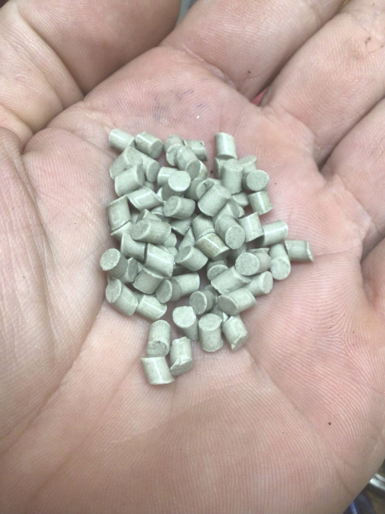

    They make ceramic media. What I use in my rotary tumbler for black powder cartridge cleaning.
    Larger than the pins*, but depending on what caliber the brass, you still need to make sure there's none in the cases.
    * (They make in all sorts of sizes, some that would never fit in a case mouth, but I don't know that you'd want to clean brass with it.)
    I think soft media (relatively) in a rotary would take a very long time.

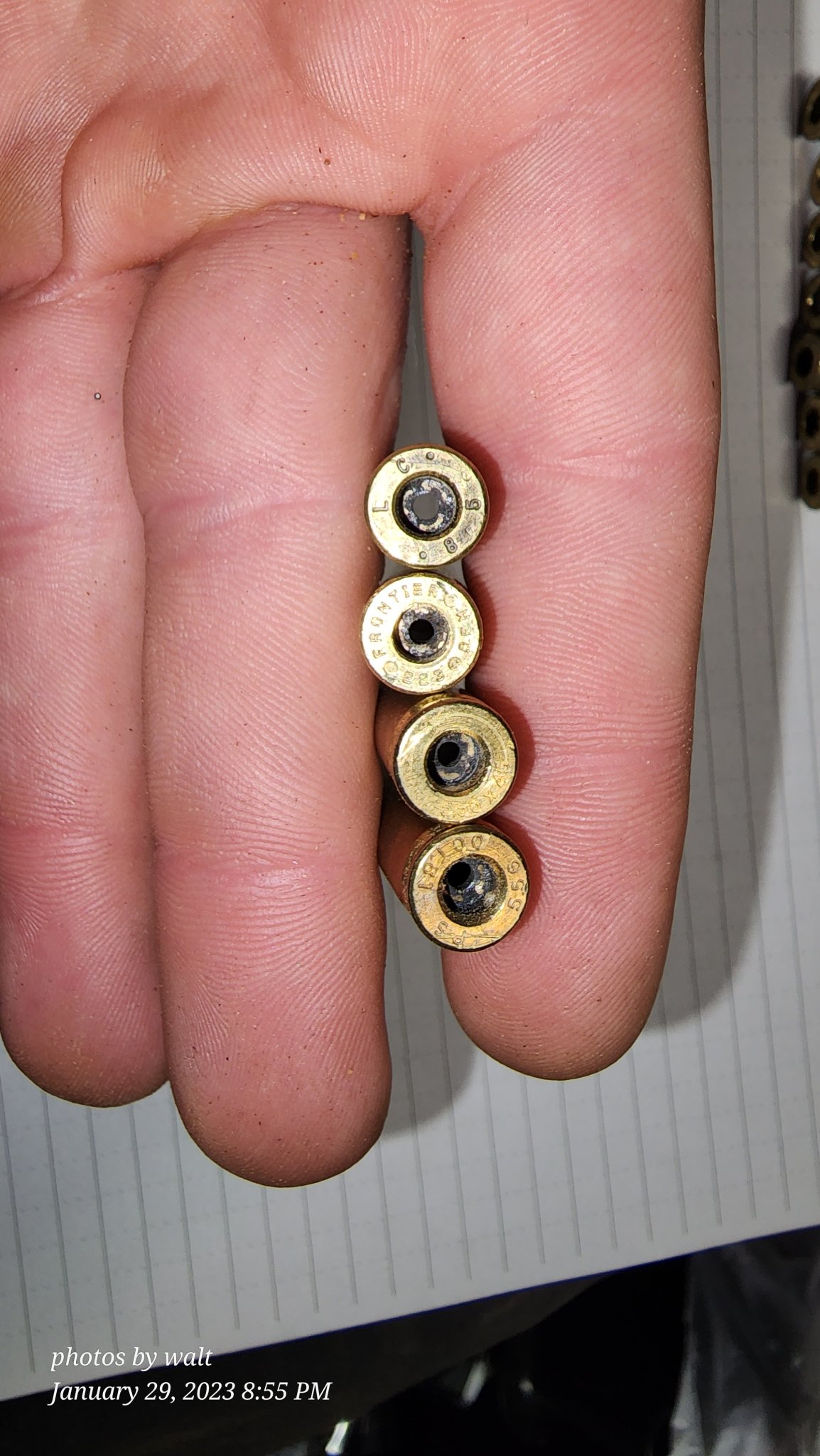

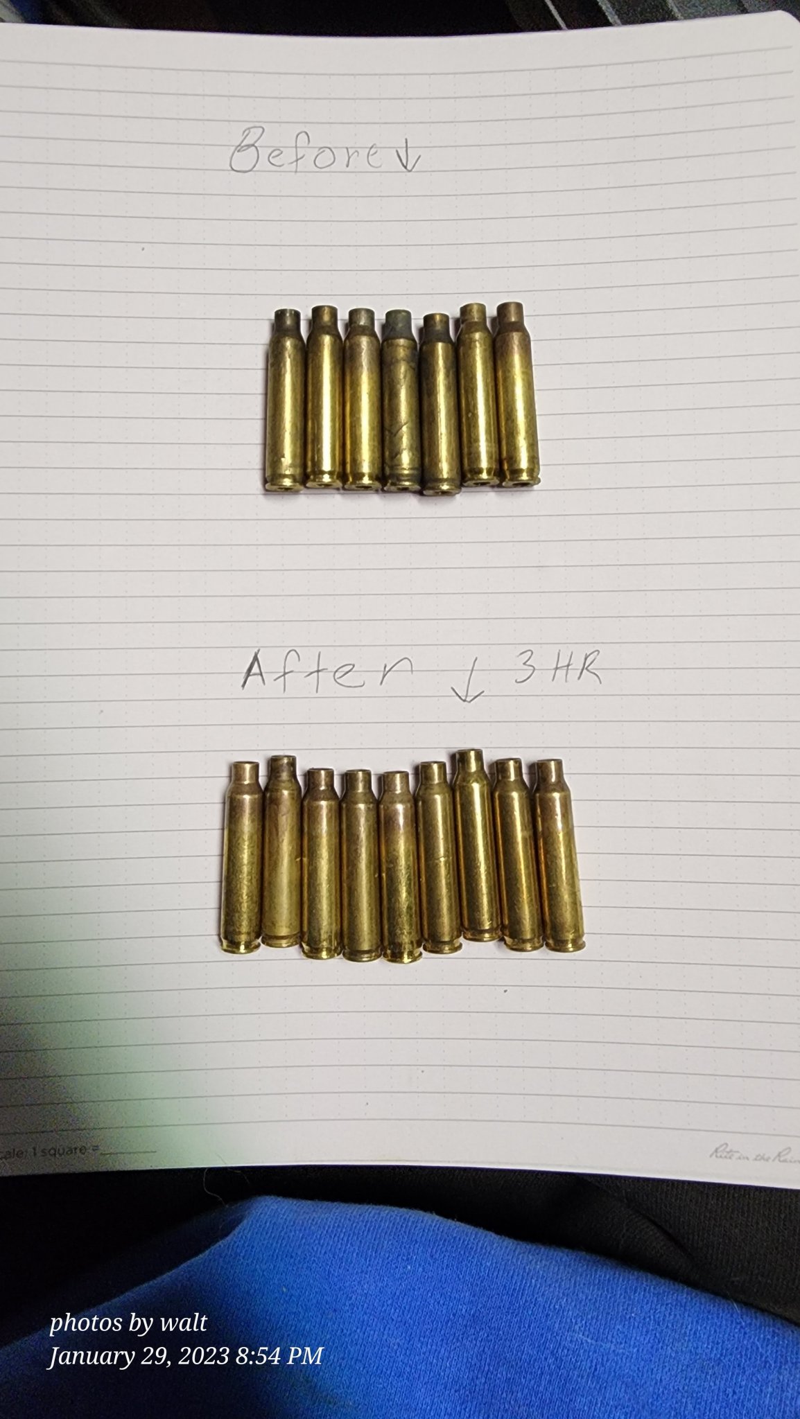

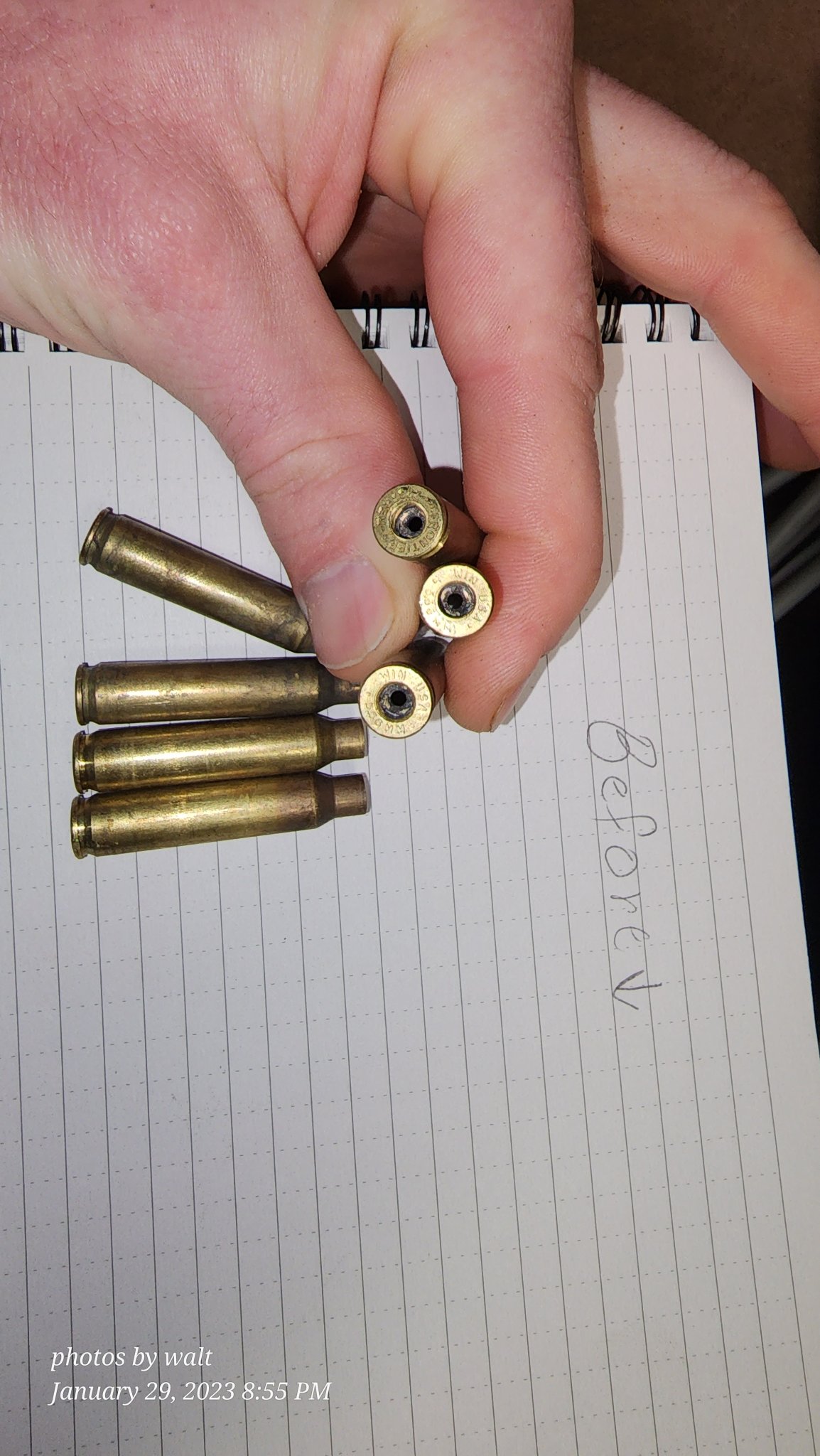

    I rinse the brass a couple of times and then put them in my wet tumbler with lemi shine and dawn no media and it gets them clean. I have cleaned plenty of rifles brass this way and about 5, 5 gallon buckets of 9mm brass.
    So I ran the tumbler for 3hr. Heres the results
