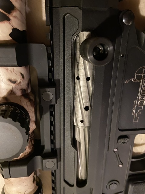

Initial impression: Fit between receivers is excellent. Finish is uniform and looks very good. Fluting on the barrel is consistent and well done. The bolt carrier is fluted and has the potential to be very nice looking. Mine however looks like it was chewed on by a beaver, The cam pin was just as bad and was replaced before firing. Additionally, the gas key needed to be restaked as the bolts were easy to loosen. With these issues noted and remedied I headed to the range. I did expect some issues at the price point.

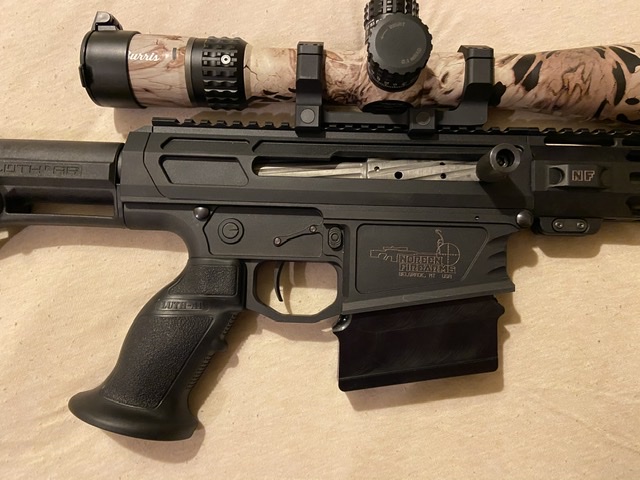

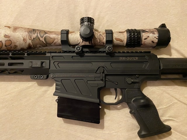

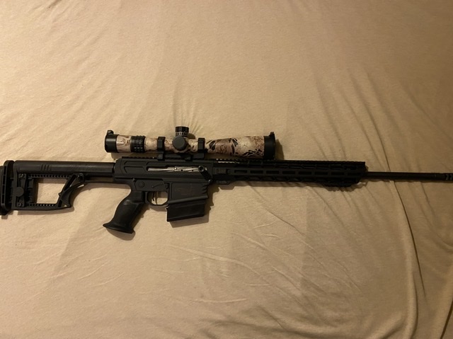

Here are some pictures. I would post a video of the rapid fire but I don’t know how.

That’s a very beautiful firearm you’ve thrown together there. .300 win mag is my favorite caliber, and I’d love to try out a semi-auto precision rifle some day. I hope your issues are minor and eventually disappear and you can split atoms with ease.
