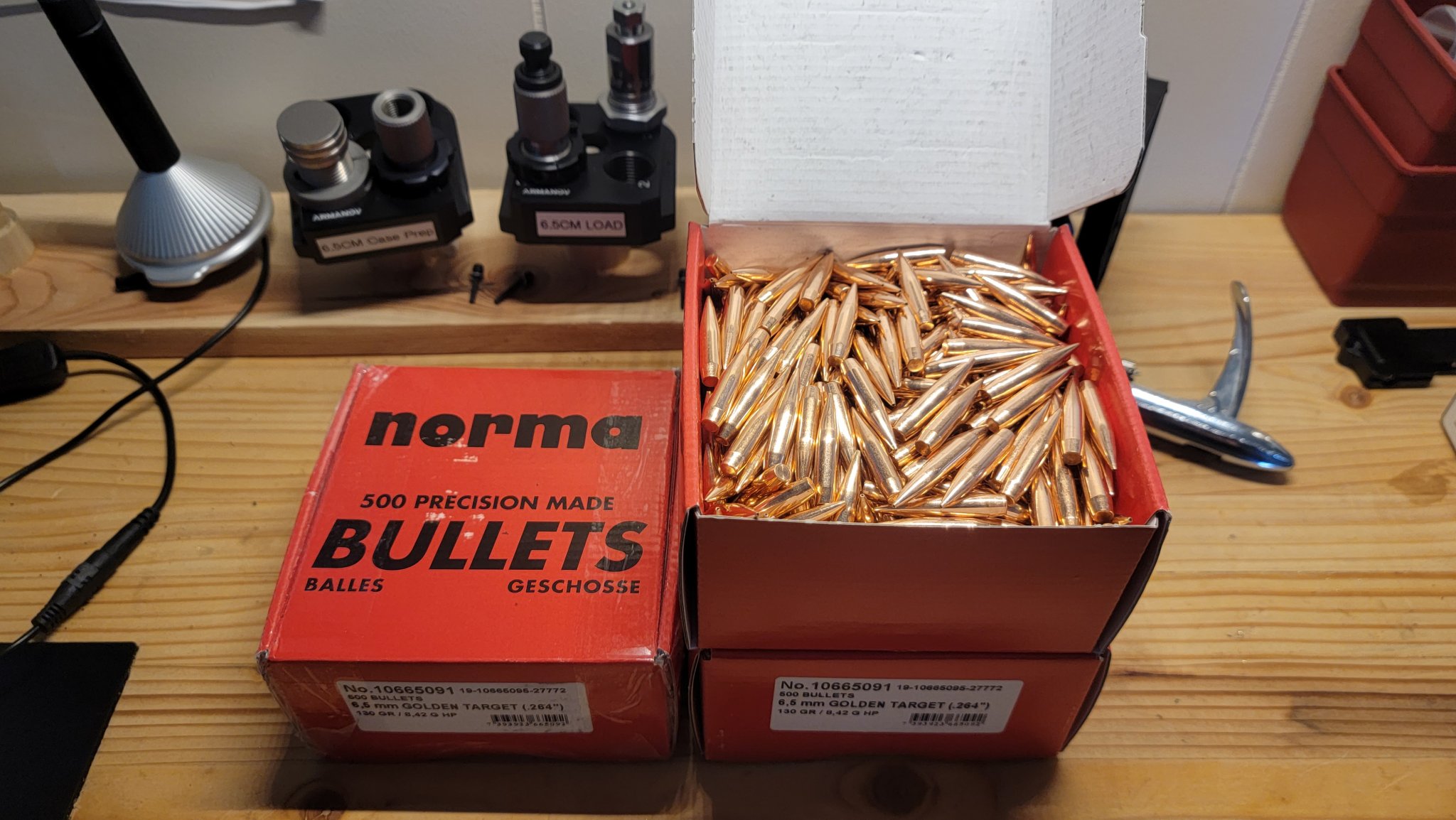

Norma 130 gr. Golden Target Bullets
Anyone used these in 6.5CM? Thoughts?
...these were the bullets used in the original PRIME AMMO that Lowlight gave high ratings. IIRC, the original PRIME 6.5CM was being loaded by NORMA to PRIME's specs.
...have come across articles from European competitions and it's a frequently mentioned bullet, highly regarded.
