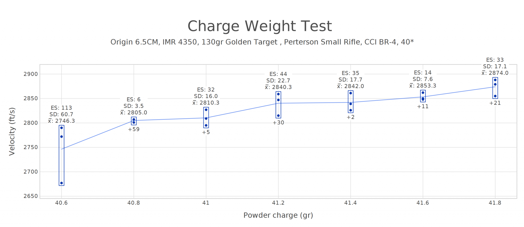

I ran my 18" hunting rifle load in my 28" that I am using in a NRL match and it made 2985 fps with Peterson brass, CCI450s, and 42.0 gr of Rl16.Sounds like a great start. Im running peterson brass so I'll back off the charge quite a bit. I was hoping to get 2925fps. It may be doable at my altitude but I'd settle for 2850. Looks like 2925 would be the threshold for NRL hunter though. We'll see...
Yeah, with the Hornady 140s I'm getting 2850~ at 40.8gr h4350 and thats a 24" barrel. That's right at the beginning of pressure signs but it just seems to be a fast barrel. So I'm really curious to see what I find with these 130s.I ran my 18" hunting rifle load in my 28" that I am using in a NRL match and it made 2985 fps with Peterson brass, CCI450s, and 42.0 gr of Rl16.

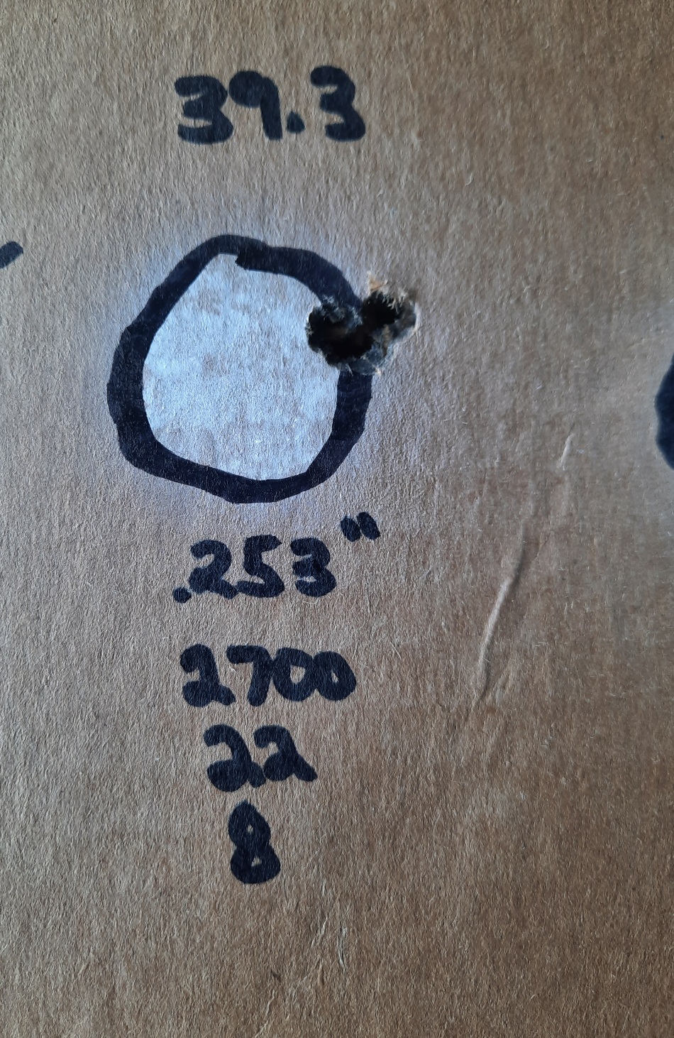

OK guys, a little disappointed. Was able to do some seating depth testing. Made one mistake loading the mag the .070" and loaded an extra from the .060" batch. Not sure if it was first or last shot (top or bottom).
The most promising group was the .105", bullets seem to be happy and stable (small holes) but the group is still fairly large (.500") when compared to other loads shot in this rifle.
I have a few options.
Test .103" and .107"
test a different powder
when my magnetospeed shows up tomorrow, re-test my velocity nodes and see if that makes this thing shoot any better.
Should I just be happy with my 1/2" group and carry on?
It was the top one I believe.....IMHO I'd be looking at the .070 & .060 for additional tweaking based on overall group size and similar horizontal & vertical POI's, despite the .070 group having an extra hole from the .060 batch (which hole is the one from the .060?).

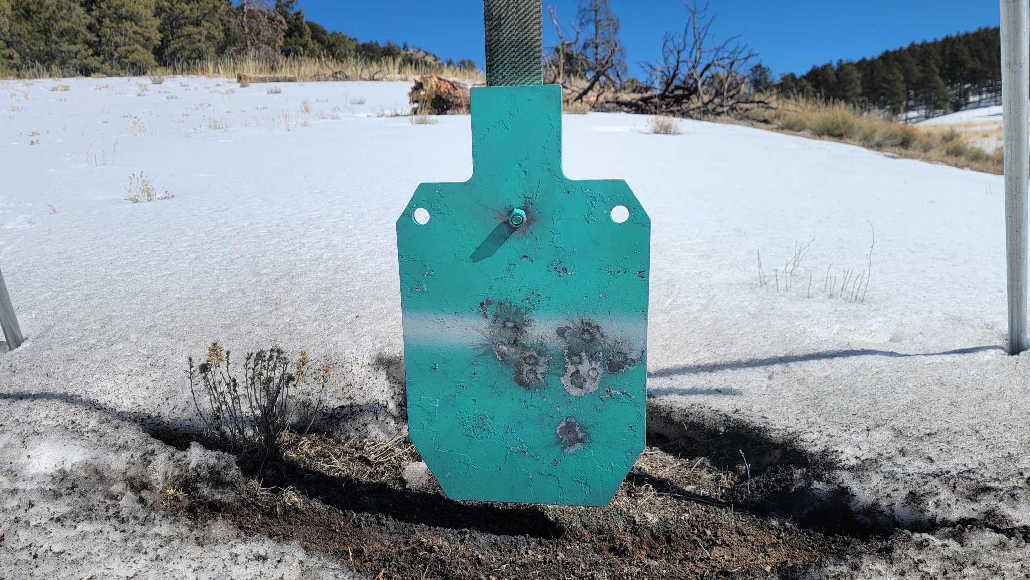

Well I ran the test and loaded the rest of 50 at .070" off. The bottom two groups were warm up and "cool down" with the .070" load.
Strange that the window would be that narrow but the .058 window seems a little bigger.
The steel target was at 475 yards and had a vertical of 3-3.5" if you don't count the one that dropped low. My daughter chose the color...
1/2" isn't bad but I'll keep playing with it and if I find anything magical, I'll let you guys know.
Yeah your probably thinking clearly lol.I'd be happy if I got 1/2" groups with that bullet.
None of the groups look particularly clean. I think there is some improvement to be done with this powder/bullet/primer combo but I'm about to start mixing some things up....based on the new target results, I'd say the 0.058 was the better of the two, IMHO. If the 2 bottom groups were the 0.070, the one on the right has quite a bit of dispersion compared to the left. I'd target seating at the 0.059 and due the plus/minus variations that ultimately occur, you would still be within the range of your best groups to date....just my opinion.

I've probably shot 15 rounds over the chrono @41.6gr and had an ES of like 27fps. Not the best but I'll work. Accuracy is sitting at 1/2" but I'd like to keep trying different combos. Superformance seems pretty far down on the burn rate chart. I kinda want to try some faster powders just to see if it's happier.

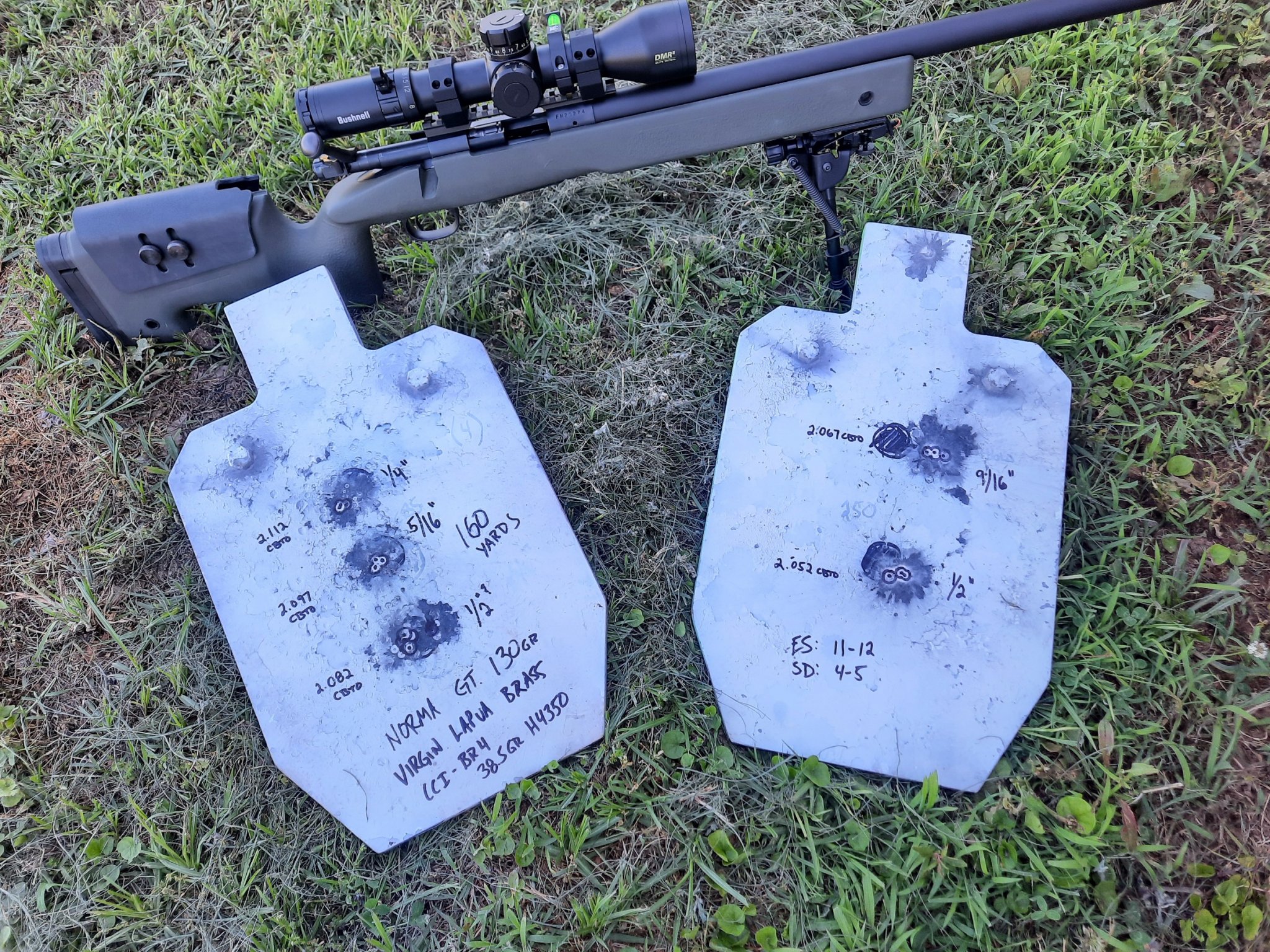

In my 260, 42.2grs of H4350 is the bomb.For me, the 130GT's love the 2850'ish to 2950'ish velocity. It's a huge accuracy node for me.
42-42.5gr's of H4350.
