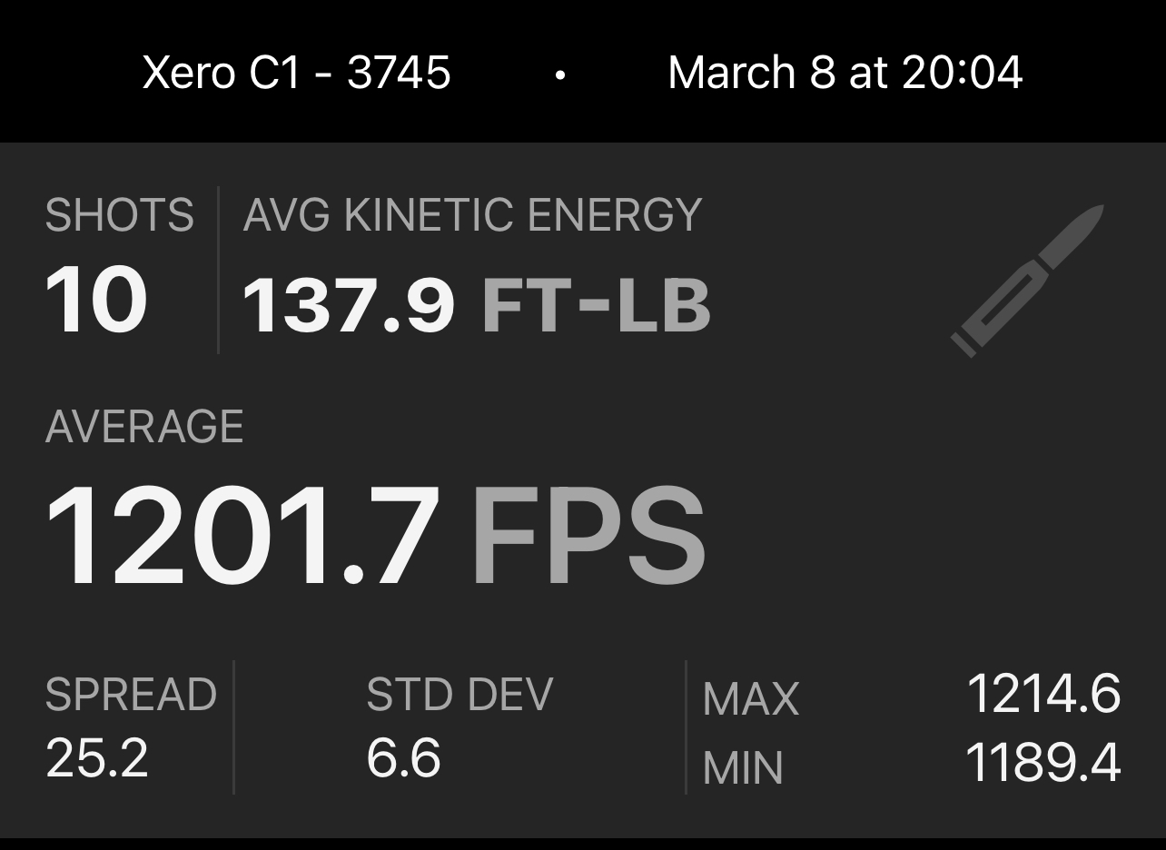

Bought a few boxes of the stuff to try out. I only shot them at 50y tonight. I’ll test at 100y next time I’m out.
My best groups tonight with them at 50y were 0.23”, 0.29”, and 0.41” with a flier. Take the flier away and it’s 0.21”.
They are definitely hot rounds. Numbers are from a 22” 16 twist RimX.
