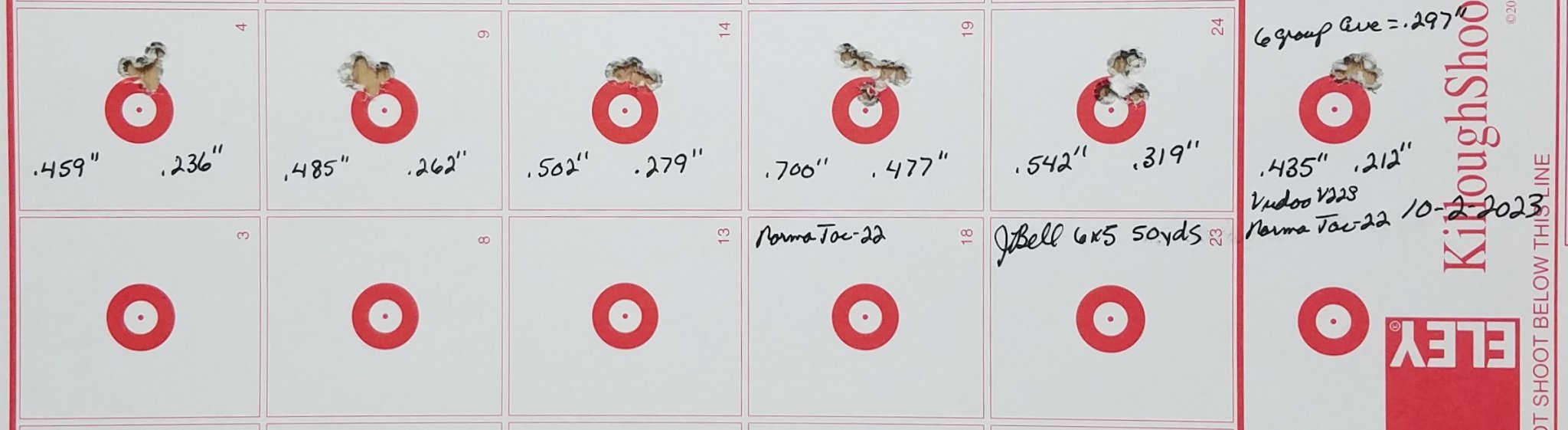

This is how my Vudoo shoots with Norma Tac-22 at 50yds.
