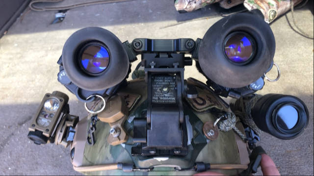

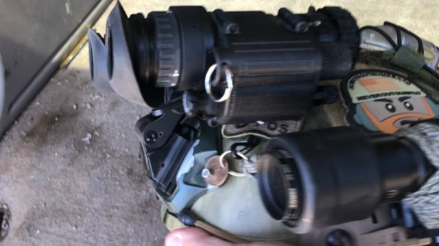

The Rhino 2 with Norotos PVS15/18 Dovetail on it is really hard to beat. It will stow a set of Bino's or a Single 14 flatter on a helmet than any other mount out there period. I started out with the Wilcox G24 and have had it parked for a long time since using the Rhino 2 Dovetail.
The Rhino 2 Dovetail is a lot more stable mount and stronger mount without "chatter" in it like the G24's. A big problem for me with the G24 is the thin serrated rails allow "chatter" in the adjustment on the rail unless you crank down on those tiny allen screw that are there to take that out. But once you do that you cannot easily adjust your in and out position of your NODS. Some folks run bungees on their NODS instead of tightening down on the allen screw, but the idea of hooks under tension that could pop off and hit me in the eye is not very appealing to me.
Additionally the Rhino II Dovetail has a lot more adjustment, especially in the fore and aft which allows you to run your NODS further out or in depending on your preference.
Under an amped up situation, stowing your NODS using force to overcome is quicker and safer. Point being if you are amped up and miss the button on the push button mounts while exerting strong force to flip them you run a chance of breaking something on your mount or the aluminum shroud or disconnecting your mount from the shroud.
Also, if you ever face plant a set of NODS the force to overcome will likely give and fold out of the way such that you do no or significantly less damage to the whole system than a locked down mount that has to activate a release button to stow.
Yeah, I know the "cool guys" run G24's but I aint cool. I want real field performance and durability. Simply amazing to me that my Rhino II Dovetail with an all in average cost of $125 bucks, is a far better mount than my $400 to $500 Wilcox G24.

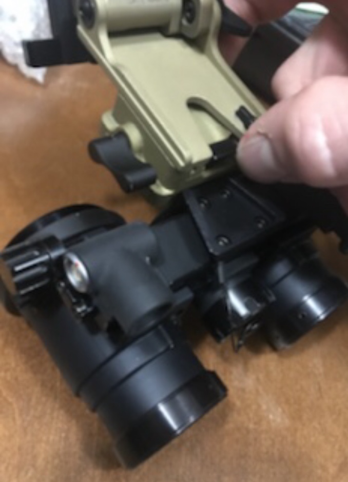

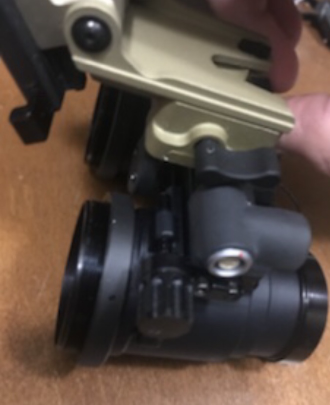

The Lo-Stow is nice but be advised that it will not work with RNVG housings. The Slide adjustment lever makes contact with the illuminator and won’t allow the dovetail mount to lock together on that particular housing. Pretty sure the mod 3 housing won’t work either. Sorry for the blurry pictures but you get the idea.

The Mod 3s will work , or at least the ones i had did, as there is no LEMO port/ IR light on them. My new RNVGs do not work on the lo-sto or the AKA2.

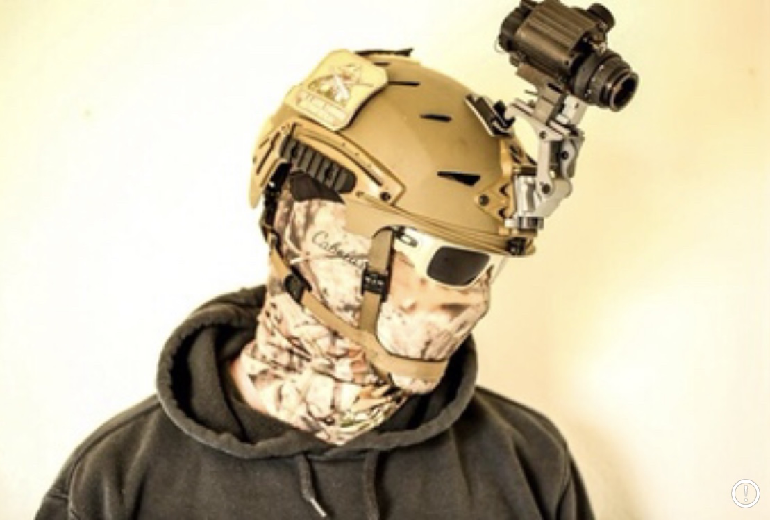

I run the Mod Armory Bridges or Mod Armory J Arms and they will give you plenty of outward adjustment. I can almost fit an entire fist from my eye socket to the ocular end of my devices as far out as I can run mine on the Rhino II Dovetail.
To me the best value and all round featured "mounting arm" is the Mod Armory Light Weight Bridge at $350. Yeah you spend about $150 bucks more than a Wilcox J Arm but you can take one arm completely off if you want to run a single or just roll the other unused arm up out of the way or you can run duals if you want to.
So the complete versatility of that "Bridge Mount" and all the roles it can fill (including running a Breach Thermal) makes it the finest investment dollar for dollar of any of the solutions out there. And it is one simple, tough, wobble free mount.

For running a mono, the Mod Armory setup described above with the Light Weight Bridge on the Rhino 2 Dovetail is just as compact and low profile IMHO.
And a lot less costly.

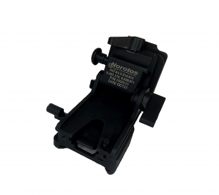

Well the Norotos rhino 2 with the dovetail adapter would probably be the highest stowing one that I can think of. It has suitable adjustments to get it comfortably on your eyes and it stows way up compared to the G24. I wish I had a picture to show you but here’s a picture of a 14 stowed away with it.

Jay, that is definitely true with any devices/mounting arms that cannot articulate.
However, for mounts/devices that articulate and let you lay the device right down on the helmet I have found it to provide you one of the most compact solutions out there.
With any of the Mod Armory mounting arms/bridges, PVS 14's, Breach's or any of the articulating BNVD, DTNVG etc type Binos will all lay very flat and compact on your helmet. For someone entering and exiting vehicles and other confined spaces a lot, the Rhino II Dovetail is a pretty nice option if they are running devices that can articulate.

Jay, I might have misinterpreted what he was wanting. I see now he needs them further out of the way to get a clean purchase on his scope. So the Rhino II will do it like you say if he can live with being high.
