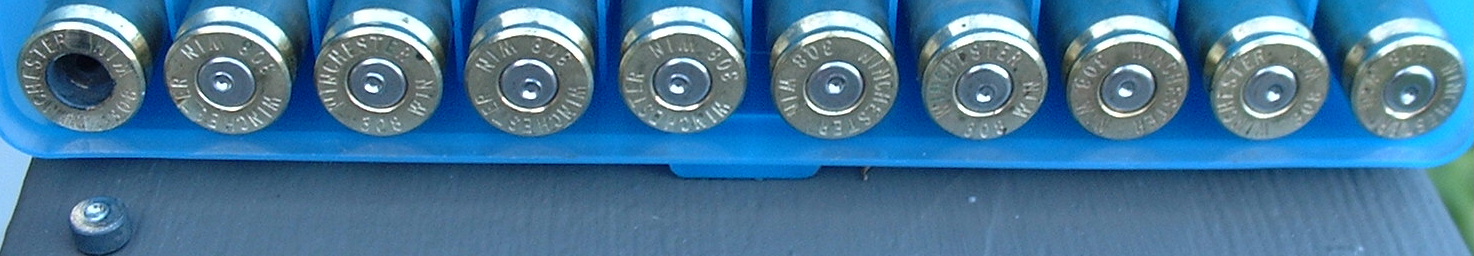

I just checked what I have been hunting with for 2 years.
WW 30-06 brass for 6.5-06
Nos 280AI
WW 7mmRM
Nos 7mmSTW
No trouble with loose primer pockets, and I am no stranger to a work up to loose primer pockets.
I work up until I see an increase in extractor groove anywhere around the groove, then I back off 3% powder charge if it is a temp stable powder like H4350 or IMR 4166.
I will not use Re22, not for the last 10 years anyway. Too temp unstable.
