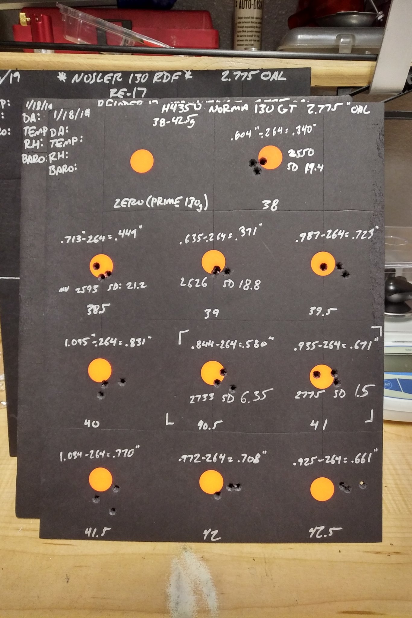

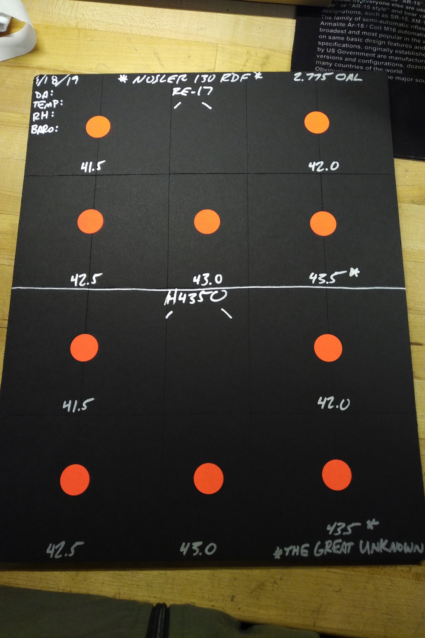

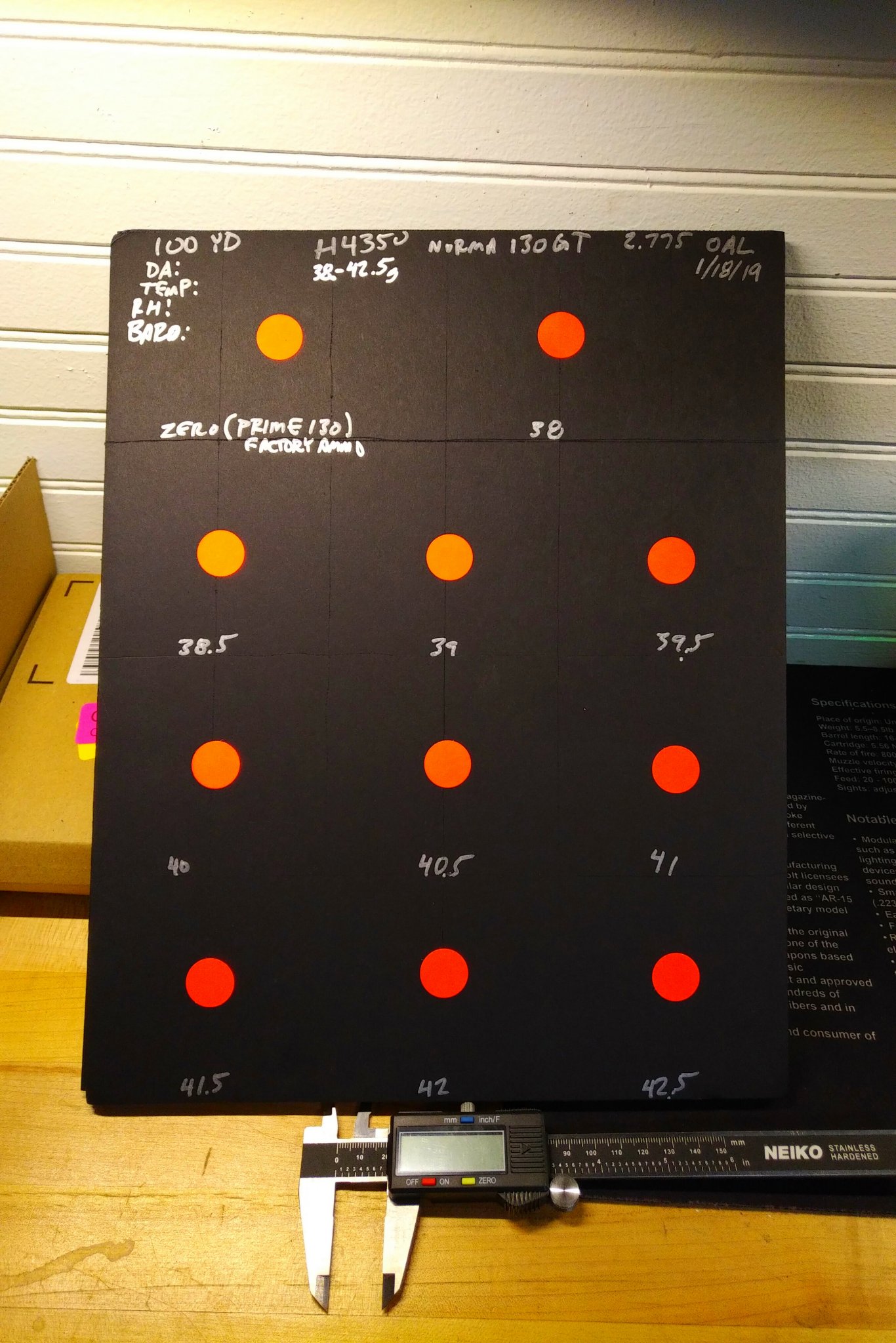

Got my black foam board with .75" orange spots all done up for my load development testing tomorrow. I got another board made up for Reloder 17 as well.

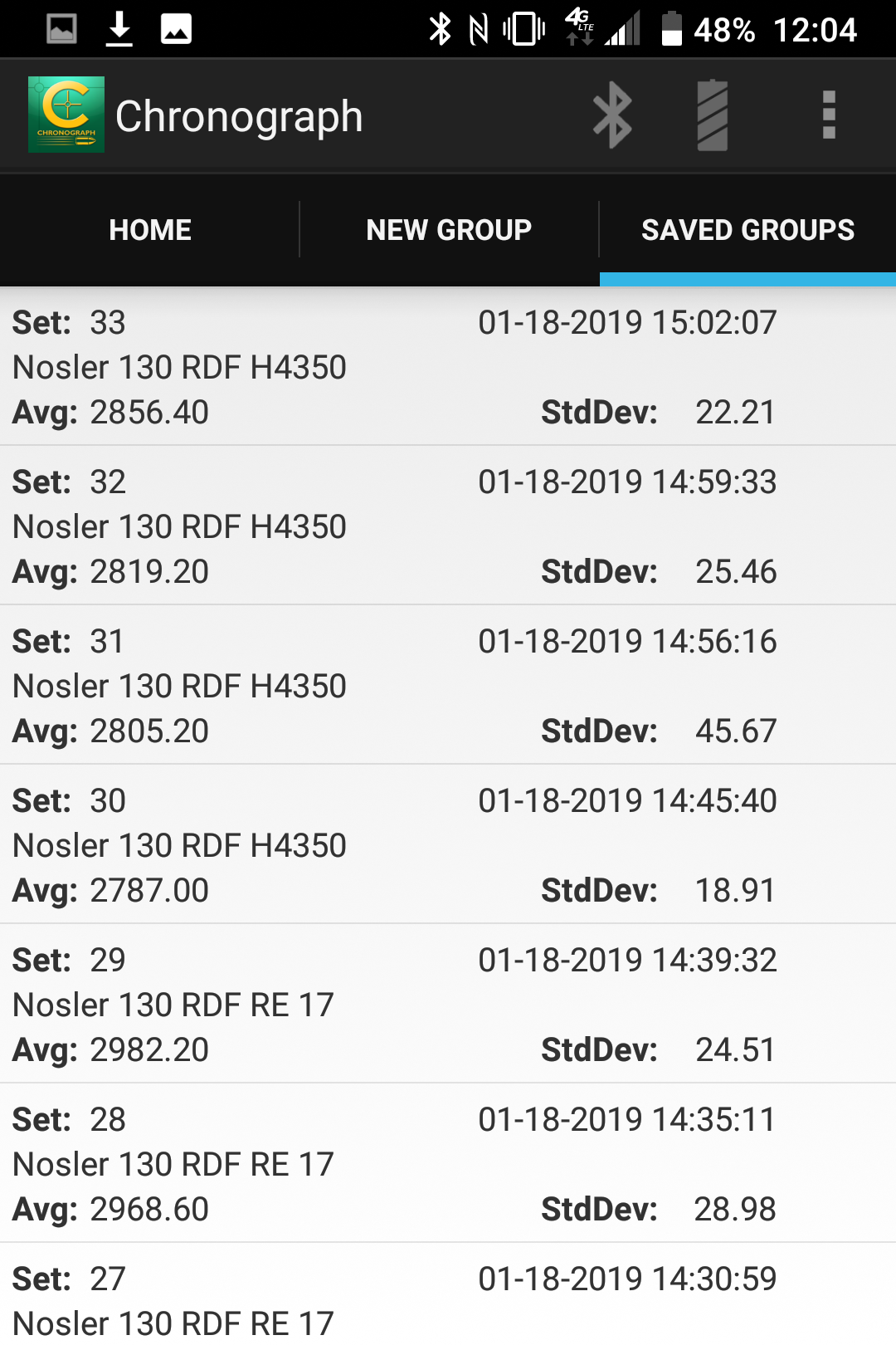

I'm gonna bring my Caldwell Bluetooth chronograph to see if I can do MV at the same time as group sizes, but it's hit and miss (pun intended) on catching 100% of readings. I figure as long as I can get groupings going, I can then test 2 or 3 10-shot strings in the future to get a solid average MV on the good groups then start walking them out to 500+ for BC validation and whatnot.
And the one for "the great unknown" Nosler 130 RDF's ???

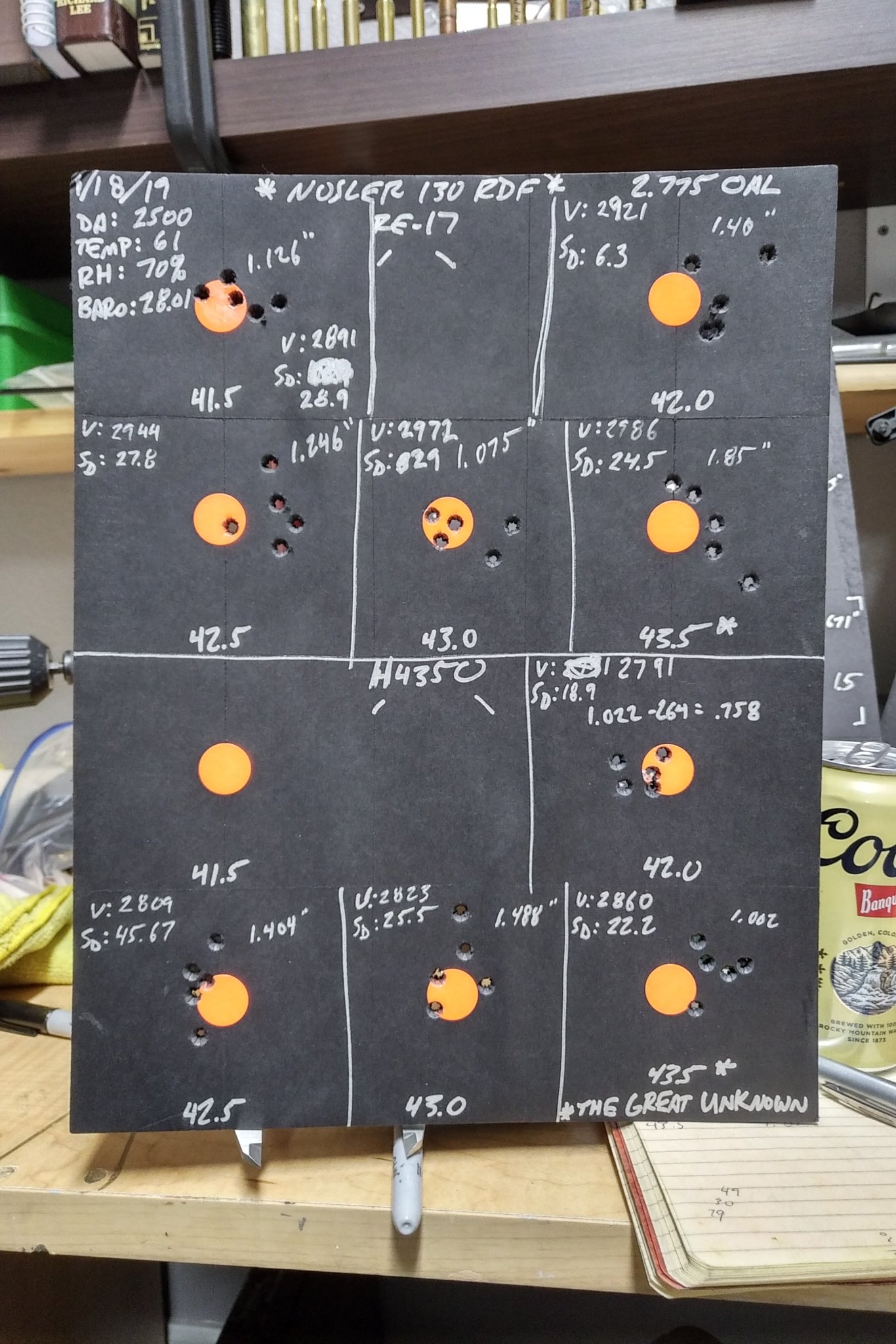

OK, so...... Shot 'em. Got a couple of good groups that I need to measure out. I'll post pics tomorrow or Friday. Some groups were definitely sub-MOA, but the SD's weren't tickling my fanny. Would have 2 or 3 close to touching then the RDF Event (Random Damn Flier) effect besmirched my own confidence in my shooting abilities, or made me think I forgot to call a flier because I twitched or some shit.

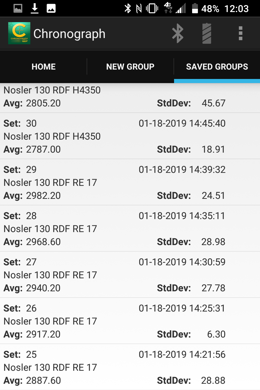

Here is the basic velocity and SD info from my chrono:
No "danger" pressure signs other than some primer catering (not flattening). More info to follow in the coming 48 hours.
To show I can kinda shoot whilst sitting at an uncomfortable and wooden bench using my bipod and tactical, rice filled, black sock rear bag.... ????

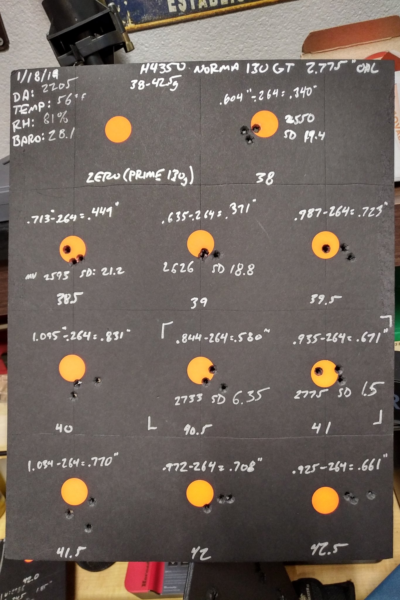

here are my H4350 loads pushing Norma 130g Golden Target projectiles. Those are 3/4" orange spots. I think I have some fliers I called, but I don't have my notes in front of me. My largest group was .770". Not too shabby. The Reloder 17 didn't much like tha Norma 130g, but it liked the Hornady 147 ELDm... more testing on that'n to come.
Id recommended you do a later test working up in .3 grain increments. My sd is rarely higher than 10 when I find my node and then I tune my seating depth
OK, so....... I didn't weigh-sort these bullets before this load development shenanigan. I sorted the rest of what I had and the majority was 130 and 130.1gr. Had as low as 129.71 and as high as 130.38.
Brass: Prime (Norma)
Primer: Rem 9 1/2
OAL: 2.775" (Nosler recommended)
Rifle: RPR
Barrel: Proof Stainless M24, 24" prefit.
Brake: APA Little Bastard
Position: Sitting at bench, bipod and rear bag.
The groups are.... Meh... nothing blowing my skirt up.
On a side note....
Today, after finally measuring my base-to-ogive/lands engagement....
I found out I was jumping the RDF's about .055"!!! (Oops)
So, now I have them weight-sorted, with a faster power per @308Gunner recommendation, and set to jump .030" and we'll go from there.

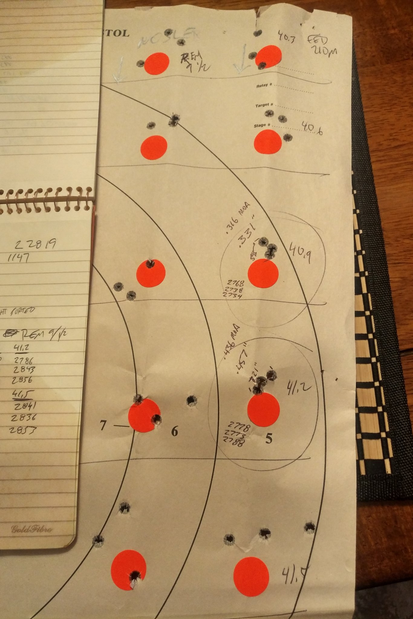

BLC(2), seated .060" off the lands FOR THE WIN!!!
Weight sorted the bullets because they were all over the place. Changed to a faster powder, BLC(2). Did a head to head comparison with Remington 9 1/2 primers against Federal 210M
On the spots, Rem 9 1/2 on left column, Fed 210M on right column

I am glad you got them shooting, they are really good in the wind and hell on coyotes and hogs.
Thanks man. It's was your suggestion of using a faster powder that got me here. I really appreciate it.
I had zero pressure signs at all, so I'm probably gonna try 41.3 and 41.4 just to see what happens. But this will be my "inside of 1000" loading.
