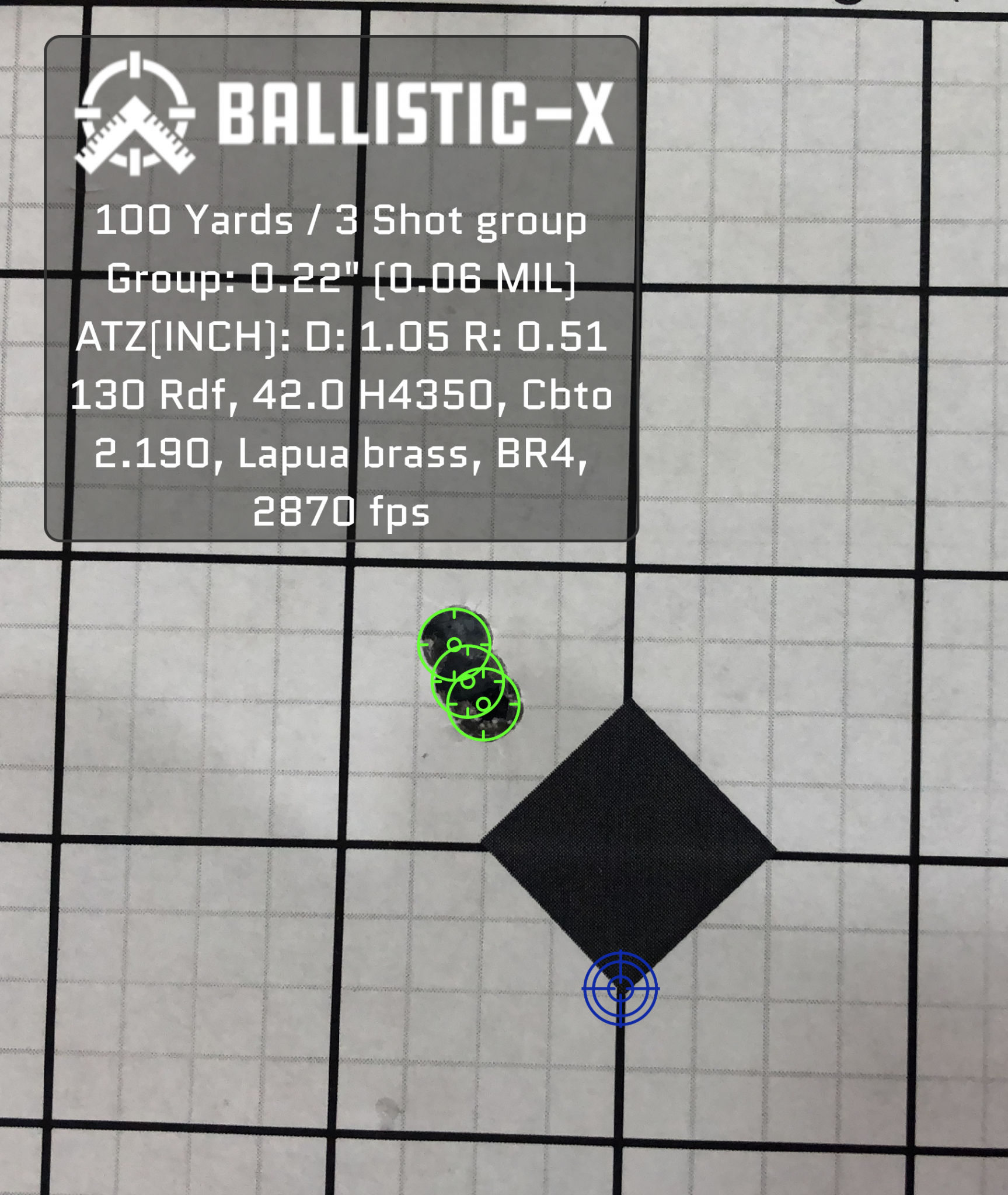

It’s only a 3 shot group during a seating depth test but looks promising. Will do more testing next range trip.
