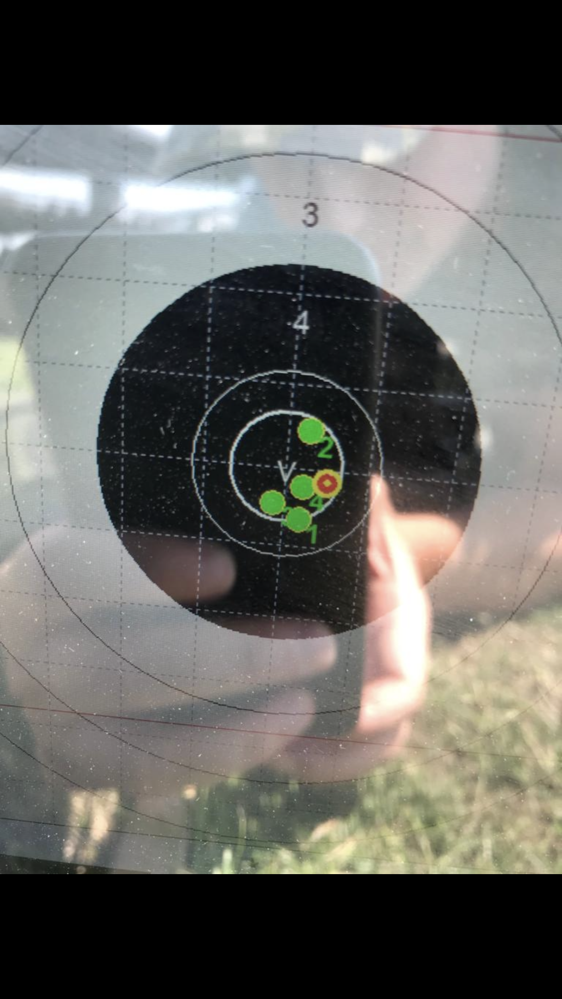

I’m now using the 130gr RDF in my .260 REM going 2925 FPS. Pretty happy with groups at 100, 600 and 1000 which is below. Loading them 70 thou off to 2.94 COAL.
