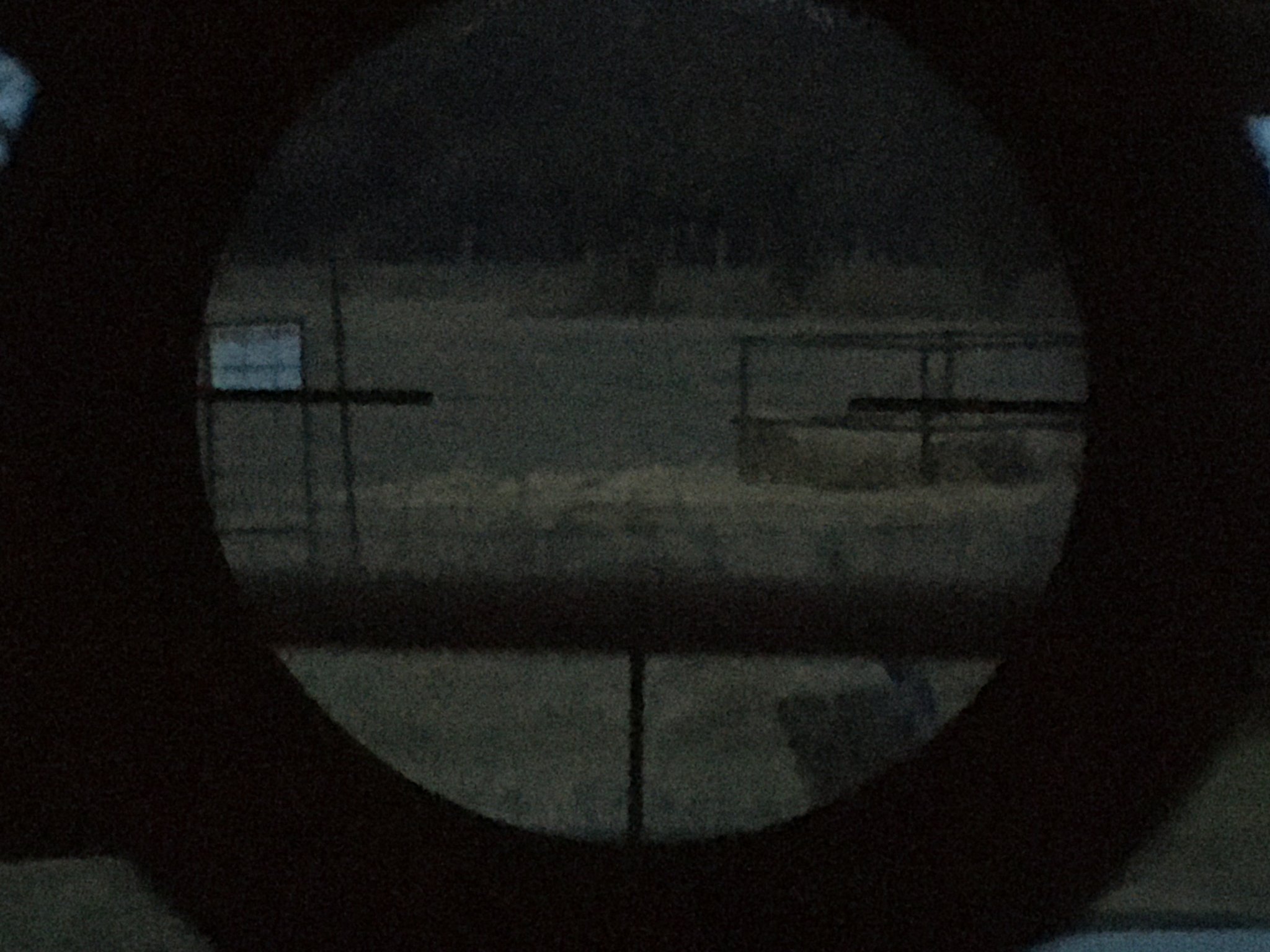

I actually played around with this scope at 22 minutes before sunrise the other day. I could see the thinner SCR2, it was usable.
I've been saying for years the whole low light scenario is overblown. You hear about it in nearly every hunting scope discussion. But I've never seen low light conditions ever be an issue with seeing your reticle. I've been hunting been game fanatically since 1978.
If it's so dark that you cant see the reticle etched into a lense 5 inches from your face, how on earth are you able to identify what your shooting at.

All the hunting I've ever done my entire life has been crack of dawn. I've hunted everything that runs, jumps, or swims. I used to load up my horses with family and hunt Idaho, Wyoming, and Montana over a 3 week stint for elk and mulies. We did that for years. I never touched store bought beef for a dozen years.
I've never needed illumination. Ever. I have it now and I havent used it.
And just as an FYI, I got out and tested it yesterday morning, as I clearly wrote. It was a subject on another thread, and rather than spew nonsense in an effort to push my product, I figured I better make sure I knew what I was talking about in order to avoid offending the more fragile personalities amongst us. I can now, without any hesitation whatsoever, tell you that at least within 22 minutes of sunrise, I could use my reticle to shoot any animal i could clearly identify. Period.
Legal shooting light in most states I hunt is usually 30 minutes before sunrise and 30 minutes after sunset. So theres not much point in getting wrapped around the axle here in my neck of the woods over the very slim potential that in the very first or last 5 to 10 minutes of worst case scenario lighting that you will be unable to see your reticle. Because that's really what it boils down to. Because 10 to 15 minutes before the sun breaks the horizon is pretty light out.
So I stick by what I said. A big deal gets made over low light, but it rarely plays out in real life.

I agree with the other guys. A FFP used for hunting requires an illuminated reticle. I have been burned before. Turn the mag down enough to let in enough light and the reticle disappears. SfP doesn't meed illumination.
where is the reticle in my picture. Razor gen ii
That's not a good argument. I see your crosshair and could use it to hit my target. I'm sure I could see it even better with my naked eye.
Is it bright? Does it pop? No. But I see it well enough to use it. Which is my point.
Its not the light gathering. Its the reticle thickness. All FFP scopes have tiny reticles when the power is turned down. Its the weakness of the design.
Really? I didn't realize that.... (sarcasm).
If the scope is gathering light well enough, the reticle is visible in my experience. Like I said, if it's that dark, you're either hunting in a cave, or it probably isn't legal shooting time IME.
Its a valid argument. That picture was taken on 10X. If it were darker yet and I would need to turn it down to 4-5 it would be gone.
