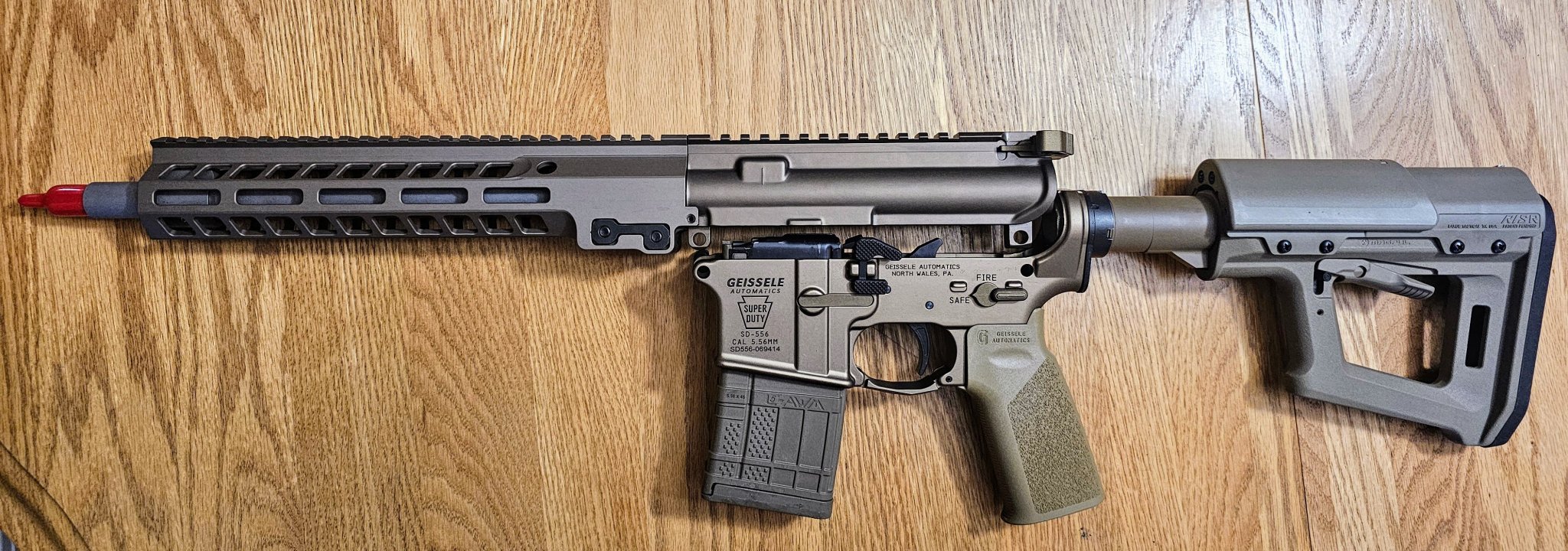

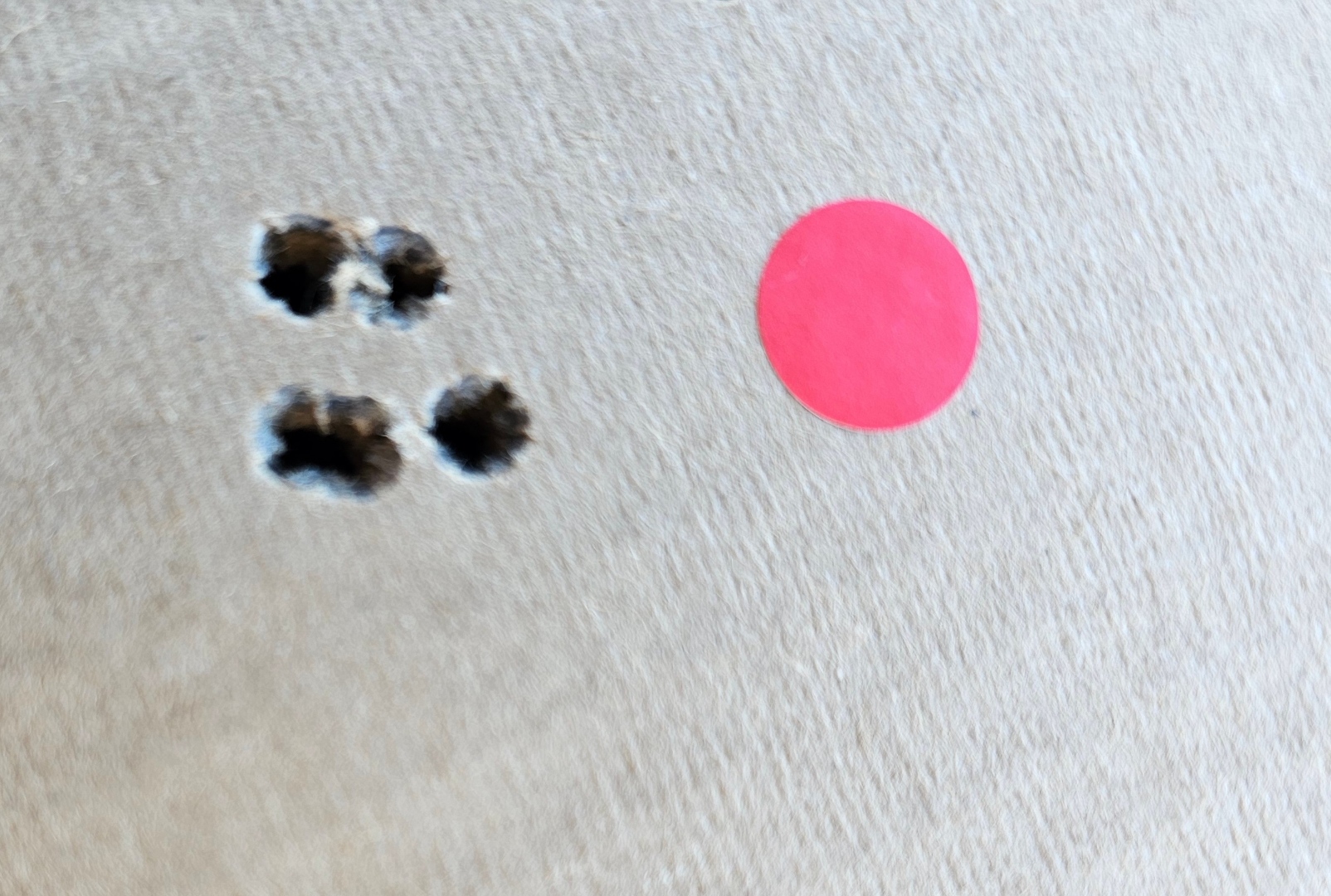

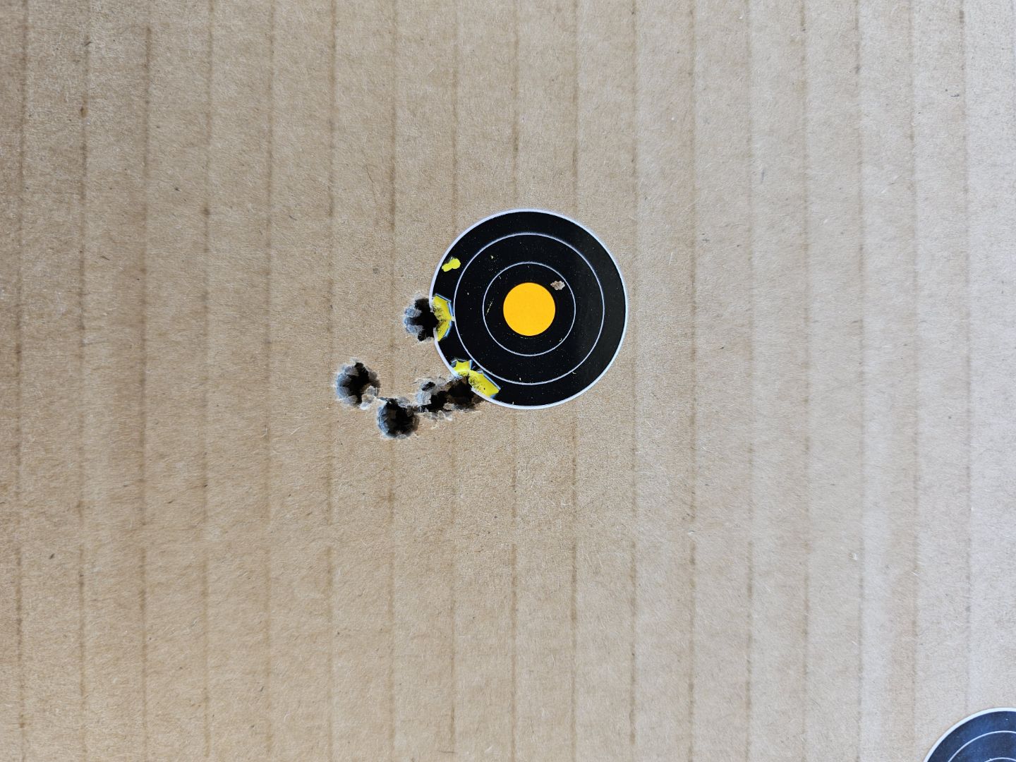

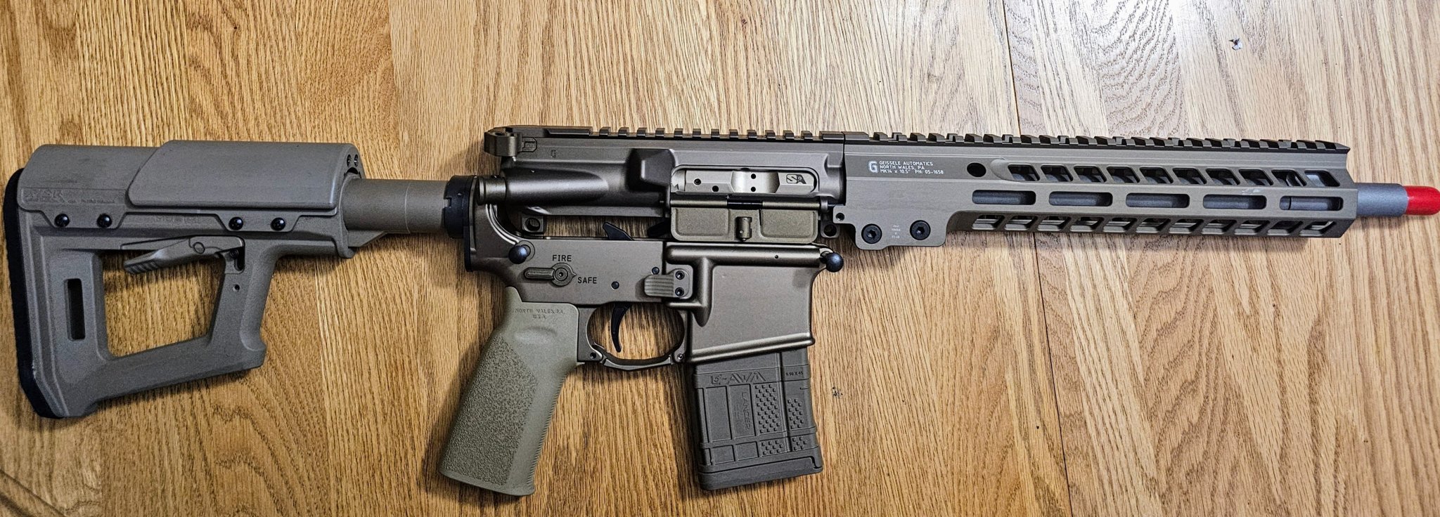

I've did 2 Custom builds with Noveske barrels last month, thier barrels are very accurate usually between .5-.75 MOA.
Here's one example, 12.5" Mid Gassed Noveske barrel for what is ultimately a SBR build using a V-Seven Titanium fixed Gas Block. I test fired the upper on a pistol Lower, fired two 5 shot groups and packed it up. The barrel is perfectly gassed, no need for a AGB with Geissele H2 Buffer and braided spring.
If you're still hell bent and replacing the Noveske barrel then do it.
Buy whatever barrel smokes your shorts, I'm getting Sub Half MOA with the new Heavy Contour Geissele Barrels (See thread, SOLGW/Geissele Build) pull the Veske and put it to the side. If you decide to sell the Noveske rifle pull the the new barrel and reinstall the old Noveske...simple
