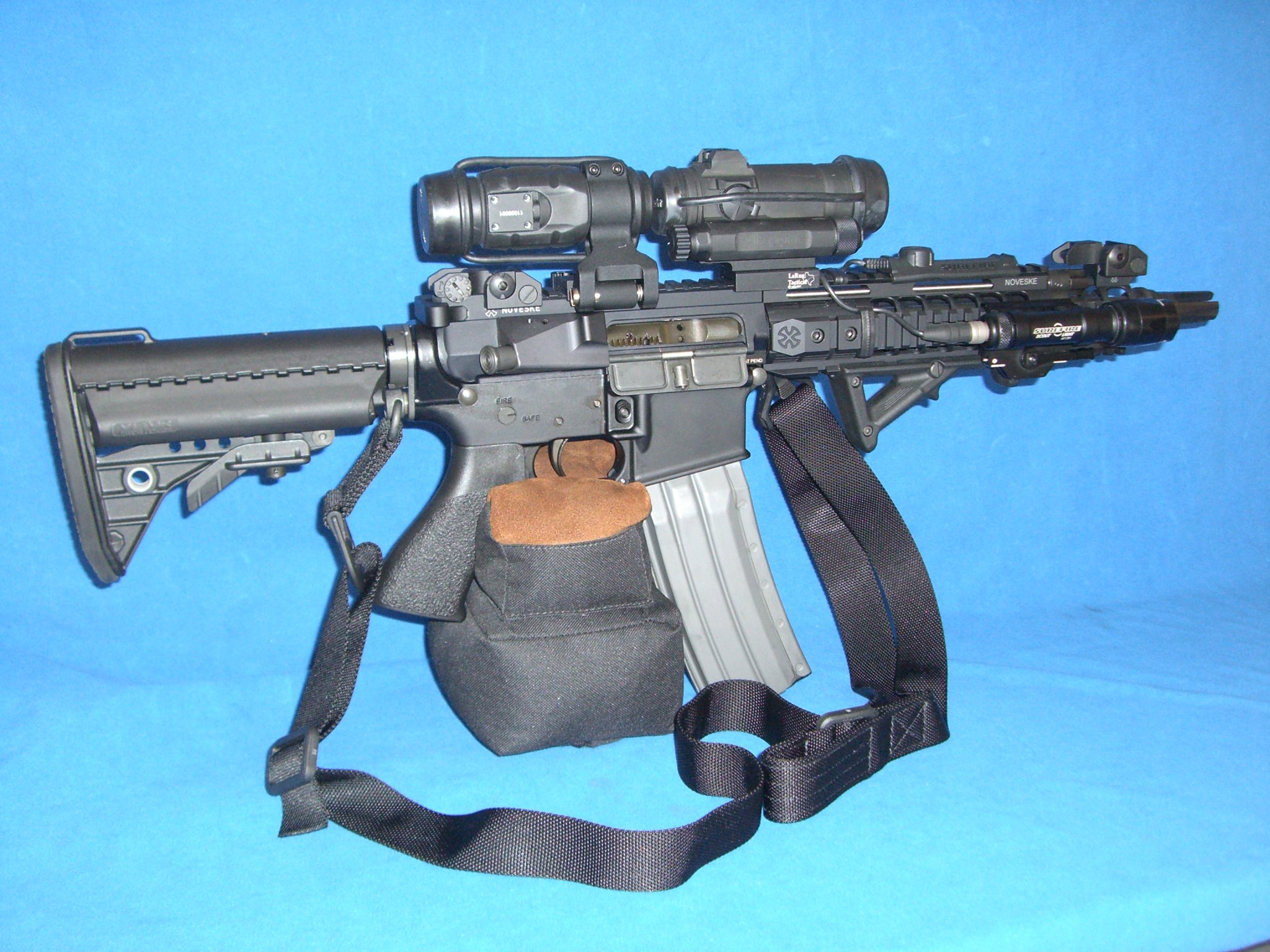

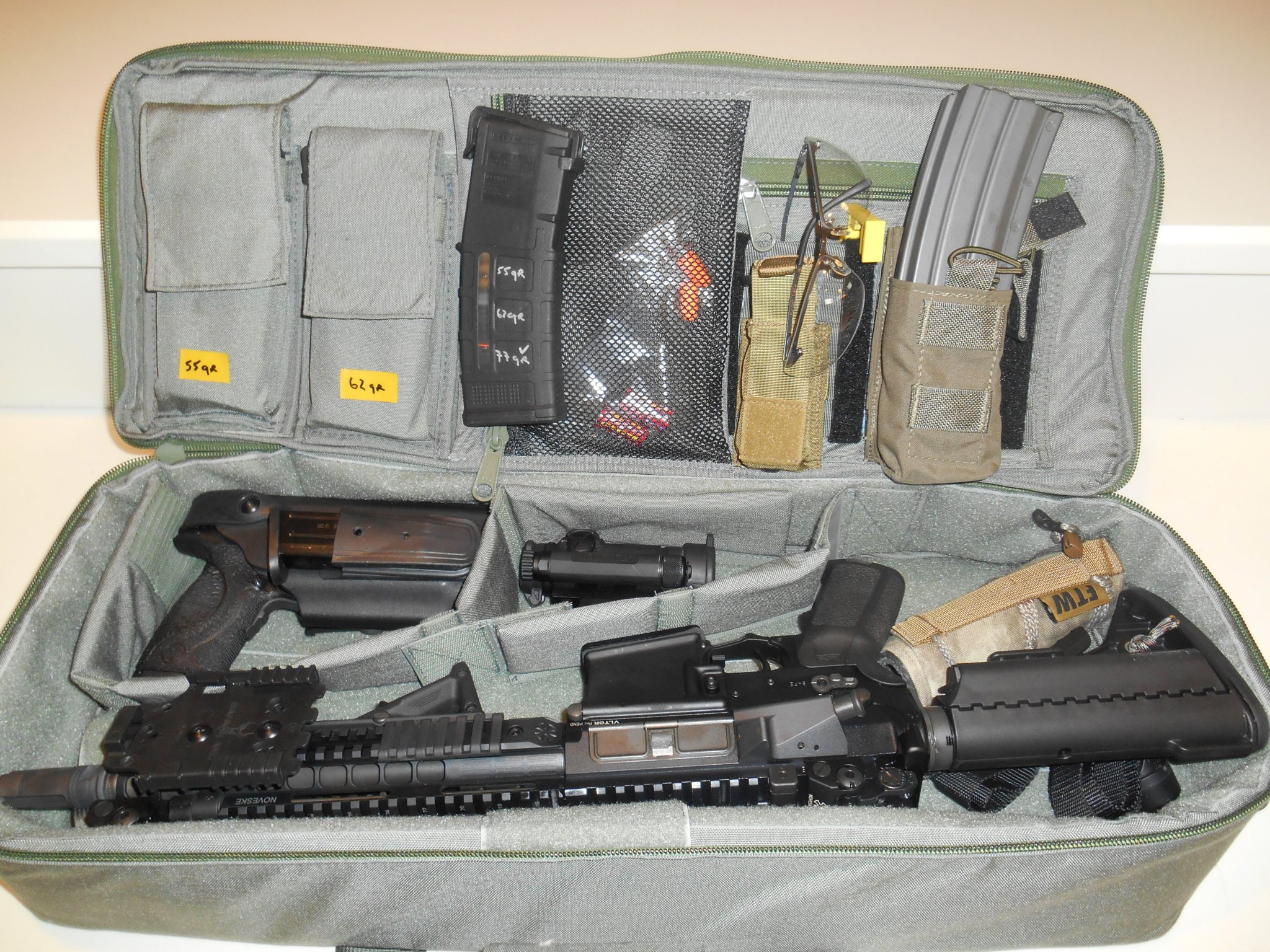

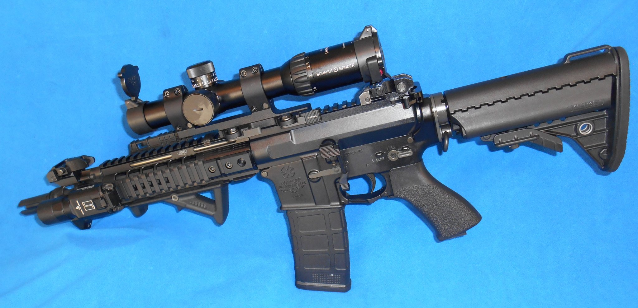

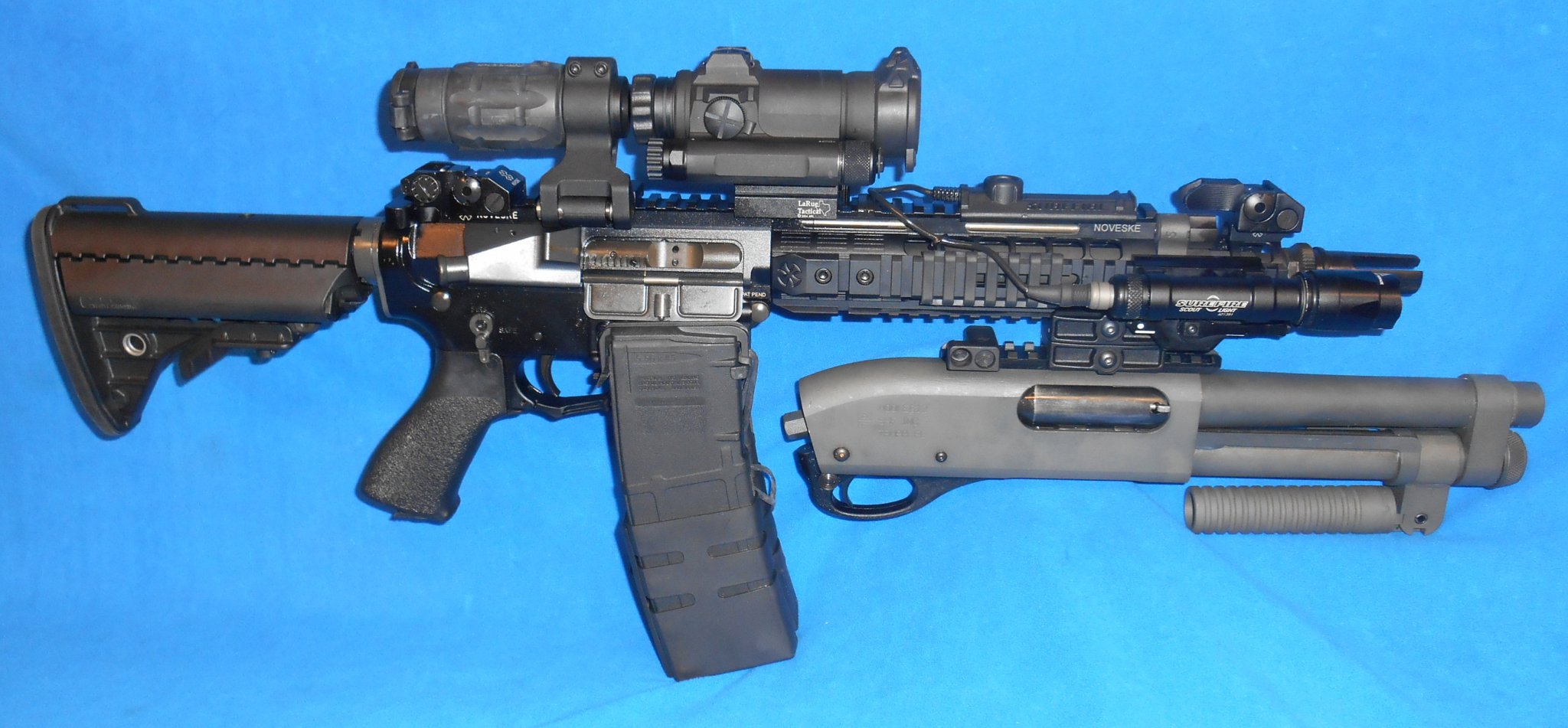

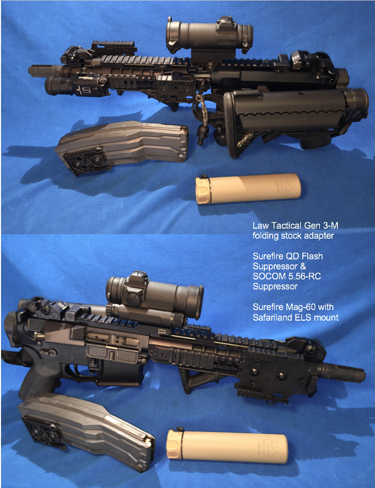

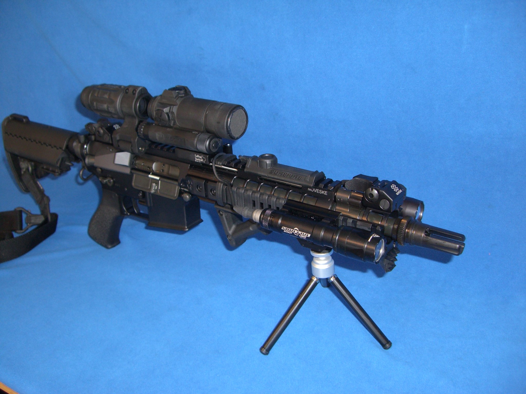

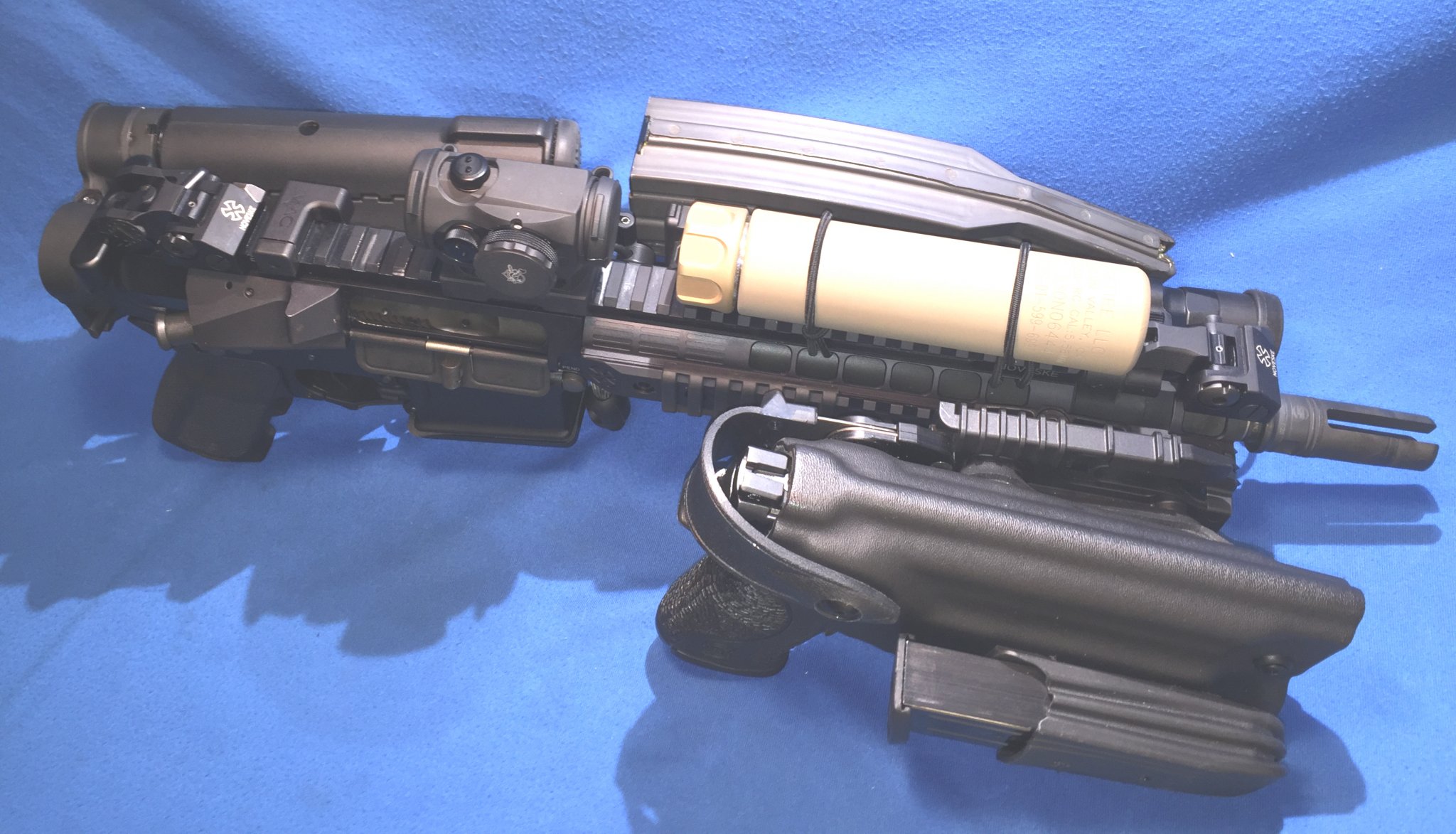

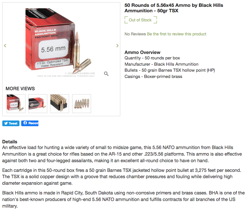

I have this Noveske N4 10.5" SBR that I set up as a grab-and-go package either open or in a LaRue Covert soft case bag, which are nice and
easy to configure for accessories. The Black Hills TSX 50 gr were developed for the 5.56 short barrels. Use a Aimpoint M4S red dot w/ magnifer or a S&B Short Dot 1.1-4X as well. Just for fun, IF door knocking were necessary, configured it in a Master-Key as well.

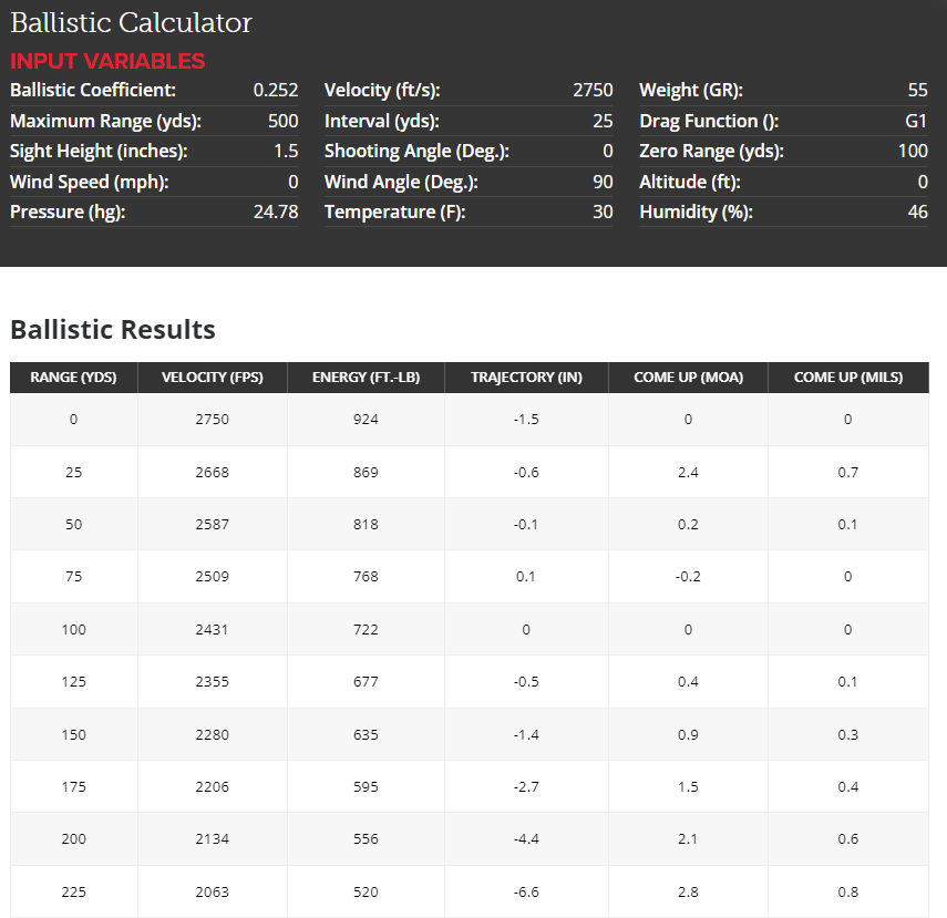

Based on what I'm seeing, xm193 goes 2750 fps from a 10.5" barrel with 927 ft*lb of energy, which is sufficient velocity and energy for cavitation.
Seems like arguments on when cavitation goes away is between 1800 and 2300 fps and 800 ft*lb of energy.
Also seeing that 2400 to 2500 fps is sufficient for the xm193 to fragment.
There is probably better ammo out there as well, but I don't want to spend $$$$ on mass quantities of it in this market.
Sounds like the 10.5" minimum barrel is a safe bet. Just to add a little more diversity (which is a good thing these days), an 8" BLK and 12.5" 5.56 would pair nicely with the 14.5" I have.

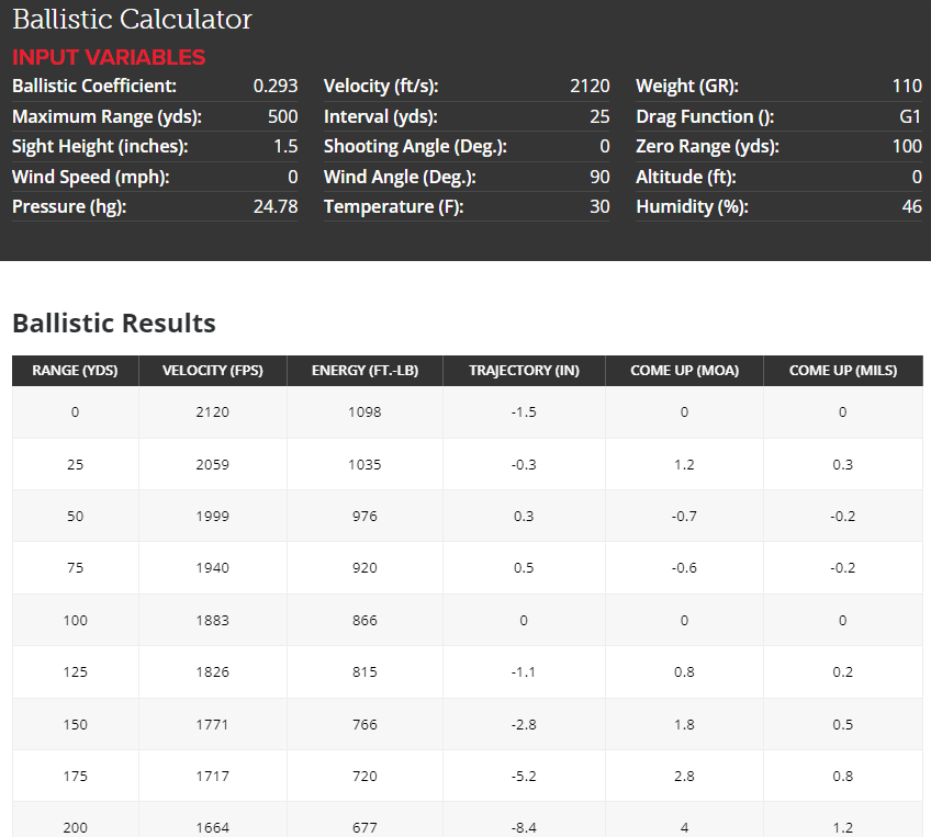

Data for the 300 BLK 110 Varmageddon doesn't look terribly promising at distance when comparing to the criteria I mentioned above.
Max effective range somewhere around 125?

....max "range" isn't the same as "max effective range". The aspect you should consider is what the energy number at specific range is for a caliber out of a particular barrel length....higher energy numbers induce more effective results on game or other fleshy threats.
...you can use a ballistics calculator like JBM ( https://www.jbmballistics.com/ballistics/calculators/calculators.shtml ) to run the numbers to get an idea of the difference between calibers, but don't just look at the distances a particular caliber is capable of, that in itself is meaningless. Example: a 9mm out of a pistol can reach out to a very long distance, but once it gets to that max distance, it may not even be able to penetrate a piece of paper and possibly bounce off it...
Agreed. I missed the word effective in my post.
Check out the velocity and energy info I posted above for 300 BLK and 5.56 - posts 9 & 11.
