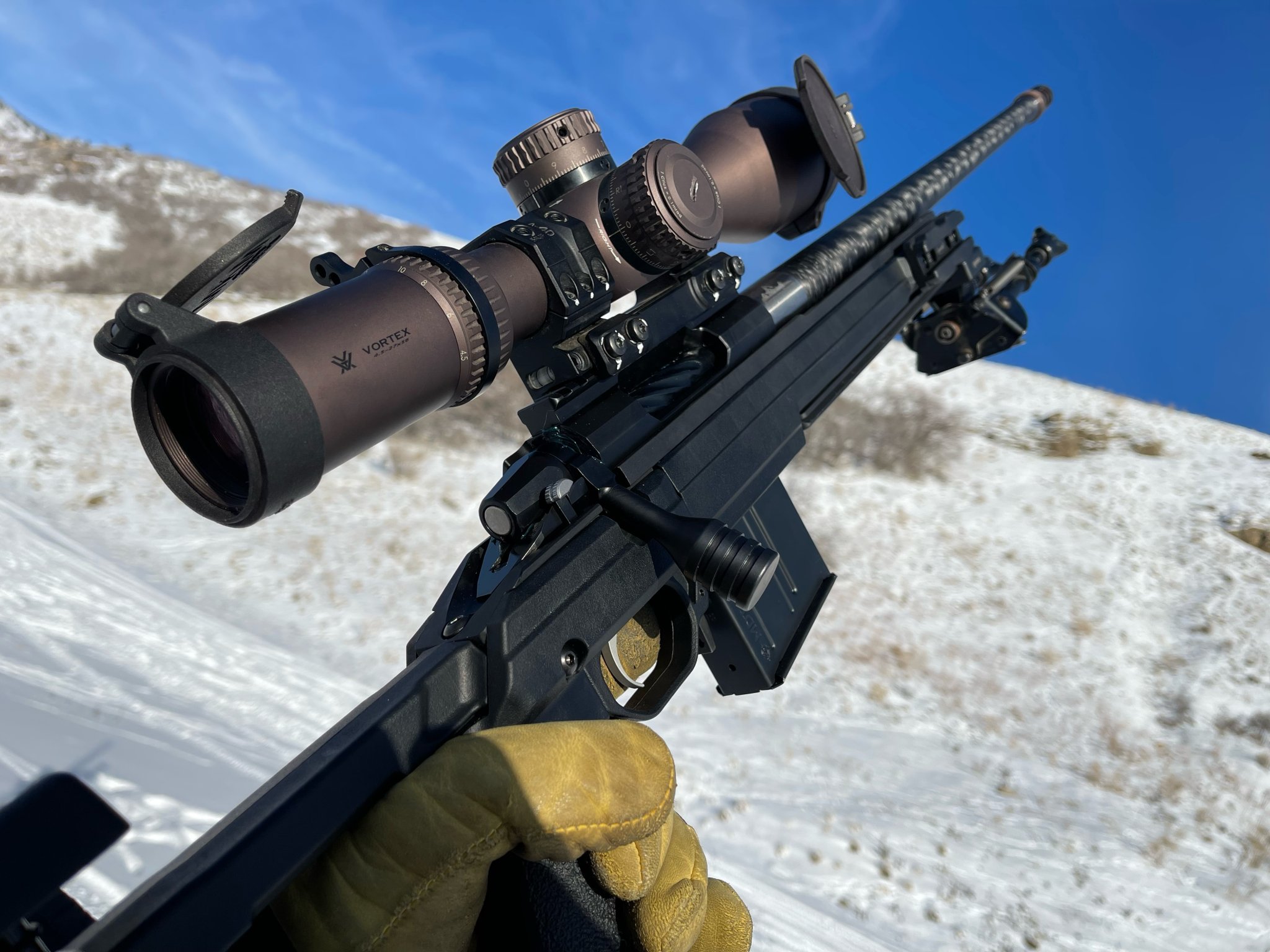

Sub 12 lbs.
Manners lrh
Vortex lht 4.5x22
Mdt ckye pod lite or triple pull whatever I can I guess…
25 creed to squeak into power factor
Carbon 24” barrel. Haven’t decided on which break yet.
What action? This will also act as a rifle for the kids in a different chassis.
