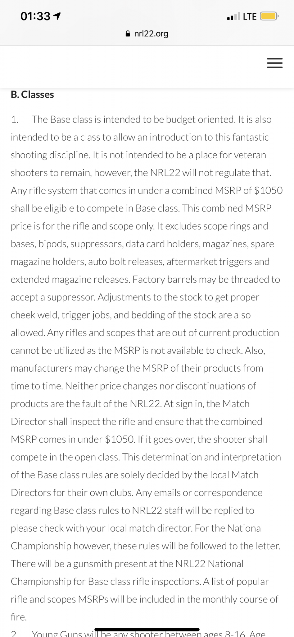

So I am reading the base rifle rules and it now says trigger job allowed. Does this mean I can only work the trigger over or can I run a timney? I am going shoot my first nrl22 match at a local range at the end of this month.

Few things:
1: if you’re not going to nationals, it’s 100% up to local MD
2: the rules (at least the ones I read, see pic) mention the $1050 doesn’t include “aftermarket triggers” in that price. So, I’d interpret that as it wouldn’t be mentioned if it weren’t allowed. Why say aftermarket triggers are not included in the pricing if they aren’t allowed?
So, I’d say you are g2g. If you’re planning on attending the national championship, then you may want to contact nrl and clarify that.
If you’re just going to shoot the local match, it’s up to the local MD to make the determination.
Per the rules and clarification by the NRL22 owners.
Trigger mods and drop in triggers are legal in base class.
Reason? They did not want to be taking apart rifles prior to matches to determine class legality. To difficult and potential for problems to police this rule.
The way we run our matches you can polish and change springs if you change hammer, disconecter, or trigger you are in open class.
Which is fine for the local MD to regulate.
However, you will be taking away an option that is allowed at the national match.
Club members complained about the equipment race. We fixed that you change parts you shoot in open class. No more complaints what is done at the nationals is up to them.
Edit Specifying a minimum trigger pull weight in base class will solve that problem. Who cares who's trigger it is as long as it makes weight.
I would prefer that NRL set some definitive rules. The way it is now it is too confusing, too vague.
I will abide by whatever the rules are, they just need to be more concrete.
Had a discussion today with our NRL rep, he too is confused, and there is much confusion as to the August COF. Something to due with stating 2 different size steel targets for one of the stages. Even the powers to be have no idea, so......what to do?
The rules always defer to the local MD.
So, basically, when there is a discrepancy like that, the local MD just makes a judgment call.
Pretty simple. And it’s not a big deal. Especially for the low costs.
