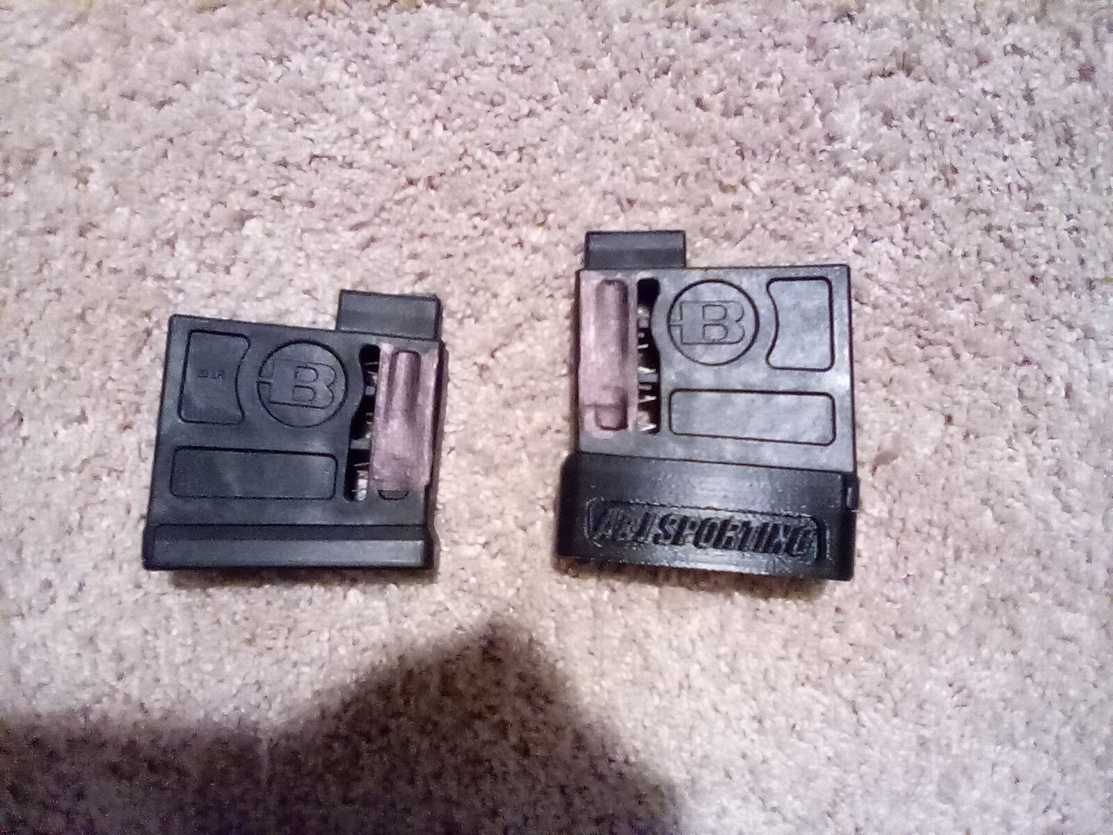

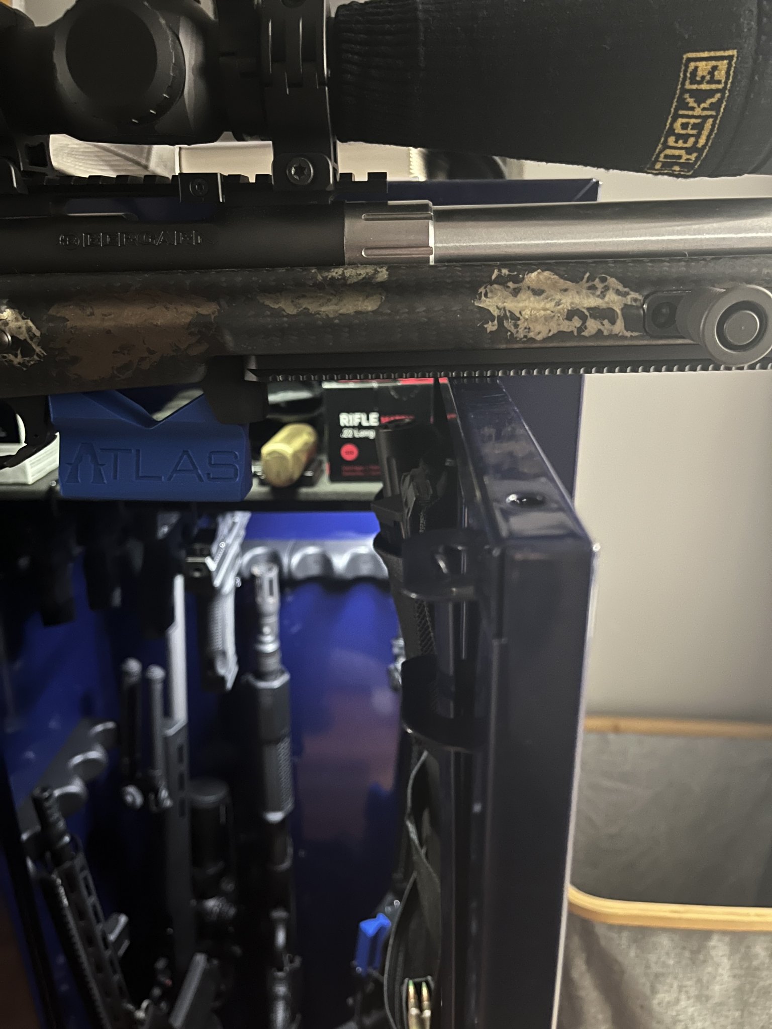

Purchased a second mag with extension plate for the 12 round stages.
Put 5 layers of painters tape on the front face of the magazine and black markered it. Now it fits like a glove, and no matter how I put pressure on the magazine, it cycled the snap caps 100%.
A cheap and potentially helpful mod for positional shooting.
I'll let you know how it works under the stress of time and friendly competition.
YMMV, happy shooting

Shot about 225 rounds total for break in. One case didn’t spit out but I purposely pulled the bolt back slow. The ghetto tape job on the front of the mag worked 100%. No cold bore shift.

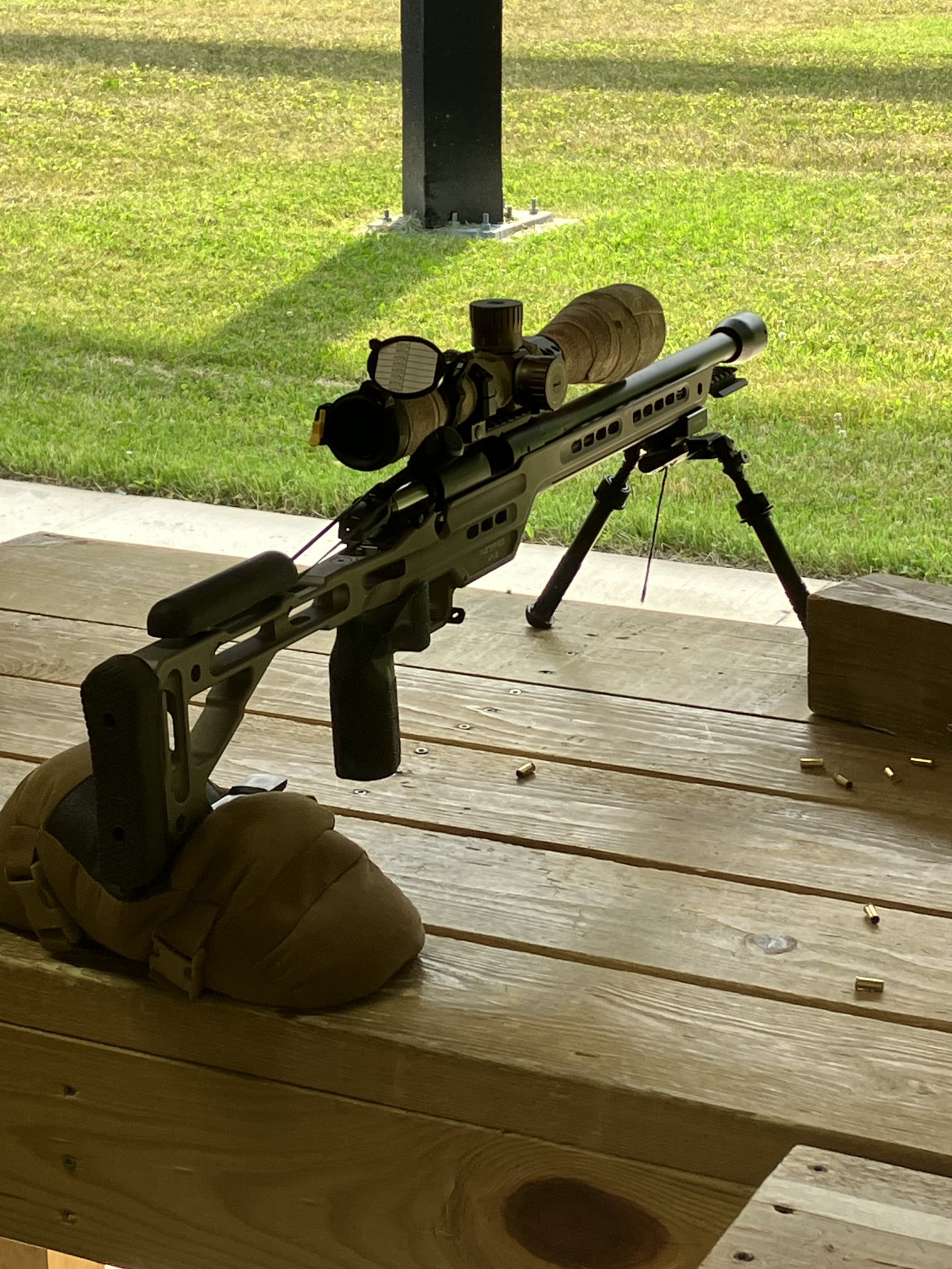

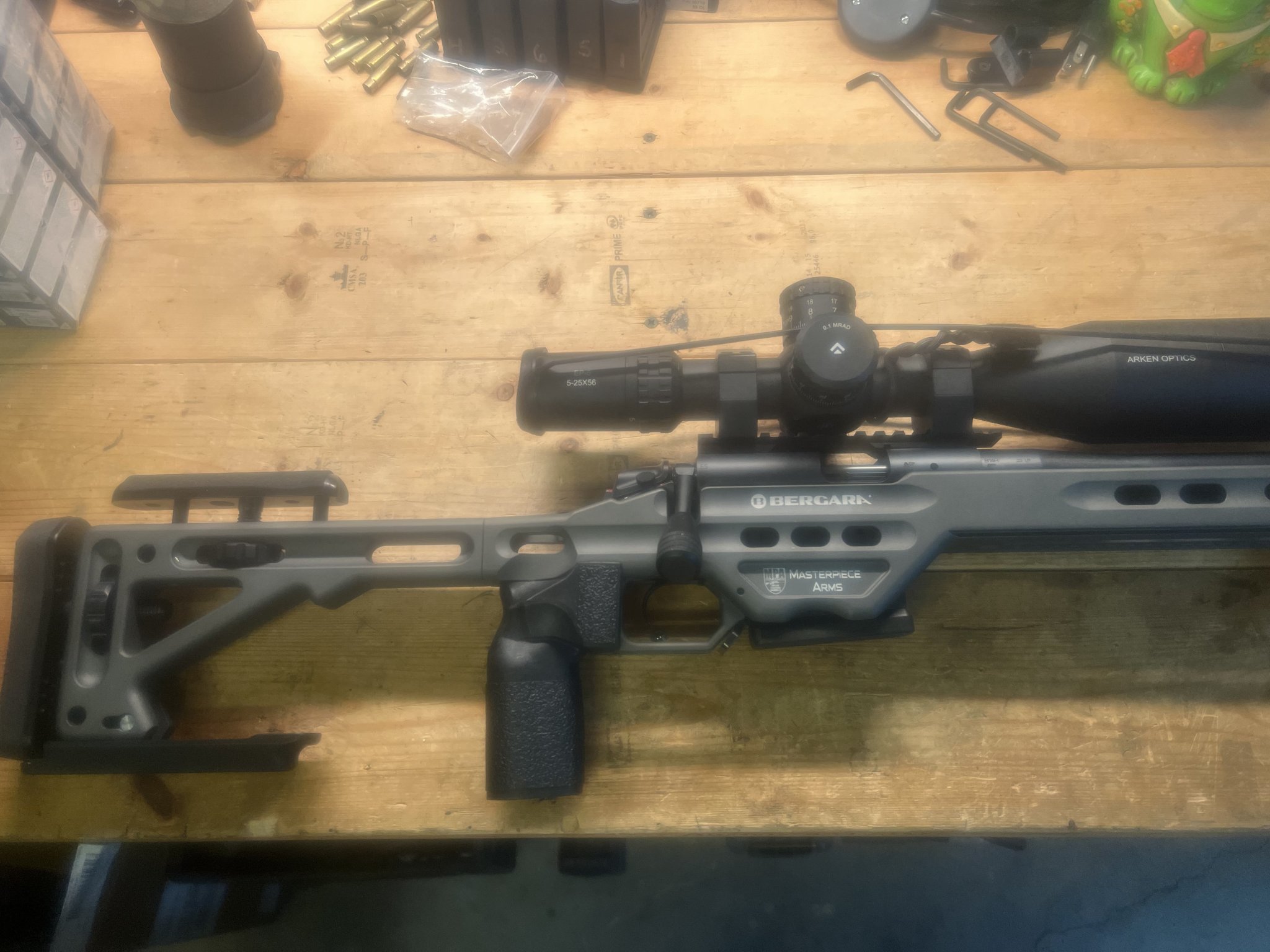

Bottom line, I love the B14r and MPA Hybrid. It’s very stable, much easier to shoot compared to my base class rifle and shoots a variety of ammo well.
I think I’m going to like moving up to open class.

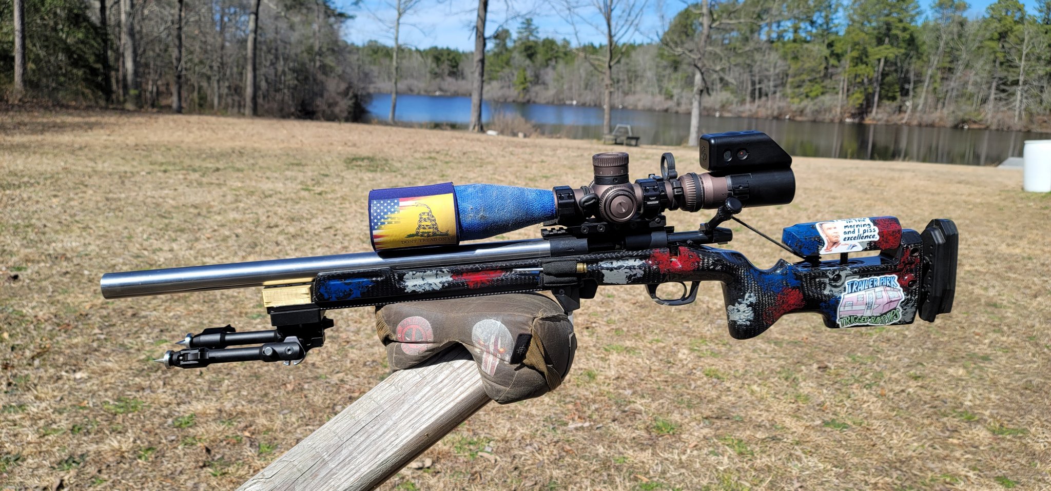

Additional testing and observations:

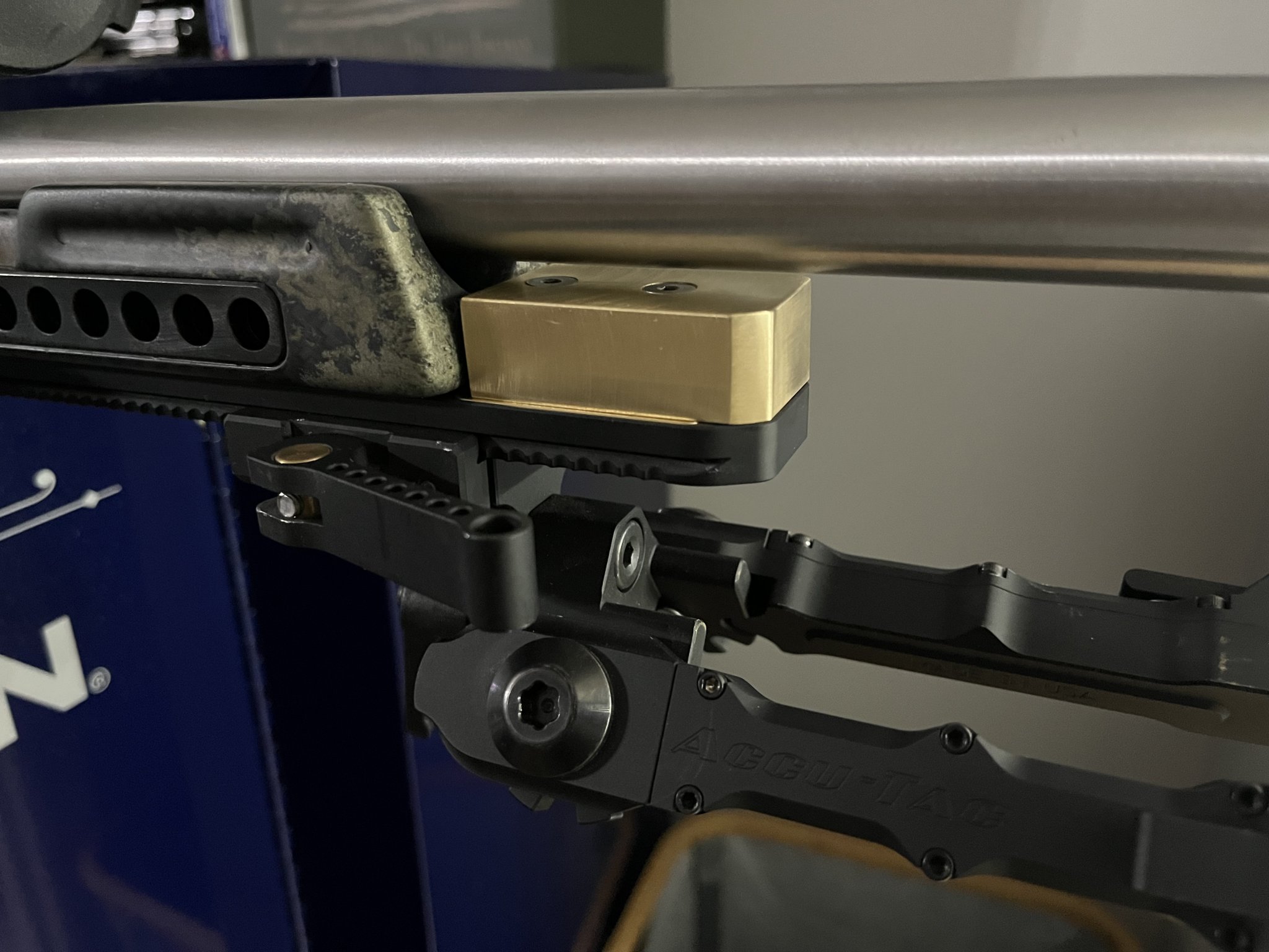

1. The spigot mount is interesting. It provides a geometric advantage by placing the bipod further ahead and closer to the bore axis but there is definitely flex in the system. It likes a very light cheek weld, otherwise my heart beat is transmitted and induced a bobble. Solution was to move the bipod to the chassis arca rail. Much more solid purchase and no heart beat bobble.
2. After bolt disassembly and cleaning, the bolt lift and chambering is much smoother with less effort. The bolt now runs very smooth and it tries to partially feed a round from the magazine if the rifle is not held level during position changes. Possible solution: I’ve attached a rubber band from the base of the bolt knob to the front post of the cheek riser. I’ll have to check its function while practicing on props.

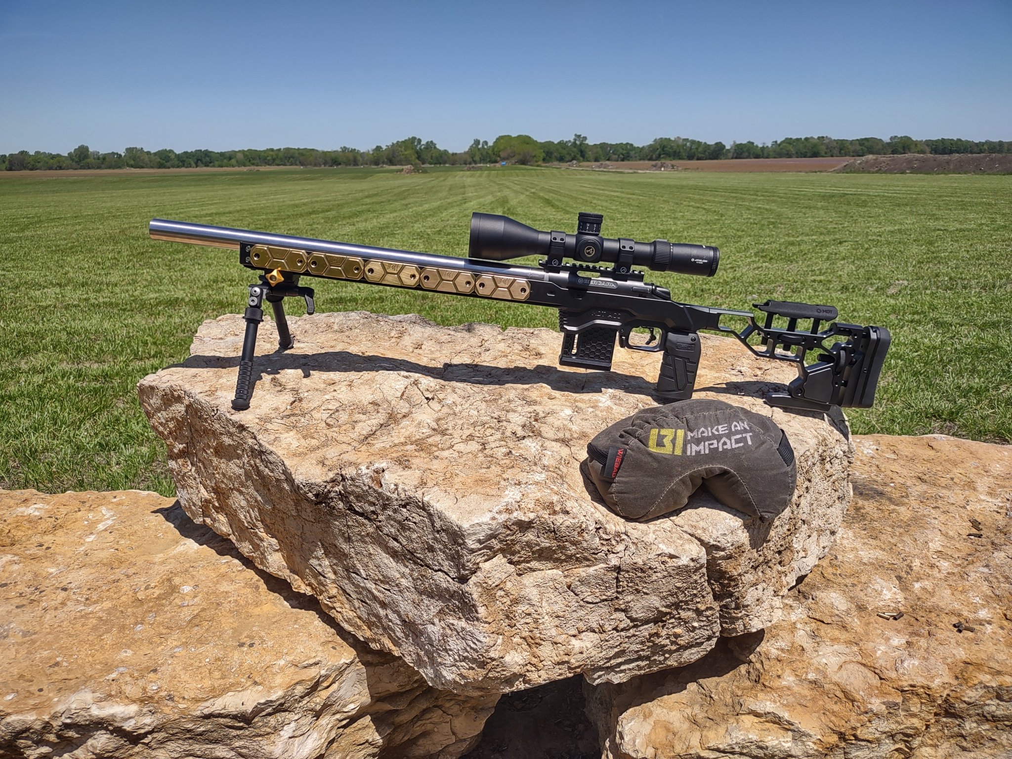

3. Cherry picked group, but with the right winds, good lot of ammo, and a lot of luck, I was pleased to see this 5 round group at 100y.
YMMV, happy shooting.
Reactions: stevieb92

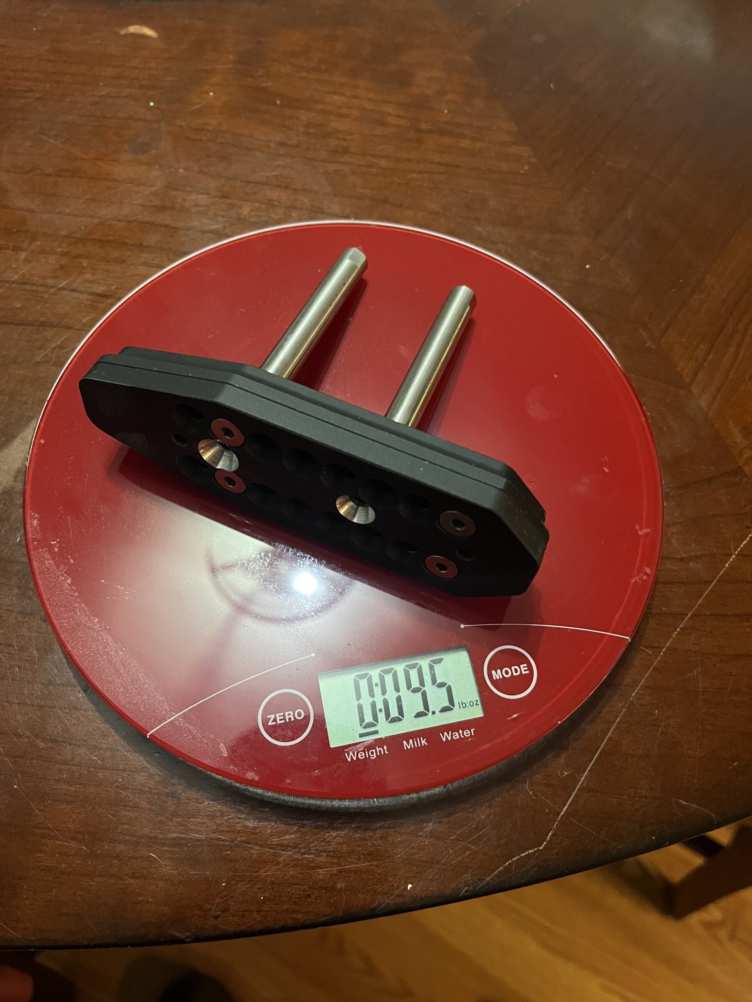

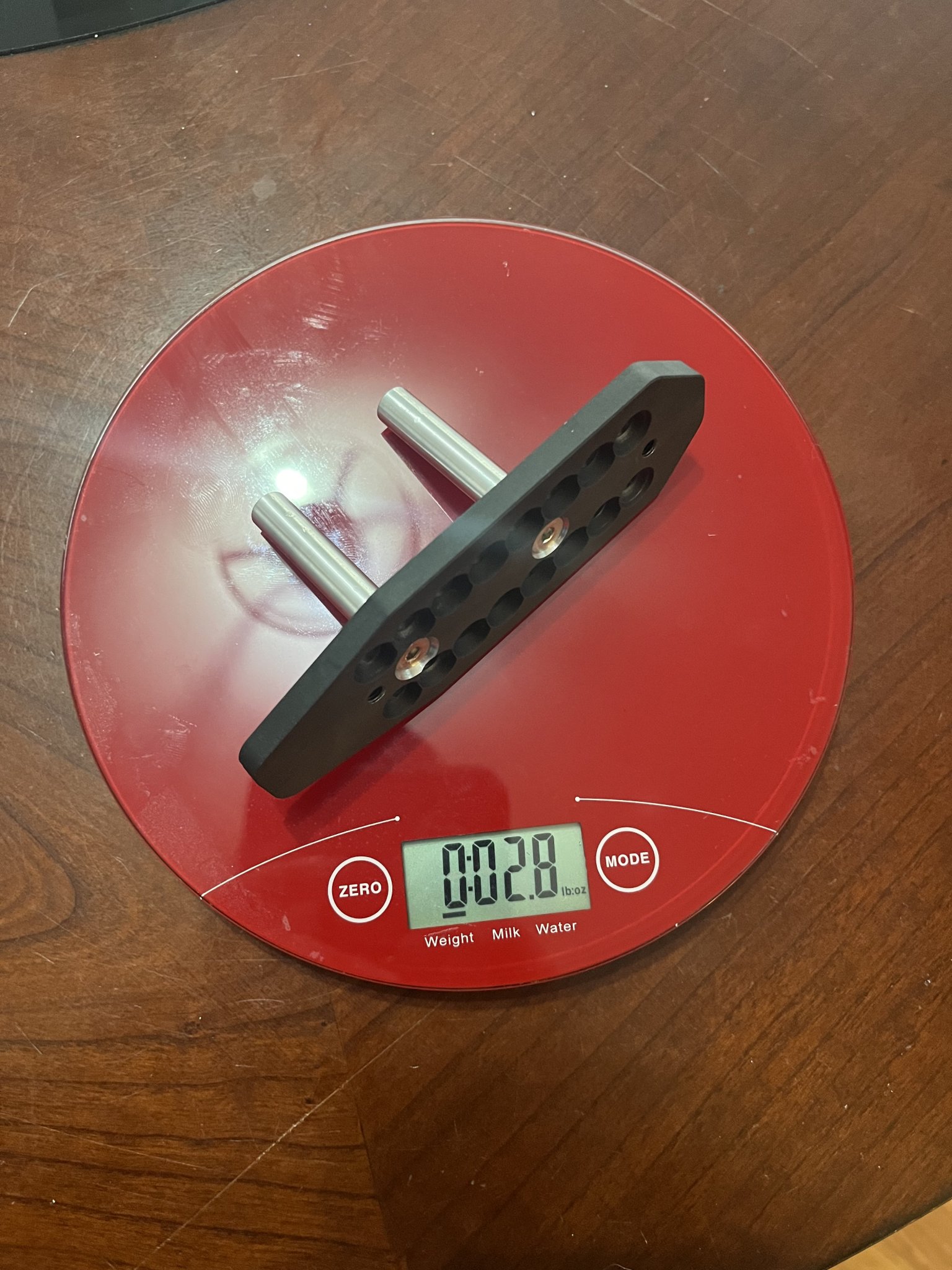

Nice shooting and beautiful rifle! I've had several MPA BA Comp chassis over the years and noticed flex in the system when shooting on a bipod mounted to their spigot mount. I narrowed it down to the aluminum spigot mount. Then I found out they have a steel version of the spigot. I've upgraded all my aluminum spigots to the steel version and then when I recently switched to the MPA Matrix Pro chassis it came from the factory with the steel version so I've got one steel looking for a home. If yours is aluminum, I highly recommend the steel version of the spigot mount.
Reactions: Mr. Wolf
Yes, my spigot is aluminum. The steel version not only will increase rigidity but also balance the rifle with my stock Bergara steel barrel.
Cheers,
Exactly. In general, the modulus of elasticity for steel is nearly 3X greater than aluminum. The weight increase is nice to help with the balance, but it isn't enough to completely balance the rifle.

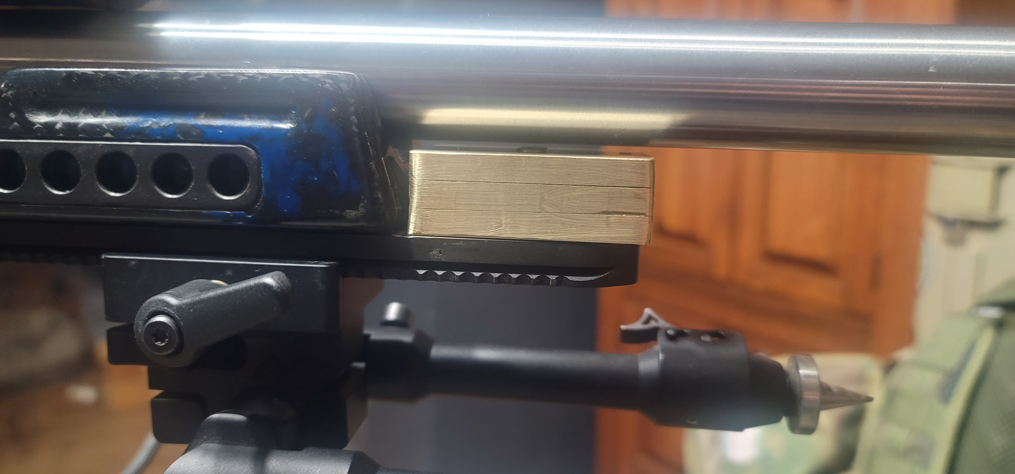

I've tried the xrs and xylo and both work well with the b14r.
Mdt xrs with the enclosed forend is pretty easy to balance (internal weight set forward and one set of external for me) and works well with bergara mags.
Xylo takes more weight to balance and I had to trim the mag catch a little.

I can't put any pressure on the mag or it won't feed well, but that's easy to remedy.
My mags have some slop in them so I tightened the set screws in the mag well and it didn’t help and caused issues. So slop it is. As long as things work, the slop doesn’t bother me. I don’t ever rest the gun on the mag anyway so matches haven’t been an issue.
I used painters tape on the front edge of the magazine to virtually eliminate the slop. Zero feed or eject issues during a PRS22 match last weekend.
Aluminum tape in the front edge of the mag well may be an option as well.
