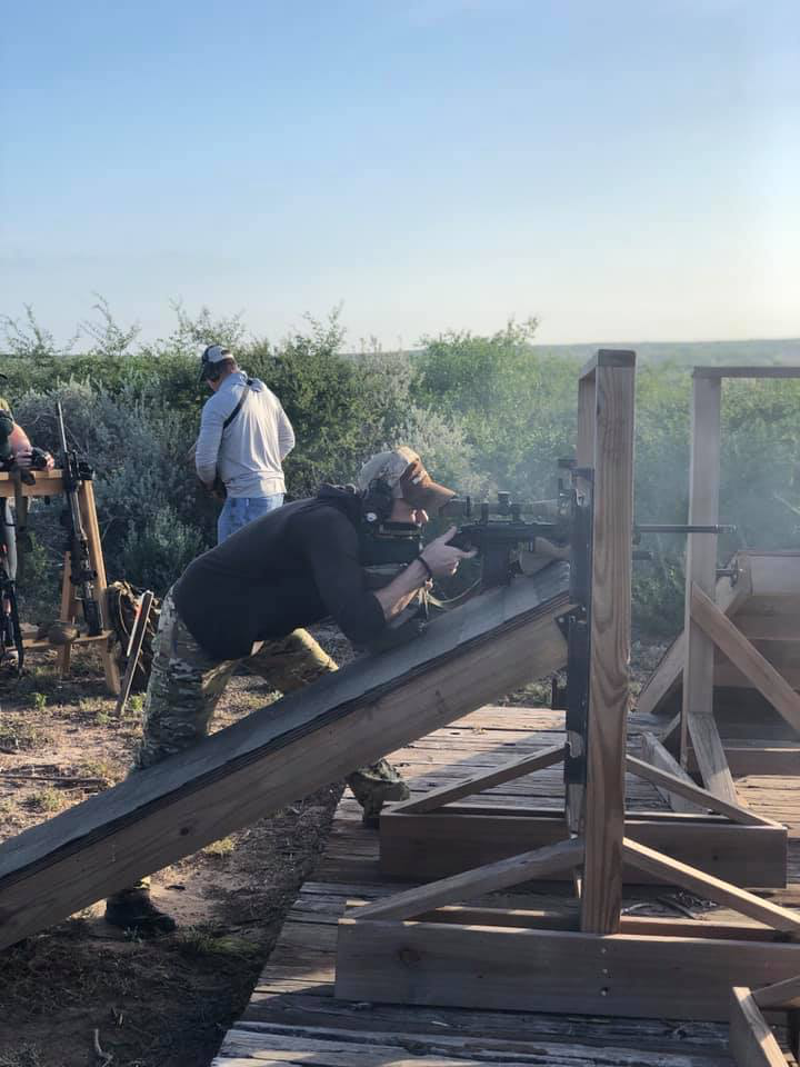

I’ve got the budget approved and need some help with the plan for a roof top barricade similar to the pyramid (broken down Barney style).
If you’ve build one, have the plans etc I’d appreciate it. I’m not carpenter but can follow directions.
While it's not plans, here's pic of a good idea. I always suggest making props modular. As in, you can change the configuration around. Helps from your stages and CoF's becoming stale and predictable.
In this design, you can change the slope of the roof pretty fast.
4x8 wooden platform and secure it to a wooden saw horse that's 36" tall. easy enough to do and use for all sorts of things.
If using the hinged sawhorse brackets make a spacer to keep the legs spread when in position. We've had a few near collapses when someone bumped something out of position prior to that fix. We'd use something better but is matter of storage space, has to go flat for us.
Reactions: USMC22
This is kind of the plan I’ve got for now with the same concerns.
