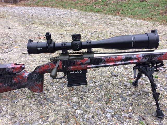

I only got into NRL22 in the last 6-8 months, but went thru a similar thought process to the OP this winter/spring.
I started out with a used CZ455 VPT in a Manner stock w/ a USO 5-25X scope. That combo was pretty functional from the get go once I added a A419 30MOA rail (compared to the 15MOA the previous owner had on it) so I could dial in more elevation.
The USO was fine, usable X-mas tree style reticle, not too cluttered, decent subtension marks, 10 yd minimum parallax, small center dot, and it worked for me for the NRL22 matches I shot this winter. But my first PRS22 match I shot they had us shooting beyond 300 yds, which was more than I could dial with the 30MOA rail. A set of Burris XTR Signature rings with the 20MOA inserts got me some more travel to dial about 22MILS of up, sufficient for ~400-ish yards with a 50 yd zero.
Over the winter I came up with a list of features I was looking for in a scope for NRL22/PRS22:
-FFP obviously and I prefer MILS bc that is what all of my shooting buddies use (so “hey, come up two clicks” actually meant 0.2MILS instead of the MOA equivalent…)
-A boatload of internal elevational travel (24-26MILS would be good) which pretty much meant I needed a 34mm scope body
-Big ass turret with at least 10MILS per rotation. Dialing up 14-16MILS for a target on a 6MIL/rotation turret means you’re cranking two full rotations plus some. Easy to get lost on where you are at.

Question, if I was to go with a 25 MOA DIP scope base and a 50mm objective, for those that have a setup similar to this would low rings work on the Tikka T1X or would I need medium? Thanks.
Was going to write the same thing as I have thousands of times before but then said nah. LOL Low and Medium are generic terms which are different from ring maker to ring maker.
While not a Tikka or DIP base here is a pic to give you an idea of a 50mm objective scope in 1" high rings. That barrel is heavier than the one on the Tikka and the base is a 20 MOA base and may be about .1" taller than the DIP.
