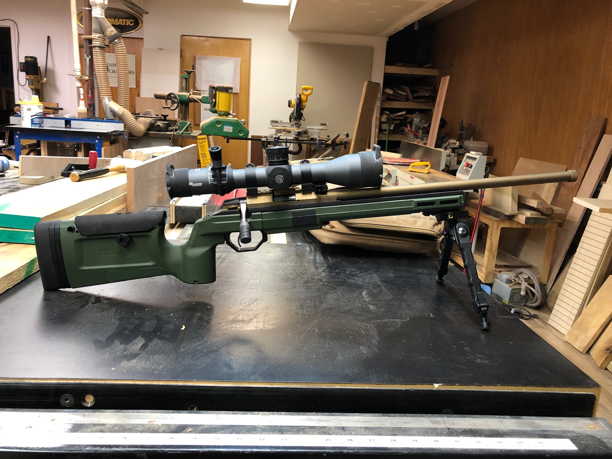

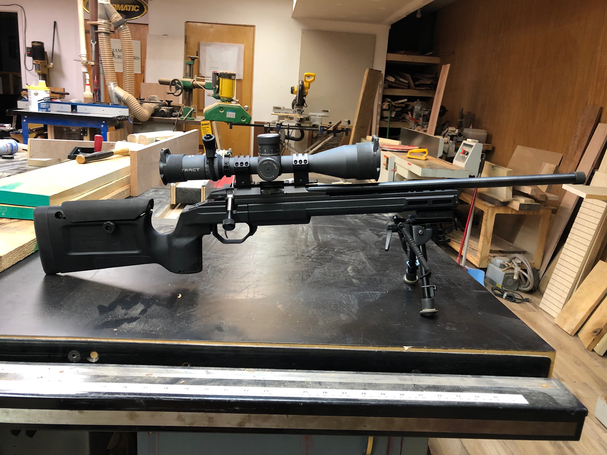

Here is my rifle and my sons. Both are Tikka T1x’s in a KRG Bravo. Mine (the green one has a 25 moa rail and a Sig Tango 6 4-24 x 50. You can’t tell n the photo but I have about 1/8” between the bell of the scope with the caps on and the barrel. If I get a heavier barrel I will need a higher set of rings. His has a Tract Toric HD 4-20x50 on it again with a 25 MOA rail.
Here is my rifle and my sons. Both are Tikka T1x’s in a KRG Bravo. Mine (the green one has a 25 moa rail and a Sig Tango 6 4-24 x 50. You can’t tell n the photo but I have about 1/8” between the bell of the scope with the caps on and the barrel. If I get a heavier barrel I will need a higher set of rings. His has a Tract Toric HD 4-20x50 on it again with a 25 MOA rail. View attachment 7124780View attachment 7124781
