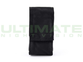

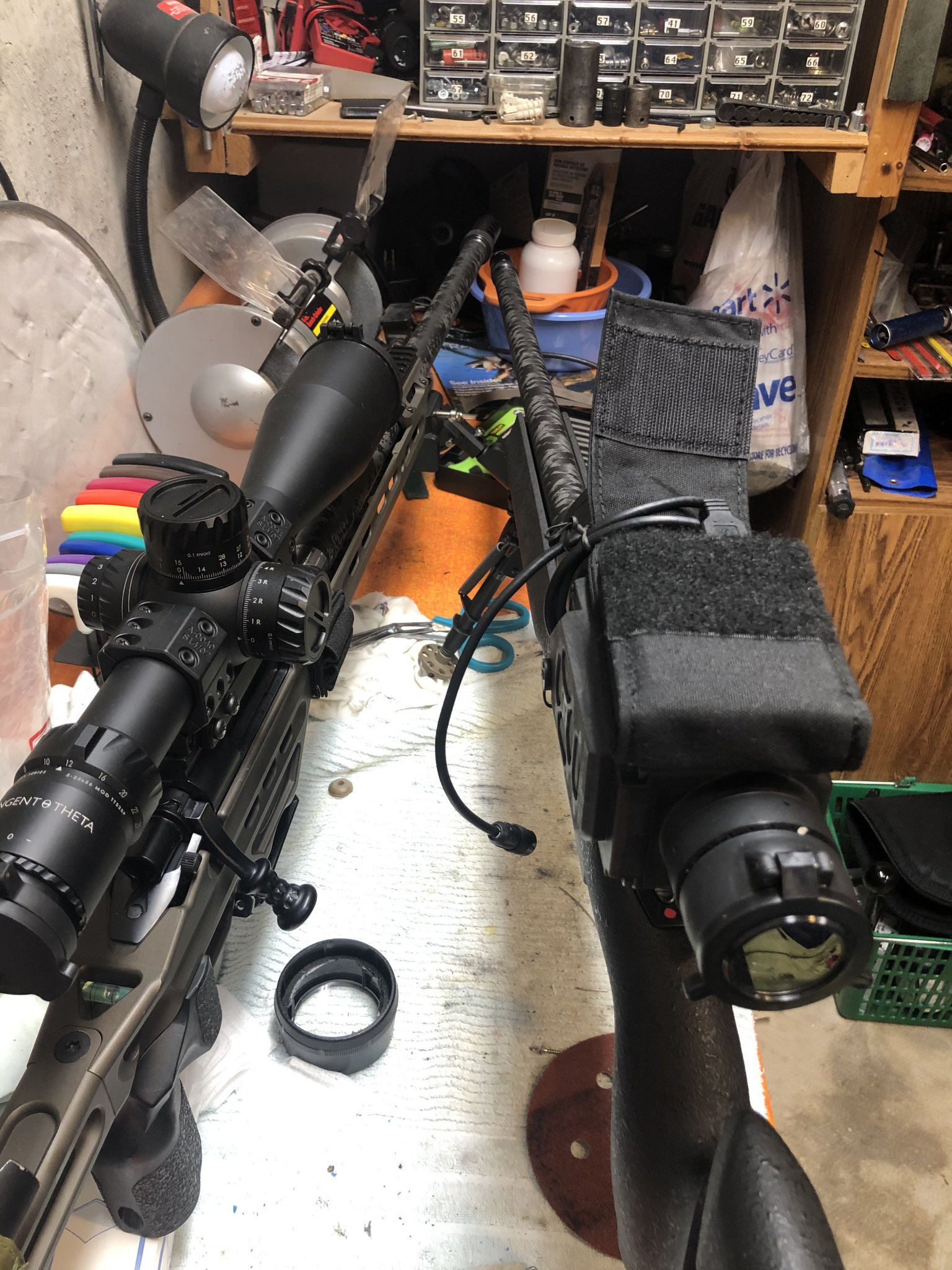

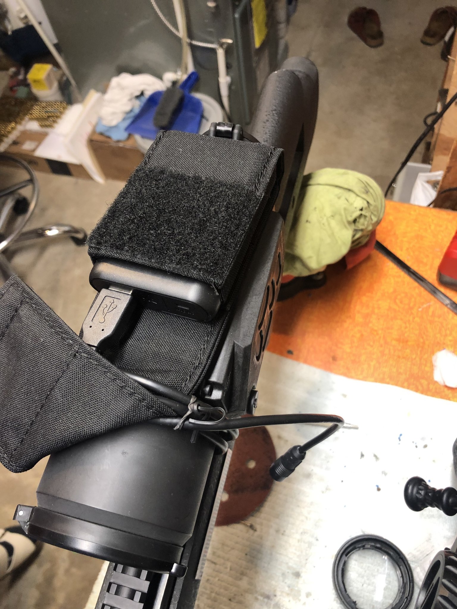

Here is the link Anker i run and pouch ? i will post link under where i got, i put some velcro on top of the HALO LR and thank thread valor to pouch so it stuck and won't come off the pouch. Slap battery and pouch on top of it no need for any other support. You can see my cable i wrapped around the unit thru Pouch opening, very stable won't move and it won't come off. You can take battery out recharge it and put it back on top of the unit. No need to take pouch off the unit, take battery out charge it and slide it back in. Works awesome and keeps everything together. This power pack will run HALO-LR 12+ hrs straight without powering unit off.
Not sure what you mean by flat spot.

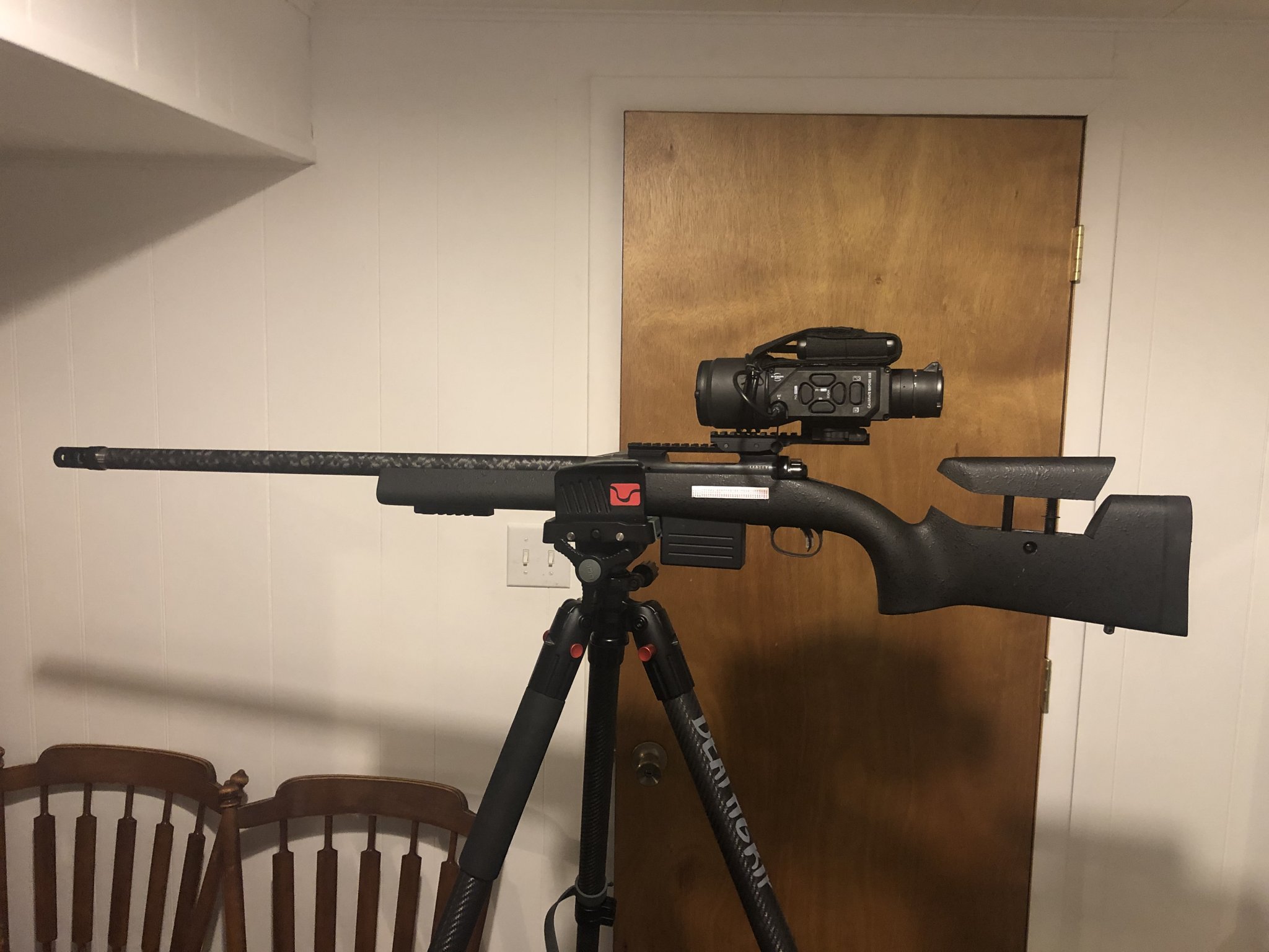

Thanks for the pics. The flat spot i was talking about is where you have your power supply and pouch mounted. Just trying to size the power supply to match it without hanging over.

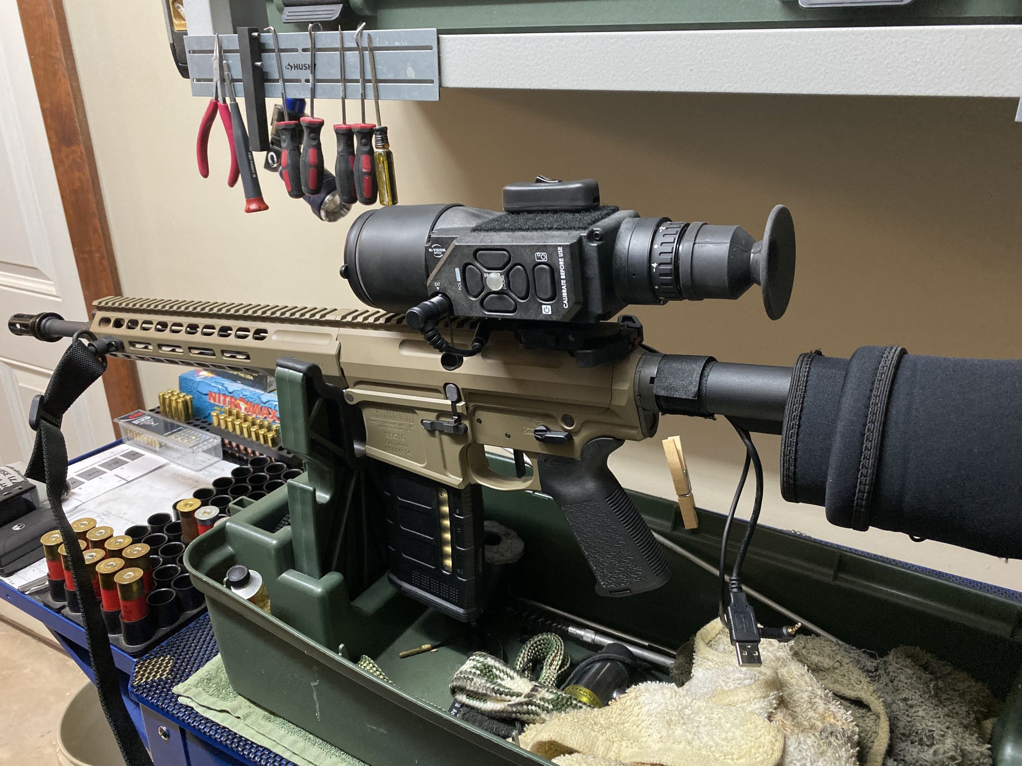

I use an Anker 6700 candy bar, runs all night. I used a neoprene elbow support on but stock to hold both battery & mdvr securely, did I mention cheap solution.
