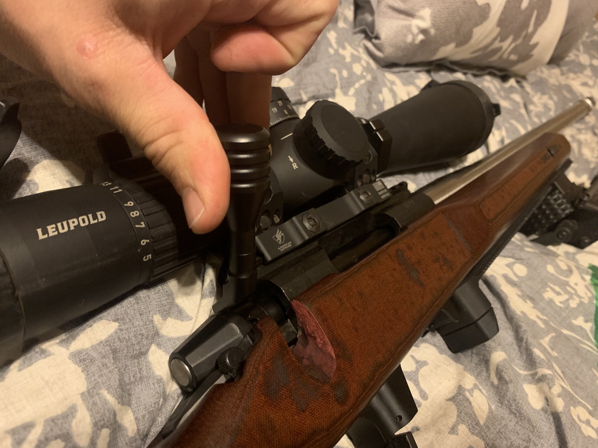

Hello all, I have an interesting issue.
I’ve been reloading for years now and have never run into this one.

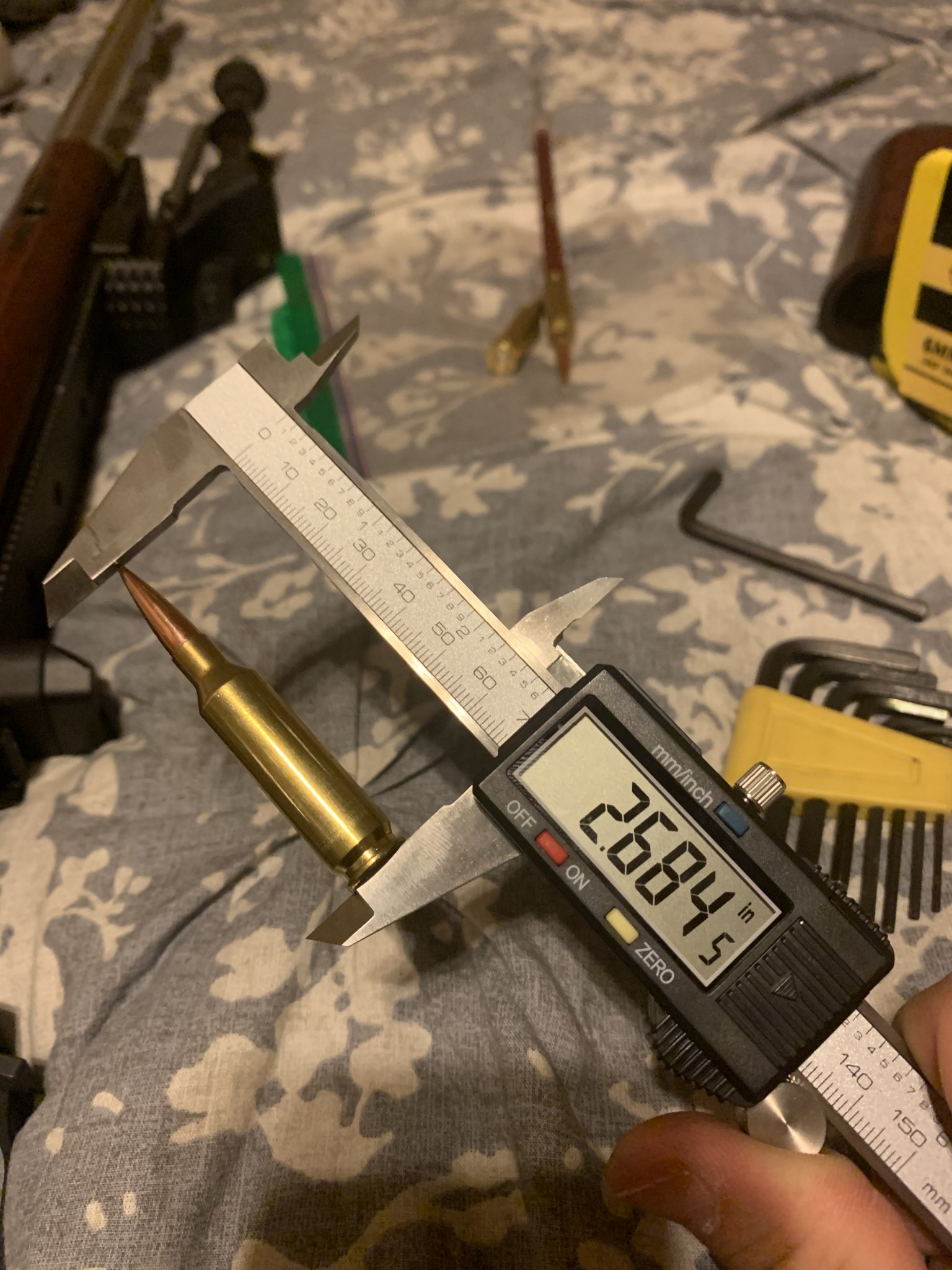

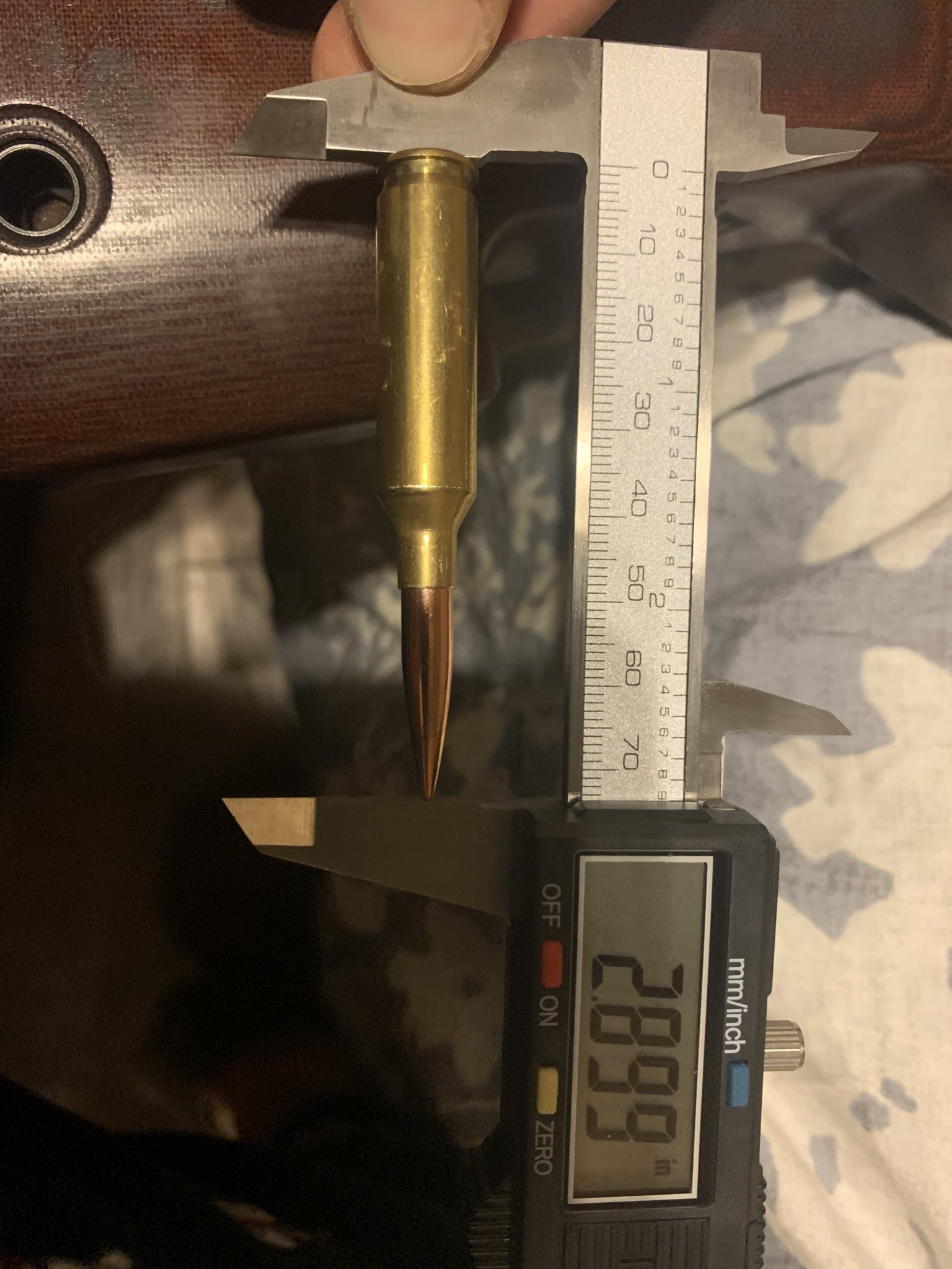

I have a 6mm C that seems to have drastically changed oal on me. I used to shoot it right around 2.80 from tip to ass and now I can’t get anything to chamber, even something as low as 2.58, which is so low that the bullet is barely even sitting in the case.
When I run my comparator in the same bullets I’m reloading I get a oal on the comp of about a 2.95 so I should have room... but the bolt handle literally will not press down and the bullet itself shows wear near the end of the nose like it’s made contact with the throat.
Any thoughts??
I have about 250 reloads through this set up - impact 737 action with bartlin barrel in a foundation.

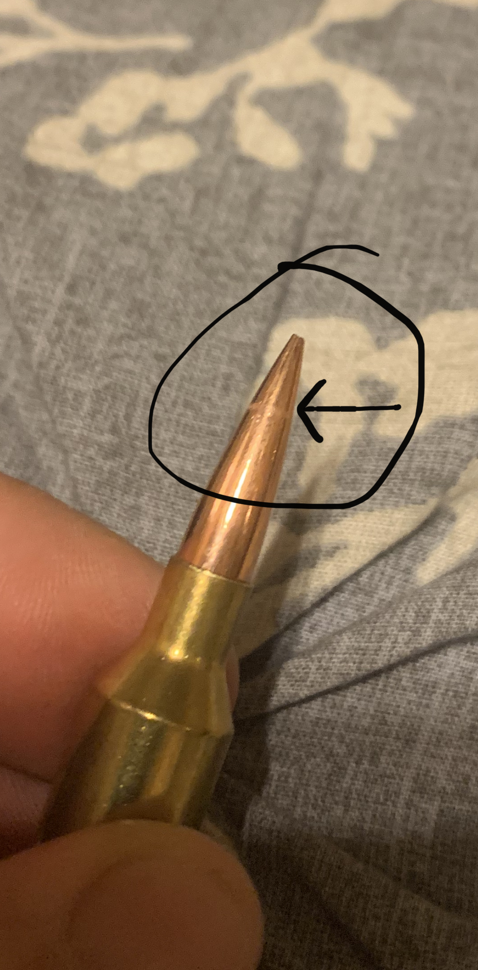

Pictures attached are coal, chafing on the end of the bullet where I believe it is making contact and the extent of my bolt travel with a round in
Strange that a ring would show up that far down the nose. How would the rest of the bullet fit if your chamber is that size? Speaking of which what is the measurement at the ring?
Carbon ring seems to be a popular diagnosis. Have you done a serious cleaning?
Bore scope it.
Im thinking maybe the bolt is some how over traveling? The fact that I can get the comparator to fit the round in but I can’t close the bolt on it..
Lol I have no idea, I can’t think of any reason why it wouldn’t chamber but would still take the comparator, just spitballing here. Idk if it could be a chamber/bolt issue. Stahp ?

The ring could be caused by a seating die maybe, what do your rounds look like before chambering. I'm assuming your sizing step is incorrect. Or your seater is crimping the case and pushing shoulders down on themselves.
Are all your problems on 1x fired brass, 2x fired brass? Is your primer fully seated?
Ding ding ding, winner.
That mark is from your seating die.
The nose will never touch the bore out that far. If it did you it would never shoot, just explode. Same as shooting a 30 cal bullet in a 22 barrel.

Good call on the marks on the bullet being from the seater, that was ?
Borescope wont be in till tomorrow, but it seems it is no longer necessary. I spent a fairly significant amount of time solvent cleaning and short stroking the chamber with a brass brush just encase it was a carbon ring and pulled out a bunch of carbon. I still don’t understand where the ring formed or why it was impacting my chambering the way it was. But I’m now able to fit 2.8” oal rounds again so I guess we’re good to go.
Thanks again for the feedback, feeling a little bit like a dumbass for not getting after it with solvent in the first place. but hey. You live and you learn. Thanks again all
