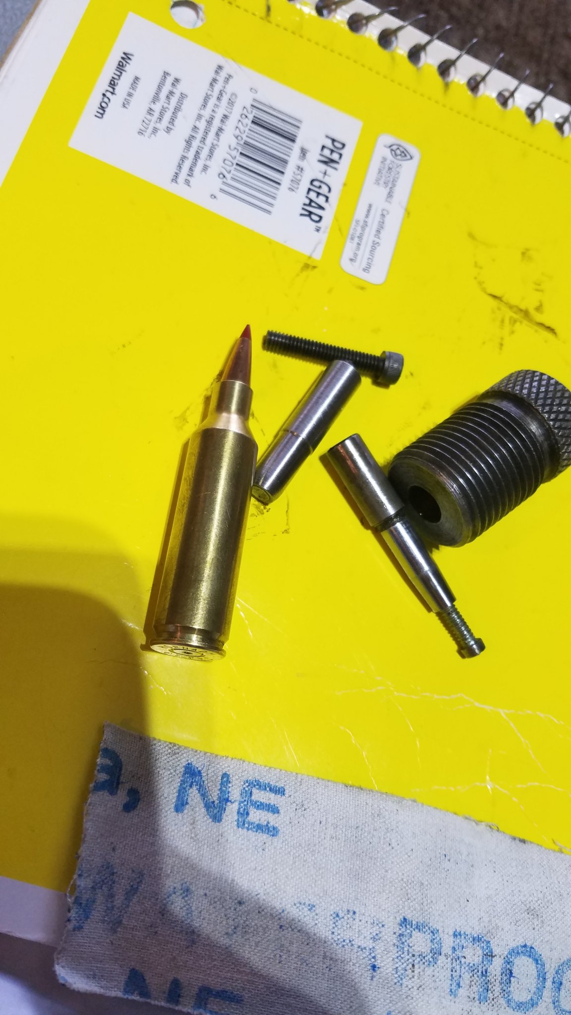

    I'll head out to the garage and see what I can scrounge up and turn into a mandrel.
    My K&M expander looks like a modified shoulder bolt turned into a mandrel...
    I chucked a bullet in the drill and lightly "reamed" it which actually worked but since it has the slits in it it's not very stable. I think running it over a 0.287 mandrel will be enough to account for the spring back, then if I need to I'll ream the necks.
    Success!!
    Turned a Mandel to .287 and tried it on a 6.5 necked to 7mm.
    The bullet slides in and out perfectly.
    Broke the 8-32 tap because I'm impatient.
    Oh well, it'll still do the job.
    It fits that K&M in the pic.
    If you need one made to fit the Sinclair with the flat, I can make a different one and add it. I'd just need to take some measurements off of it, unless I can find mine.
    When I tested it, I just lubed it and pressed it into place.
    I then put it in the press and pulled it out like I was pulling a bullet.
    You should only need it once, so gripping the fatter end with pliers won't make any difference.
