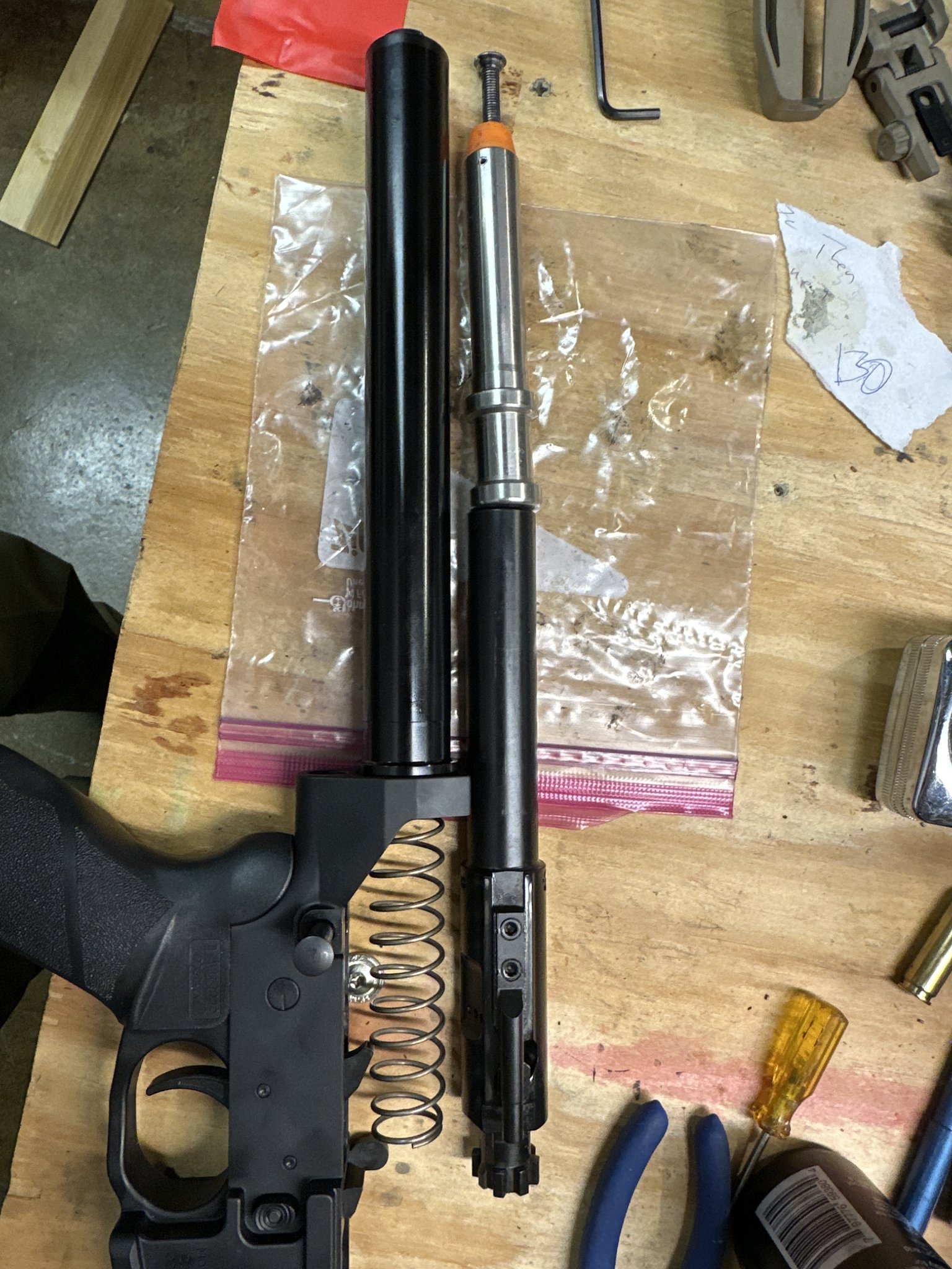

So the gun ran for testing but the bolt not locking back is an issue now that I have it in the shop and can see it.
The bolt catch is grabbing the carrier and not the bolt. If I take the buffer spring out, the buffer + the bcg will just clear the catch. With the spring in, the whole system is too long by about the width of the lugs. Anyone know if there are different ends for the heavy buffers? Any other thoughts?

It’s 9-11/16”. It came with a carbine spacer that I was able to get out of the tube. When I measure the bcg, with the bolt extended, and the heavy buffer together I get 14”. That’s also the exact distance I got measuring from the bolt catch to the back of the tube so there is little room for error. When I put it all back together the bolt is 1/4” beyond the catch when I bottom it out in the buffer tube, with the buffer and spring in.

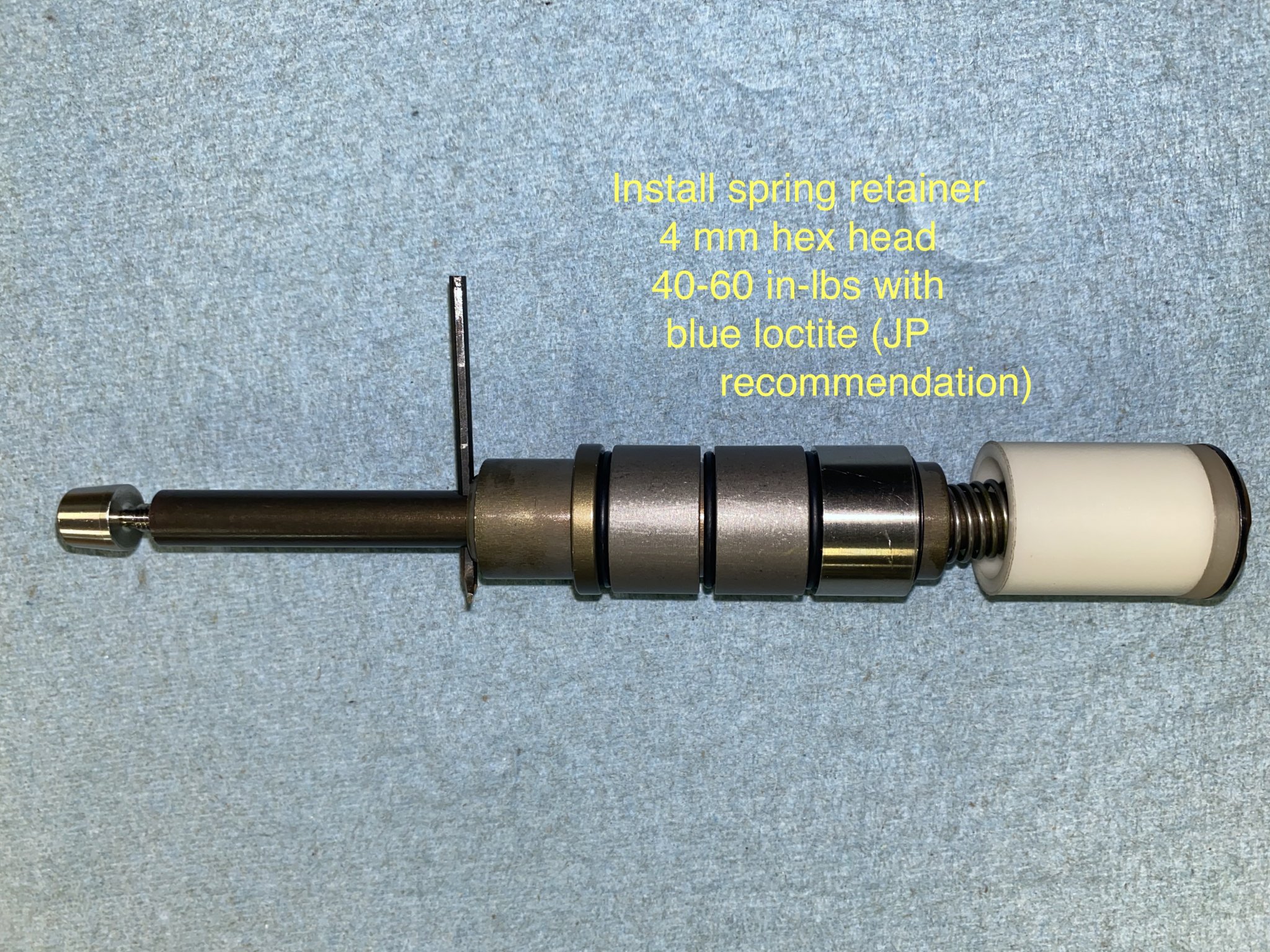

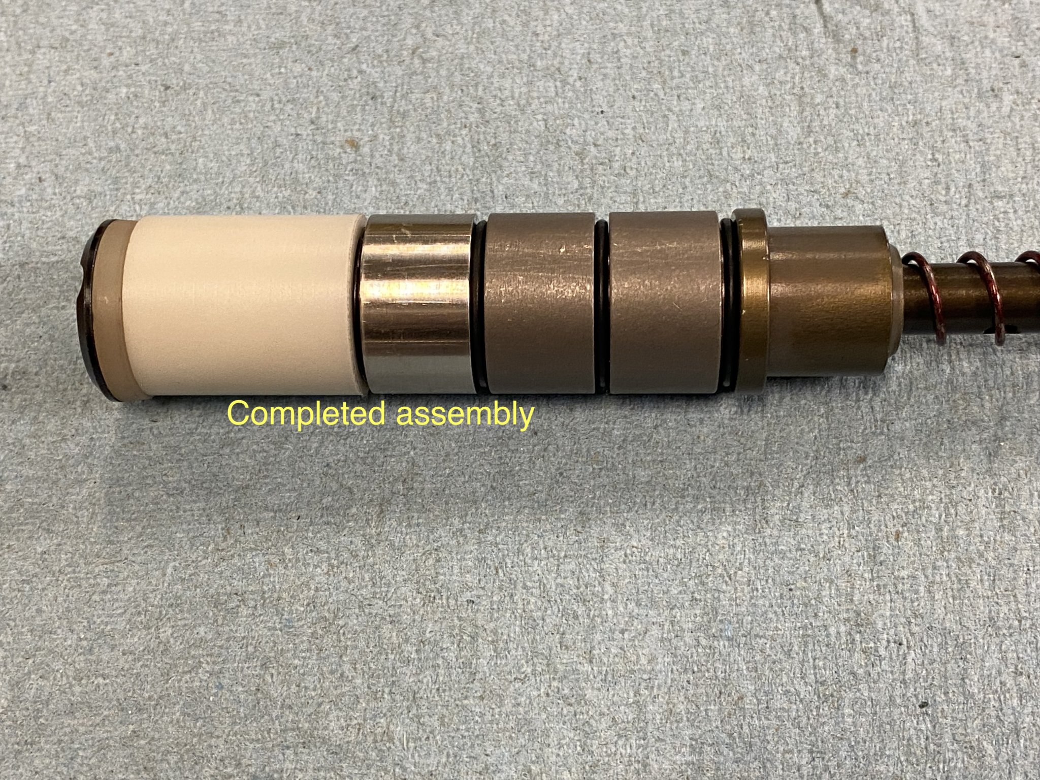

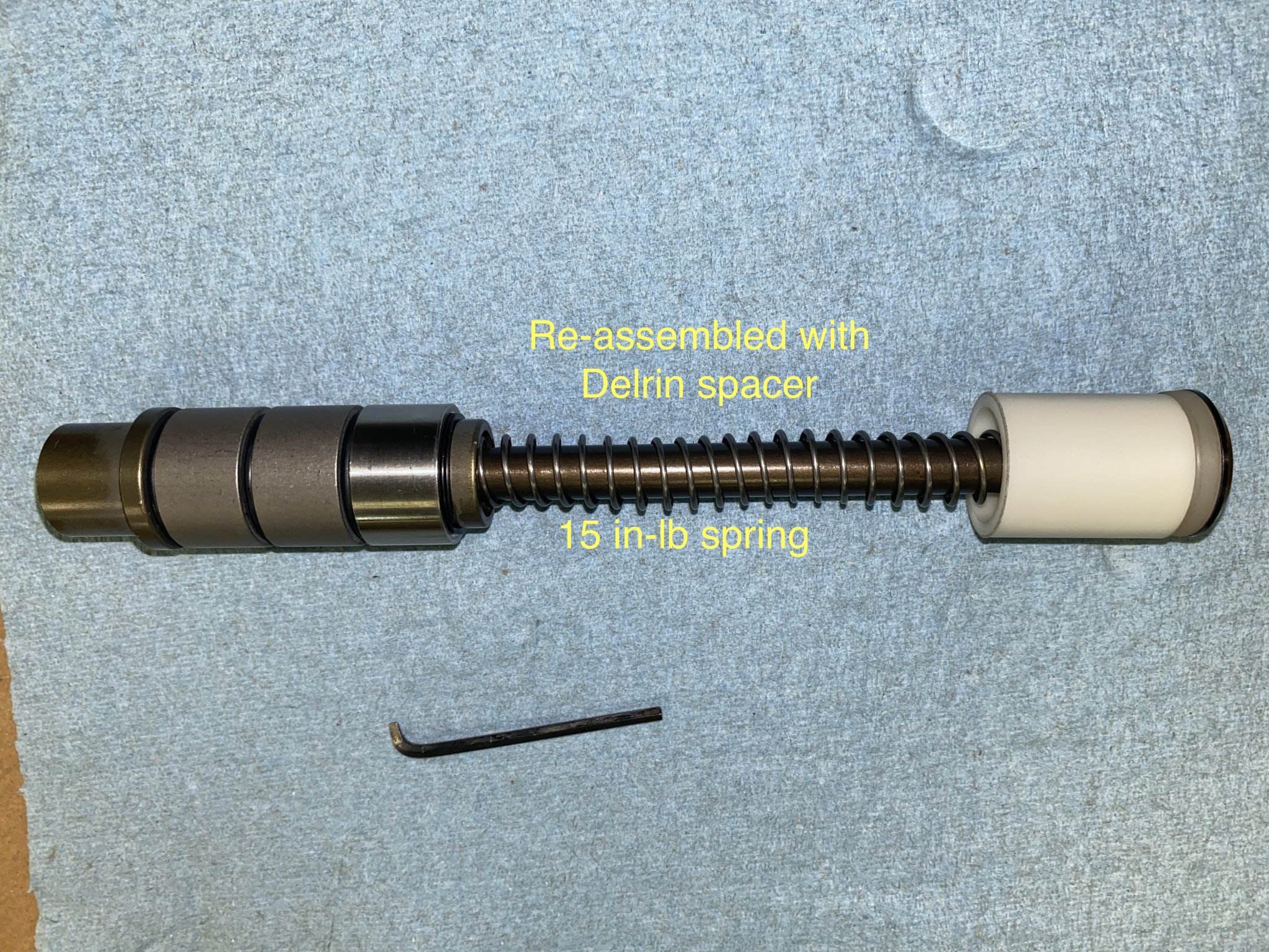

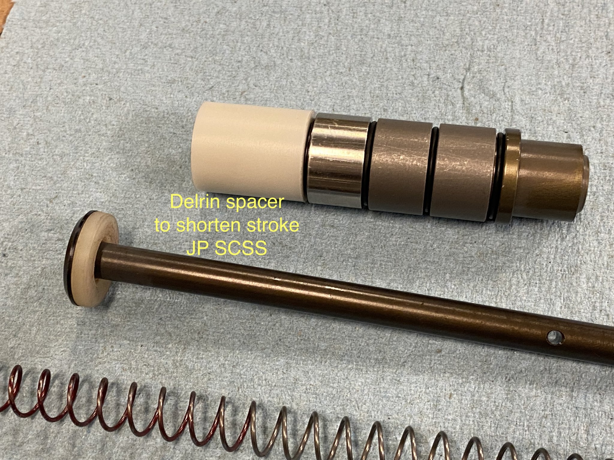

I just fabricated a delrin spacer for an 11.3" WC 6.8 SPC II to run a JP SCPS and lock back properly; also had to fabricate a correct length spacer for 14.5" KAC ACC using the JP system. Both with Law Tactical folder adapters installed.
IMG_9988Wilson Combat 6.8 SPC 2 JP SCSS  LawH2 Delrin Spacer Fabrication 02.17.24 copy.jpg
IMG_9982Wilson Combat 6.8 SPC 2 JP SCSS  LawH2 Delrin Spacer Fabrication 02.17.24 copy.jpg
IMG_9975Wilson Combat 6.8 SPC 2 JP SCSS  LawH2 Delrin Spacer Fabrication 02.17.24 copy.jpg
IMG_9976Wilson Combat 6.8 SPC 2 JP SCSS  LawH2 Delrin Spacer Fabrication 02.17.24 copy.jpg
IMG_9980Wilson Combat 6.8 SPC 2 JP SCSS  LawH2 Delrin Spacer Fabrication 02.17.24 copy.jpg
