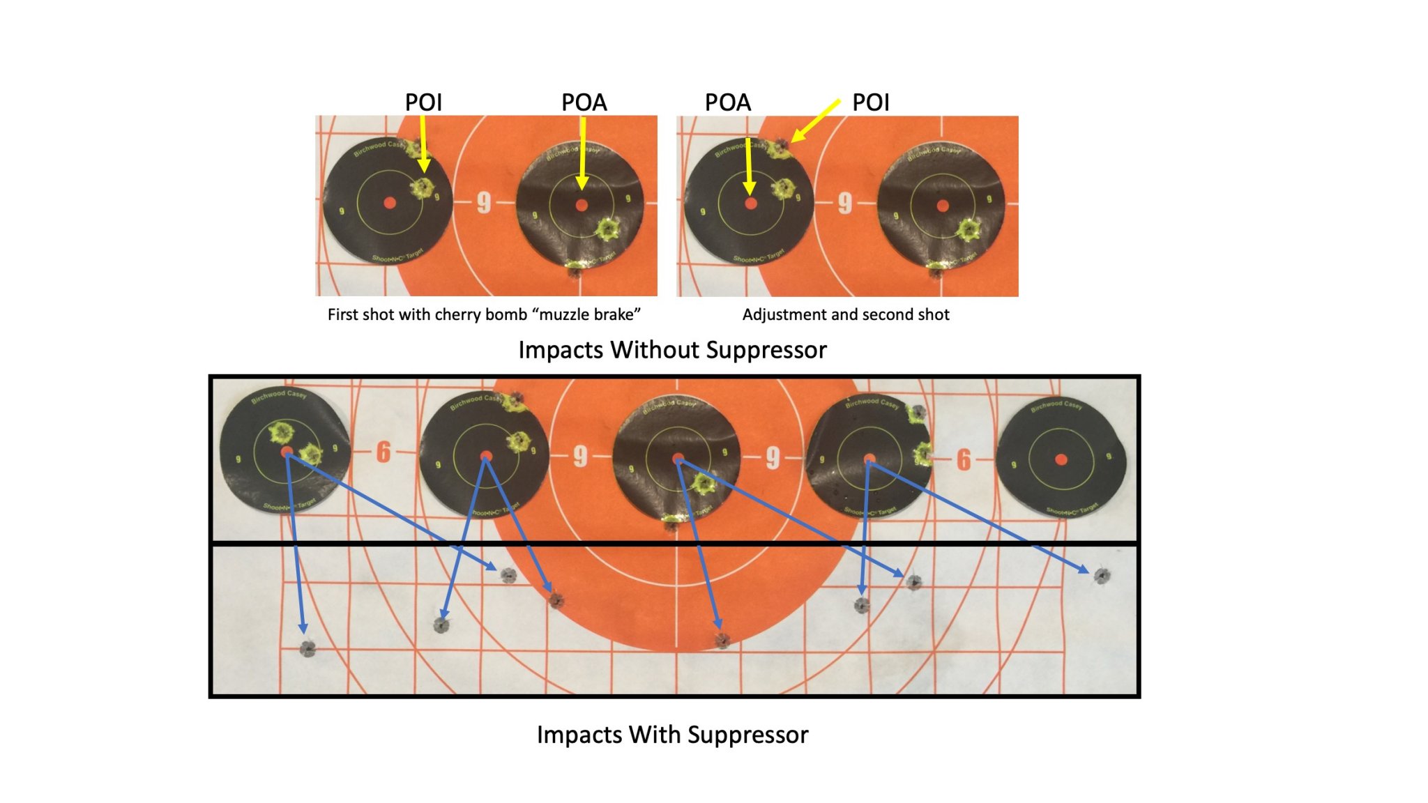

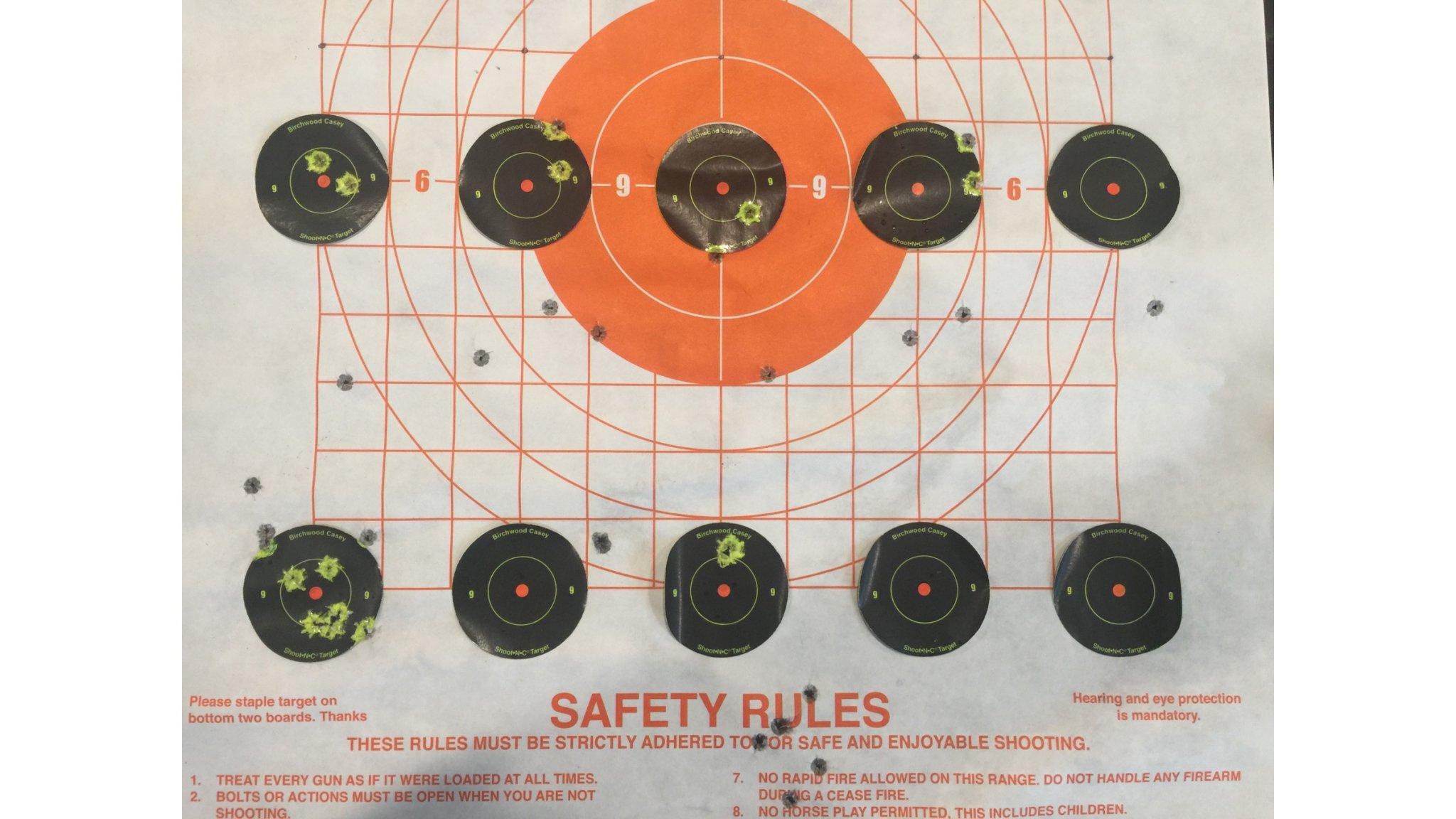

    I took my new Thunder Chicken out to the range today. The purpose of the trip was to determine point of impact shift with and without the suppressor on 2 different rifles. My "test" was to shoot 2 shots without the suppressor, then 2 shots with the suppressor at the same point of aim. I would repeat for a total of 20 shots fired at 5 target spots. The test "evolved" as I went, but here are my observations.
    First, here is the target. The top 5 spots were shot with my Ruger Precision Rifle in 6.5 Creedmoor. The bottom spots (where the test really evolved) were shot with my AR15 with a JP 6.5 grendel barrel.
    Instead of explaining on this target what is what, I've broken it down some in the next picture...
    Observations.
    1. The Cherry bomb suppressor pushed the point of aim (relative to the factory ruger brake) about 0.7 MRAD to the left.
    2. Impacts with the suppressor were consistently low, relative to the cherry bomb only.
    3. The suppressor appears to dramatically reduce the precision of the rifle relative to the cherry bomb only.
    4. The test was called short at 4 target spots as I was concerned the "with suppressor" impacts may be off the target.

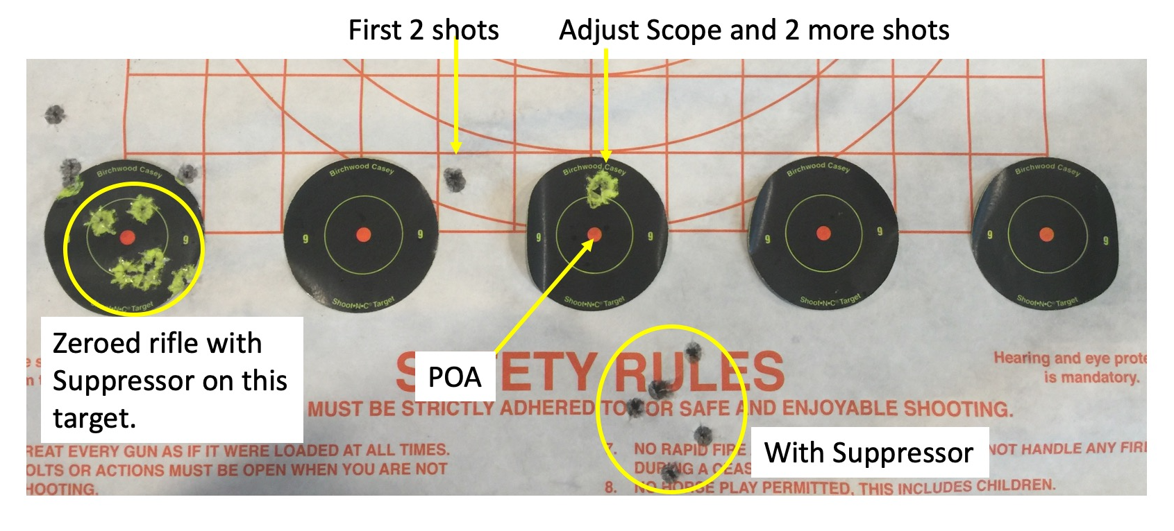

    After these 16 shots, I said "well, lets just leave the suppressor on the gun and see if I can get something. I shifted to a new target paper...
    The first impact was low and right of the point of aim. I (over) adjusted the scope, made sure the suppressor was tight, and fired three shots. Those are low and left.
    Observations...
    1. It appears to take a few shots (and some incremental tightening) to get the the suppressor to group.
    2. More testing is in order before taking this to a match.
    3. If the precision holds up with more testing, this will be a great addition for match shooting.
    It was starting to rain and I really wanted to see the suppressor on my Grendel, so I switched rifles. Because of the observations with the Creedmoor, I abandoned the idea of 2 shots off and 2 shots on, and instead shot to confirm zero without the suppressor. Interestingly, I saw the same shift of ~0.7 MRAD left with the cherry bomb, relative to the Little Bastard Brake that was on the rifle prior.
    Observations
    1. The cherry bomb brake shifted the point of impact on this rifle similarly as on the creedmoor
    2. The suppressor moves the impacts low on this rifle, similarly to the creedmoor
    3. I did a better job of tightening the suppressor, as there doesn't appear to be a "shoot in" in this test.
    4. Accuracy is meh in this test with the suppressor, but I was fighting with a balky bipod that was failing at the attachment point. Accuracy needs to be re-evaluated.
    5. This is good enough to shoot a deer at 100 yards, so it is good enough for this weekend.
    6. The JP barrel is a hammer, and always has been.

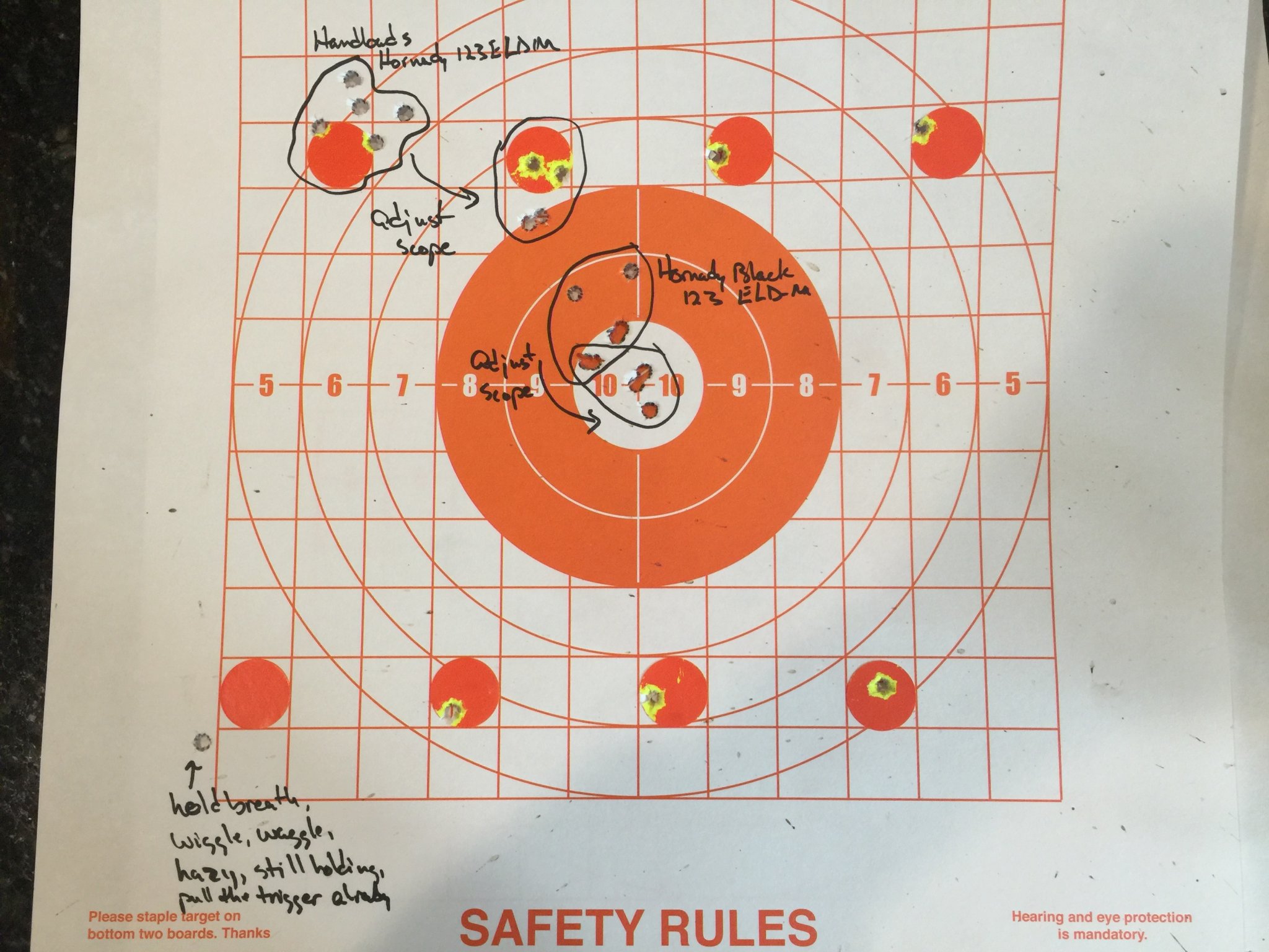

    So I was having a rather meh day at the range. My dad recently inherited a 300 weatherby magnum and he asked me to work up a load for it. I've since decided that the 300 weatherby magnum cartridge is not a pleasant cartridge to shoot in a hunter weight rifle. The previous owner was a big man and had a lot of mass with which to absorb recoil. I am not and do not. But, the box of weatherby brand ammo I bought shoots sub 2 MOA and will be sufficient for my dad to take an elk at any range he will be comfortable shooting one, if he decides to put in for a tag.
    I brought along my 6.5 Grendel again to see what it would do since I had torqued the suppressor (Q Thunder Chicken, for those just tuning in) to the manufacturer's suggested value of 15 ft lbs. I had a box of Hornady Black 123 gr ELD-M ammo that I have chrono-ed (without suppressor) at 2550 fps and my handholds using the same brass and bullet at a chrono-ed (without suppressor) velocity of 2530 fps. First up was the factory ammo; it made a group near the point of aim, but not an amazing group. I adjusted the scope and fired again. The group was pretty much the same size, but now more or less centered in the bull's eye. Well, that's good, but not match good. Let's break out the hand loads. The first group was also "just a group" and not amazing. Adjusting the scope put the next group pretty much on top of the spot.
    Wait a minute. You put 8 of those little sticky spots on that target paper. You don't shoot groups when it counts. Just put one shot on each spot and see what happens. First shot went into the little sticky spot (Top, 3rd from left). Great, let's do it again. Okay, breathe in, breathe out, stay on target, no pressure, stay on target, you're head isn't square to the optic, stay on target, don't breathe, need to focus harder b/c the edges of the picture are getting blurry, don't move, stay on target, who needs to breathe anyway, PULL THE FRICKIN' TRIGGER (Bottom, left most). Well that didn't work. Maybe if we just get on target, breathe normally and squeeze the trigger like we learned on SH. Cool. Cooler. That'll work. WOW!
    So, even though I was unable to print a "wallet group" with the suppressor attached, I am pretty confident in the ability of the rifle/scope/suppressor combination to put the bullets on target when I do what I am supposed to do, and do not force the issue. Maybe shooting groups is more stressful than I thought it is. All of those little holes looking right through the scope, into my soul, mocking me as I try to squeeze the trigger may be just too much pressure...
