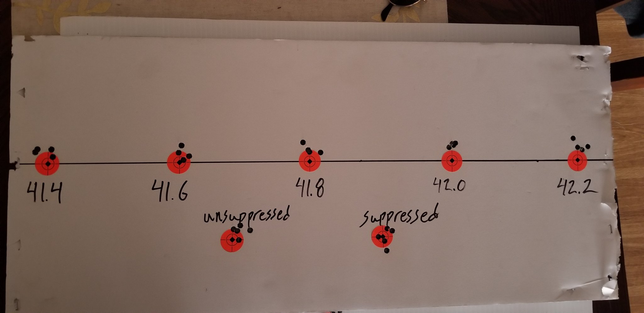

Today I ran an ocw test from 41.4 to 42.2 in .2gr increments. This test was based off my ocw test from last week in .4 increments from 39.0 to 42.6. Below is the link from my original post and a picture of today's test. Let me know what you all think. Personally, i was just going to load 41.8 and run a seating depth test.
Original post:
Today's test:
42 is better but i find it odd that 41.8 and 42.2 are so different. When I do it I shoot one round of each load through the different targets then repeat to eliminate shooter bias. you should get a clear pattern. I would bet that anything from 41.9 through 42.2 are very close but then do seating test to fine tune.

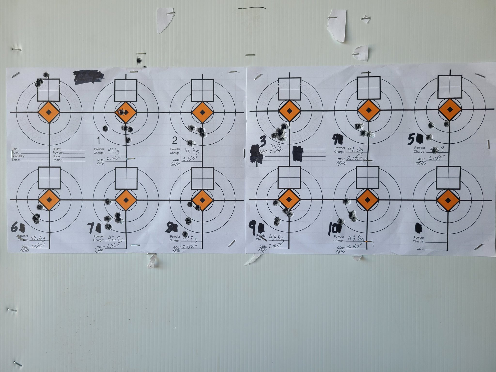

Finally got to do a ocw test for my tempest.
Shot round robin with 5 rounds in each target. Well, attempted to. Targets 4, 5, and 6 are short one round each due to light primer strikes. From the looks of it either target 5 or 8 are my scatter nodes. Based on ocw test guidance of scatter nodes being 1.5% up or down from a ocw, if i go with target 5 my ocw would be either 41.7 gr for or 42.9 gr. If i go with target 8 as my scatter my ocw would be 42.6 gr or 43.8 gr.
Even considered 41.1 gr on target 1 to be the scatter node as its spread and pattern are unique from all the others. Going above it would bring me to 41.7 gr.
I am thinking of using 41.7 gr as my ocw. Let me know what you think or recommend. Still learning to read ocw results. Any feedback is appreciated. Thanks!

42.0gr. do 5 shot groups of 41.9, 42.0 and 42.1 to confirm its in a nice area.
Proceed to seating depth. Do 2 shot seating on each depth. Sure you can do 5 and make it nicer, however I've found doing smaller increment, and shoot more frequently you can watch the group close up. If you do 10thou seat differences, I find that a bit tough.
Good luck, post results.

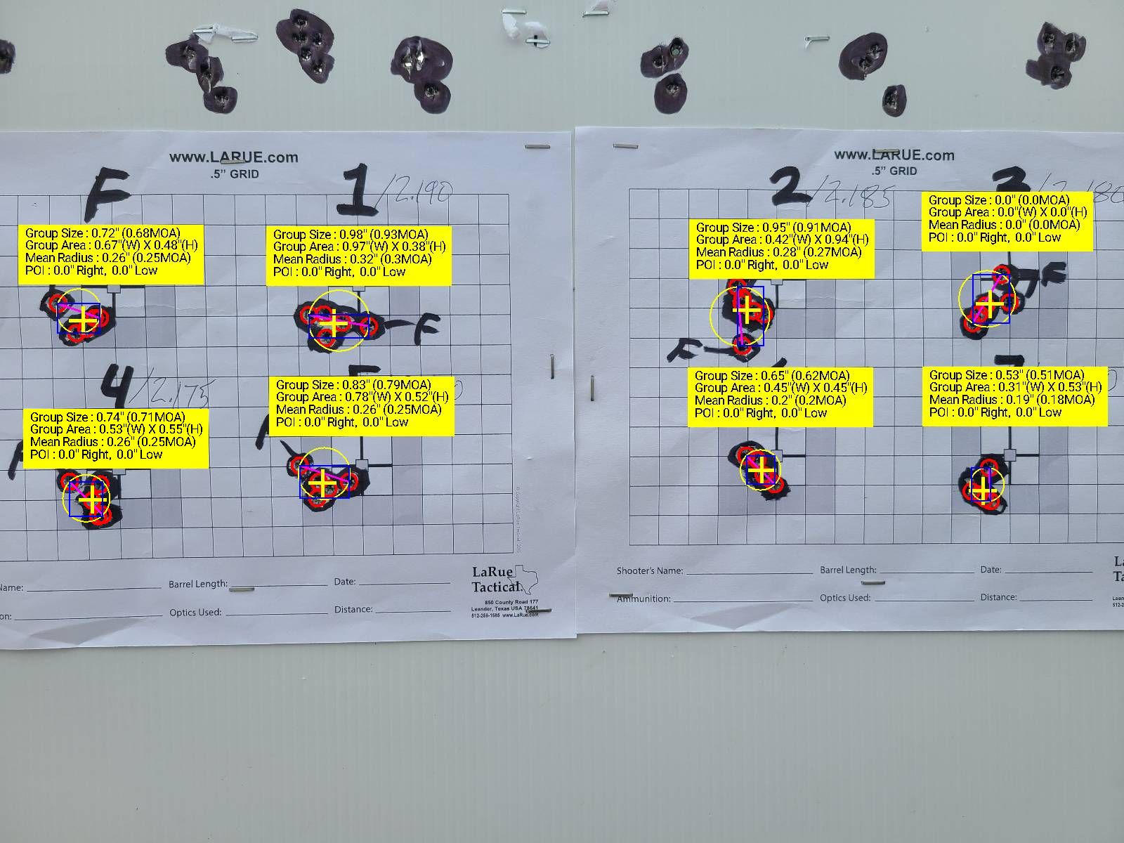

Did seating depth. Shot in prone I am a little out of practice so please excuse the sloppiness of my groups. I believe any change in point of impact was due to mirage coming off the berms preceding the 100 yard line. I am thinking group 6 (2.165" CBTO) for my OSD. What do you all think?
CBTO increments of .005"
F) 2.170"
1) 2.190"
2) 2.185"
3) 2.180" (Group size: .92")
4) 2.175"
5) 2.170"
6) 2.165"
7) 2.160"
Good notes on your testing, easy to interpret. For what it’s worth, here’s my .02
Couple things for consideration:
- Retest 5,6,7,8: 2.155 at 2-300 yds (identify the OSD’s spectrum).
- Do your best to mitigate your variables (mirage and breaking clean shots) or increase your sampling size to 7 shots each
- Barrow a chrono if possible. Much easier interpreting oddities when each shot has a value.
Thanks for sharing and letting us tag along with your load development.
Reactions: jb41291
