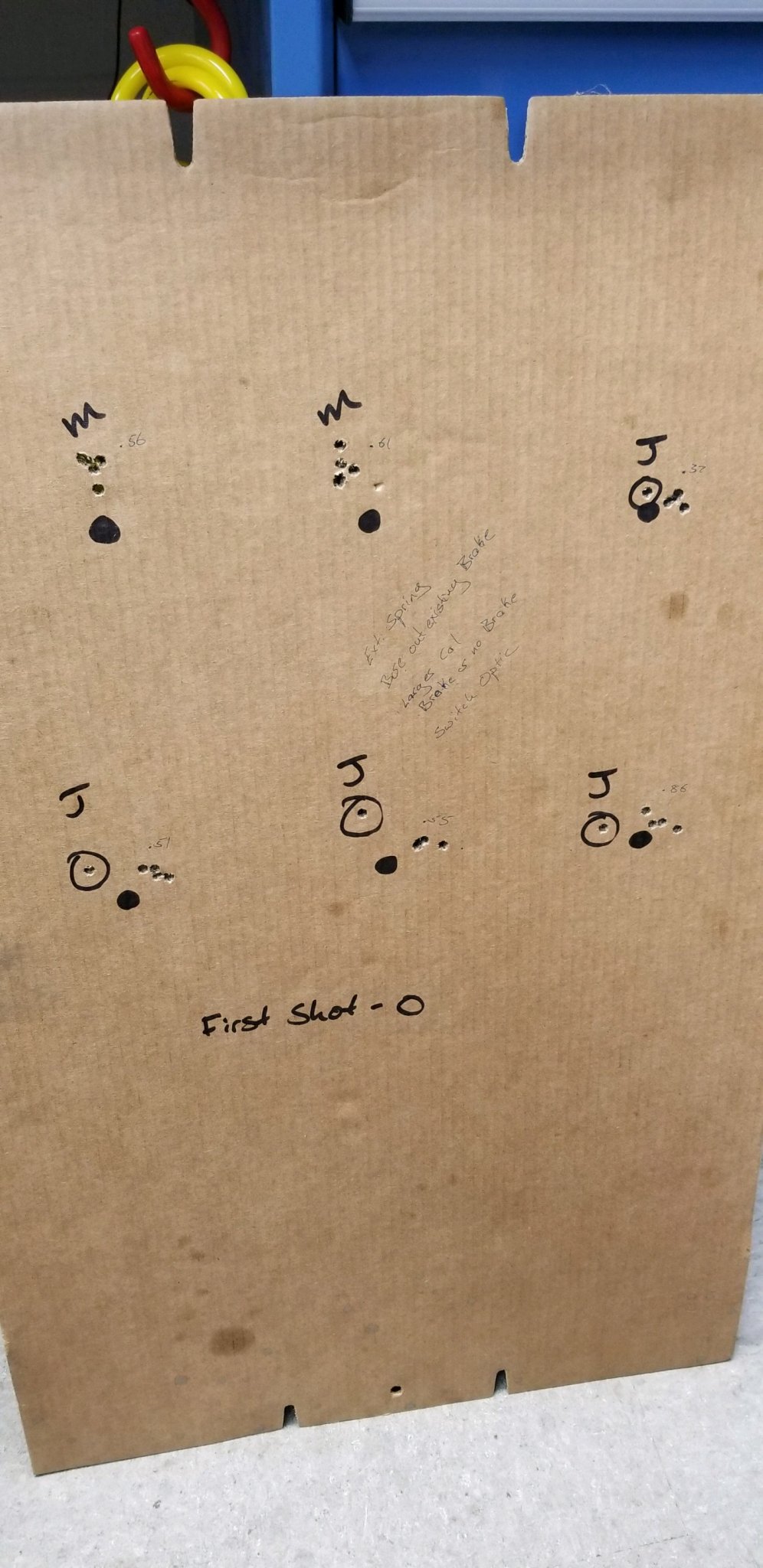

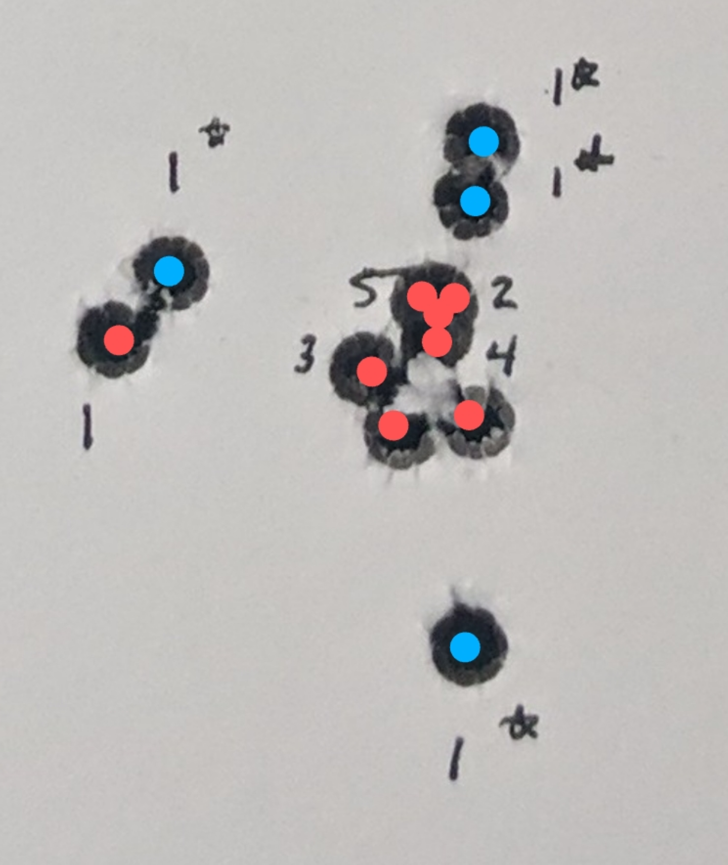

So had an interesting find today. I zeroed a new scope on my 224V and noticed I'm getting "flyers" on a first round shot.
The orange dots mark the center of each of the first 6 rounds fired. Having such a solid group, I thought "let's keep going!" So I put one round in mag, dropped bolt and fired shot at 6 o'clock. Repeated, with another single round from mag, dropped bolt and highest 12 o'clock. Then 10 o'clock, then last at inner 12 o'clock.
Saw this issue on few separate groups where first round sailed well out of normal group.
I would like to say it was something I did however I also shot another semi auto today along side this one and did not have anything like this issue. Any ideas on items to check?
What mechanical issues might be causing/contributing to this? Dumb luck? Seems too repeatable to purely coincidence.
Thanks in advance for input!

Good suggestions all around. It doesn't feel like my fundamentals are off but you but you never know. I was breaking position on each of the single rounds to load mag.
I'll check rifle over again to be sure nothing loose and experiment with loading pressure and cheek weld to see if that's helps.

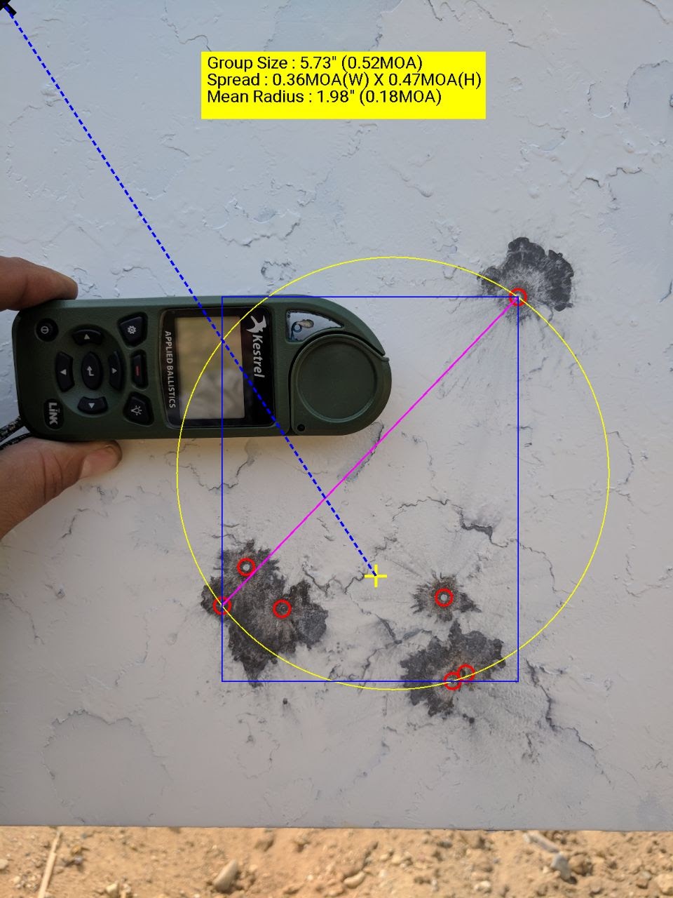

Also had an AWESOME group at 1k with my 224V. 7 shots landed into 1/2 MOA at 1,056yds and 6 of 5 at just around a 1/4MOA. Average to Center of .18 MOA. I focused on relaxing shoulder and reducing forward pressure into more "body pressure" if that makes sense. I still had a few shots that crept up/left/down of intended impact but they seemed much less pronounced. Gotta love fundamentals!
Also went 4 for 7 at 875 from barricade standing, but that was brutal in terms of focus to time wind and crosshair; definitely need to get more barricade work in before next match.

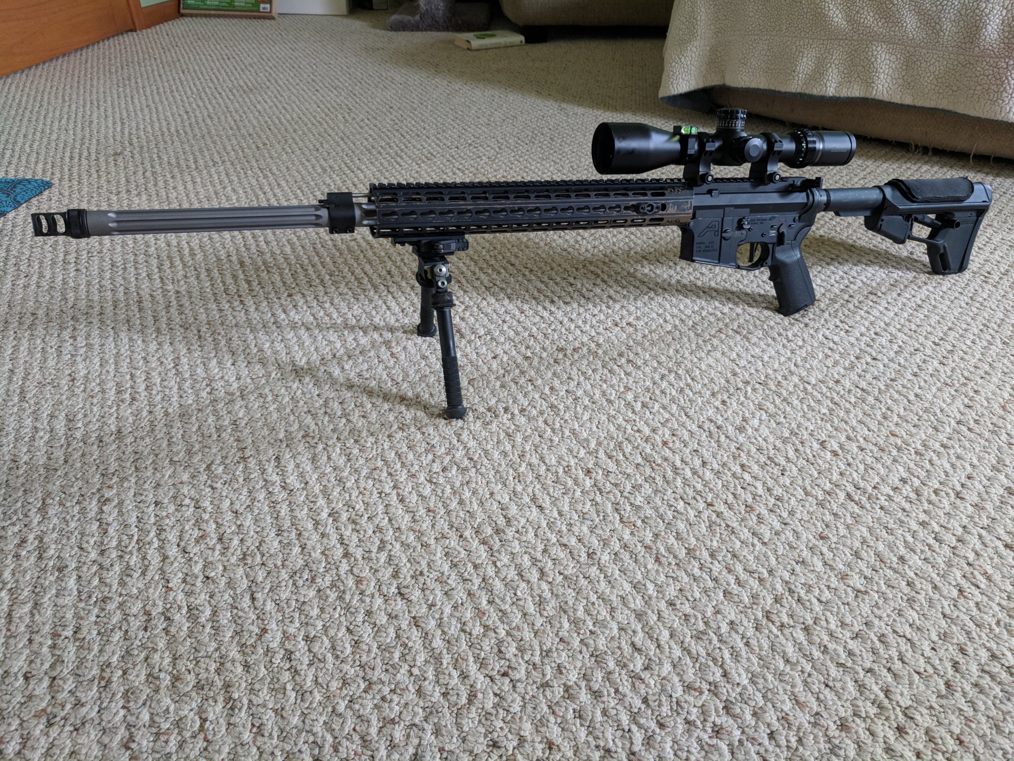

Damn fine shooting! Especially with an AR.
What rifle are you shooting?
224 Valkyrie 26" Rainer Ultra Match Gen 2 barrel +3 gas system in an Aeroprecision M4E1 Enhanced upper lower set. Have a Sig Tango6 4-24 on it now though. Also have CMC 1-3 two stage trigger and JP SCS installed.
Don't get me wrong here: this gun shoots well but it won't do that "All Day Long". It's usually around .25 ATC (1/2-3/4MOA center to center). The stars aligned though and wind helped tighten things up a bit.
