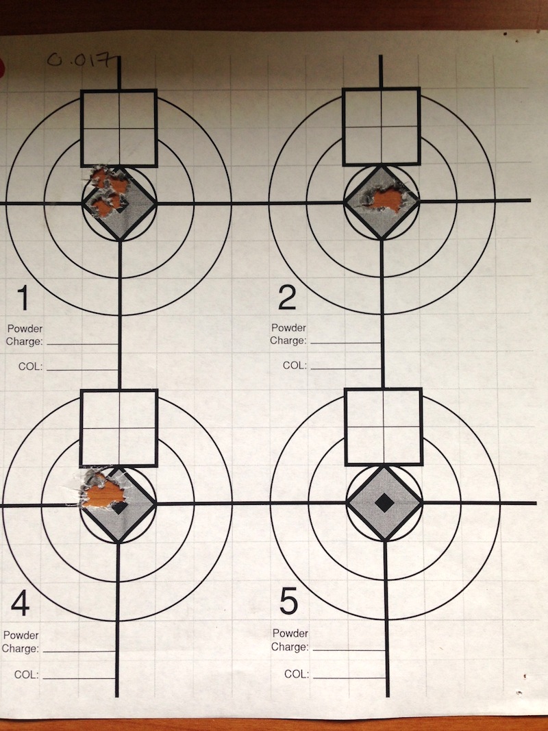

Mine is extremely accurate as well... three five shot groups immediately after cleaning for the first time. The cold clean bore is also in the group, so I'd say this is a winner and that I've found a solid load for the 155.5's. I have a 185 load in the works as well that I just need to go and verify, but it's also shooting just as good as this. At any rate - the rifle is more accurate than I am as a shooter. Even my worst load work up shot under 1MOA.
Edit: I should mention that this is a UK 24" barrel.

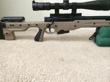

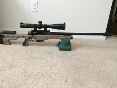

I called AI and was told hi rings but seems high. Not a problem as I fall right into perfect focus even at 40x.

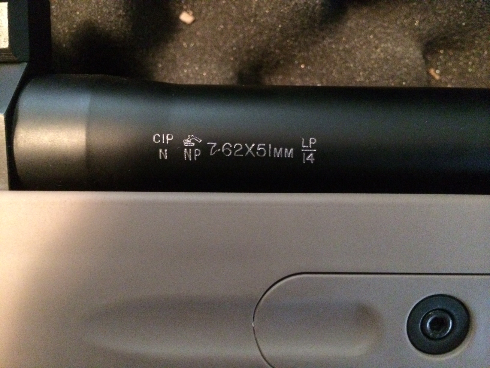

All AT's coming from the UK have .308 Win Lothar Walther 1 in 12 twist bbl.'s. Once they reach stateside AINA have Bartlein bbls in 1 in 10 twist chambered by Dave Tooley that can replace the LW bbls. My AT has the LW bbl and I don't have the luxury of replacing it to a Bartlein as I live in Canada and our only Cdn distributor for AI (Wolverine Supplies) can't or won't bring in the AINA bbls. Wolverine brings in tons of stuff from the US so I don't know why bbls would be an issue. Maybe Mr. Irwin can offer some insight. If this was available, AI would sell a lot more rifles in Canada. Same as any of the other calibers offered by AINA, 260, 6.5 CM, 243 etc, us Canadians are shit out of luck.

It's a lothar walther barrel made for AI. I am not 100% sure if AI or they chamber them.
As far as rings. I have low think it's .92 height 34mm seekins with a hensoldt. I had to take the small butt spacer out to get a good eye relief because the front bell , objective can not come reward anymore. The bolt shroud just touches my check when the bolt is in its rearward position.

All AT's are shipped from the UK with Lowthar Walthar barrels, which perform very well. They are then received into AINA and forwarded to our distributors with the same Lowthar Walthar barrel. We do not fit any Bartein barrels to AT's at AINA.

care to share the load specifics for the 155.5 bergers?
45.9 grains of Varget
Lapua cases (trim to 2.005)
CCI BR2 primer
2.960 OAL which will put you at around 0.017 off of the lands (at least in my rifle) and will still feed from a AW mag.
The load is safe in my rifle, as always start low and work up and your COAL may vary from mine.
This is a perfect OBT node for a 24" barrel and will get you about 2860 FPS. On a hot day I have seen 2920 FPS.
