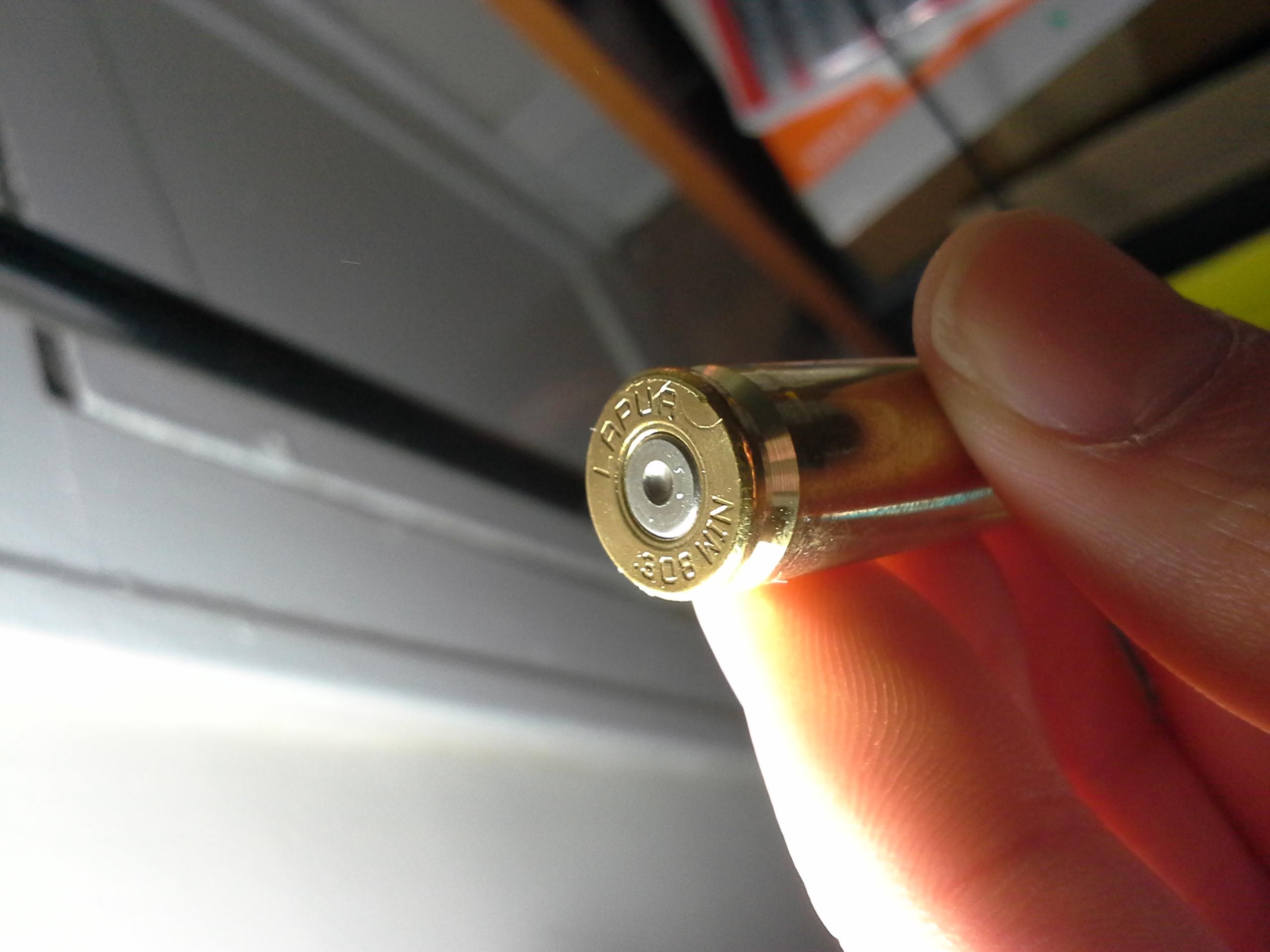

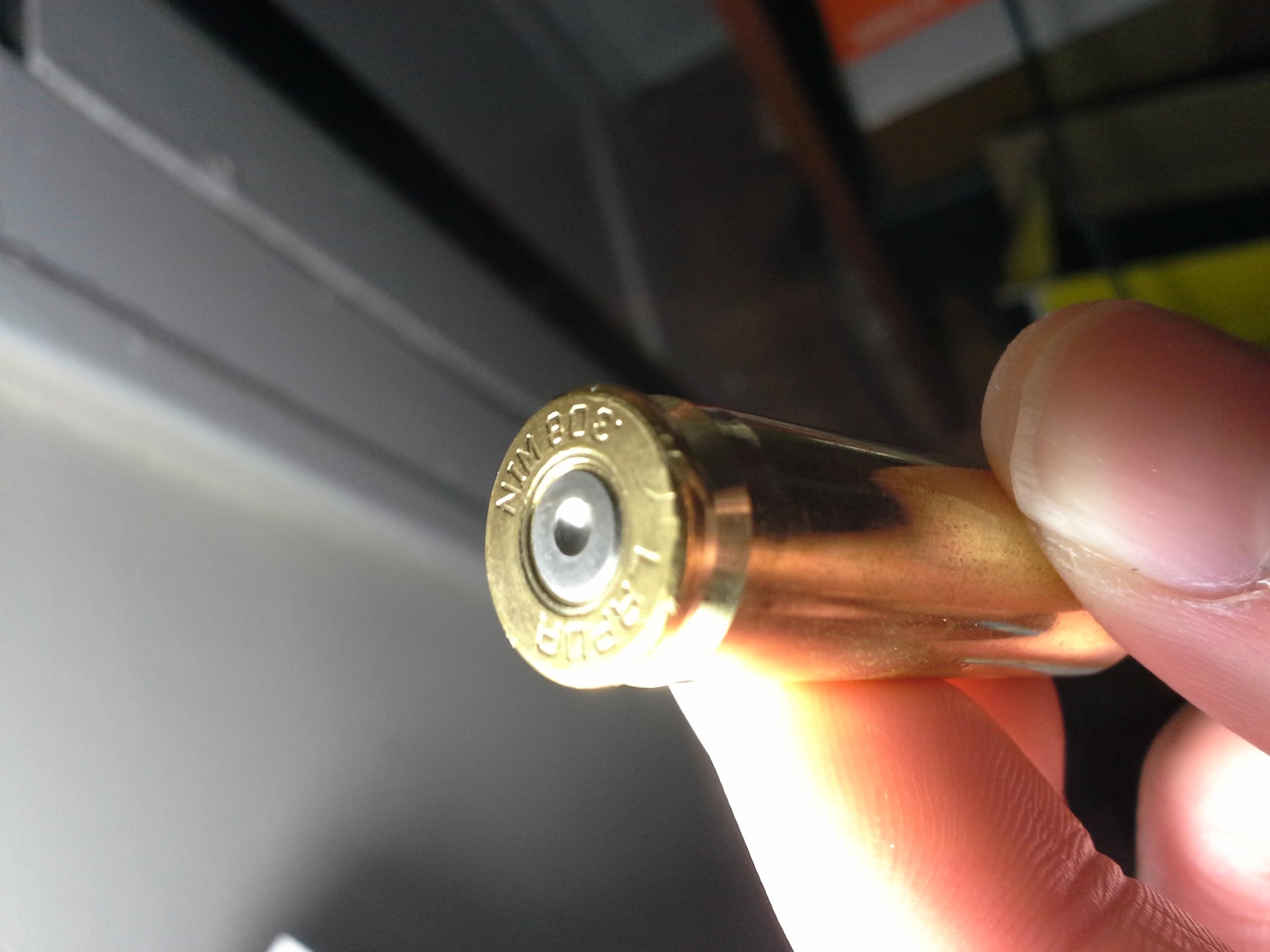

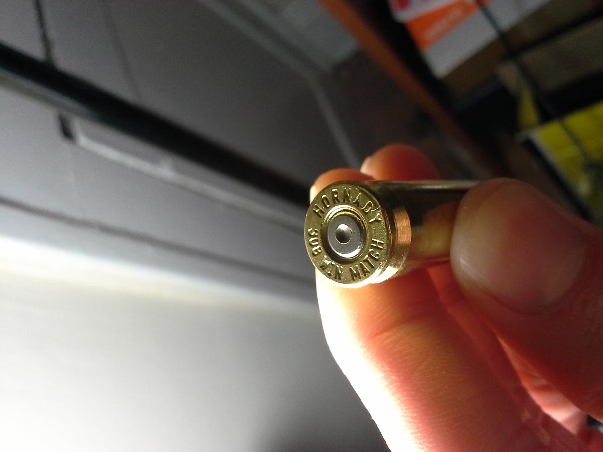

Finally took my AT 308 20 (factory LW 1:12) and 260 26 barrel (from MH, 1:8) to the range, shot some factory ammo and handloads, much more accurate than my old savage. However, I've noticed a new issue.

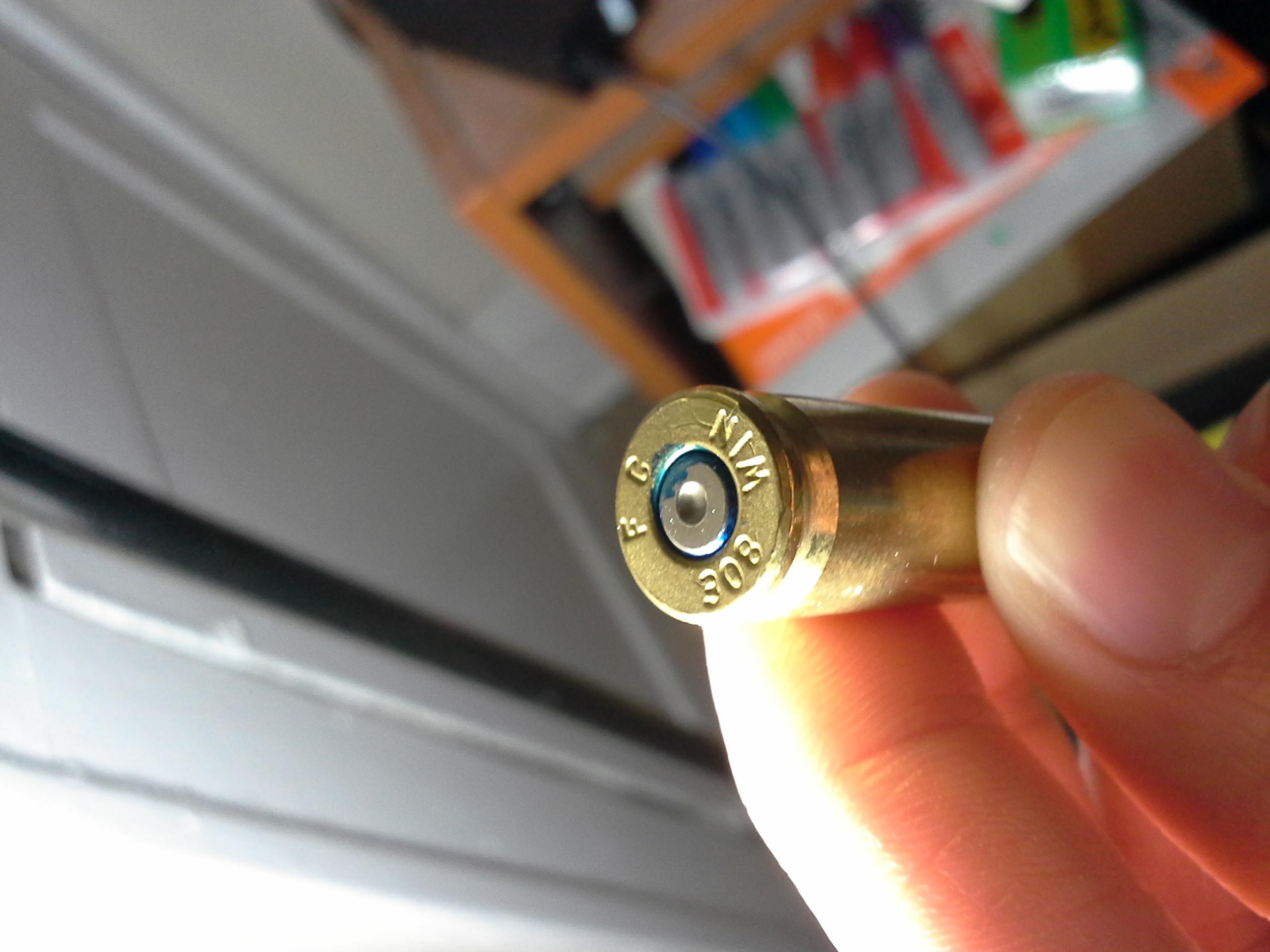

Starting from the really mild loads (IMR4895 42.2 OR IMR4064 41.5, 0.02 off lands), my brasses are showing ejector marks, even for 175 FGMM (average 2430 FPS per chrono) and Hornady 168 match (not chrono-ed). It's not a brass issue since all 4 (FC+Hornady+Norma+Lapua) are involved. Per google some of the brand new brass can have this problem due to too much headspace but FGMM and hornady are factory ammo.
FGMM 175 @ 2430
Hornady 168 match

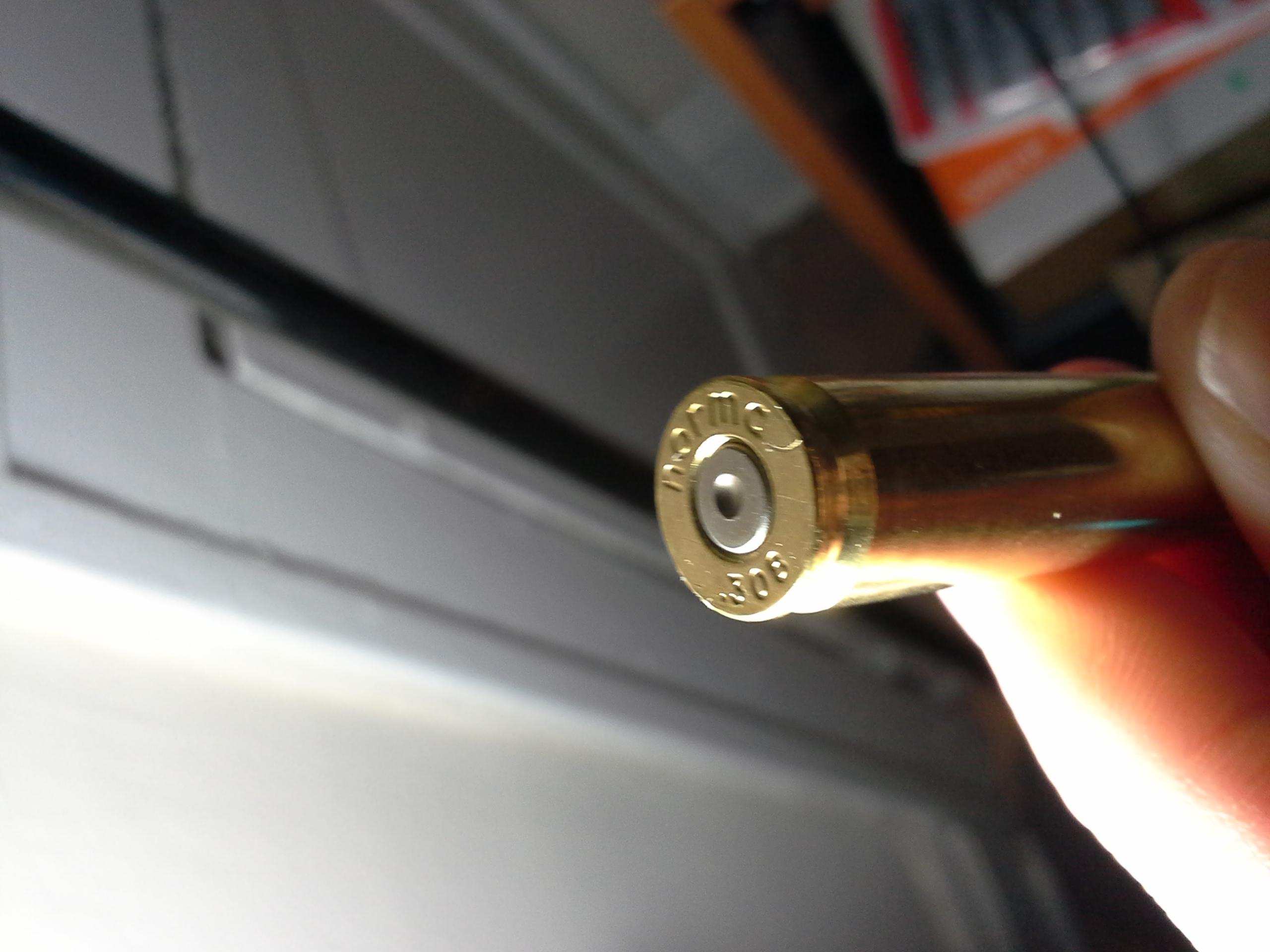

Brand new Norma brass with 185 juggernaut, 42.6 varget, CCI 200, 0.02 off lands @ 2430
Brand new Norma brass with 178 HPBT, 43.6 varget, CCI 200, 0.02 off lands @ 2510
Brand new Lapua brass with 175 SMK, 42.2 IMR 4895, CCI 200, 0.02 off lands @ 2480
Ejector mark
Brand new Lapua, 175 SMK, IMR 4064 41.5, CCI 200, 0.02 off lands @ 2450

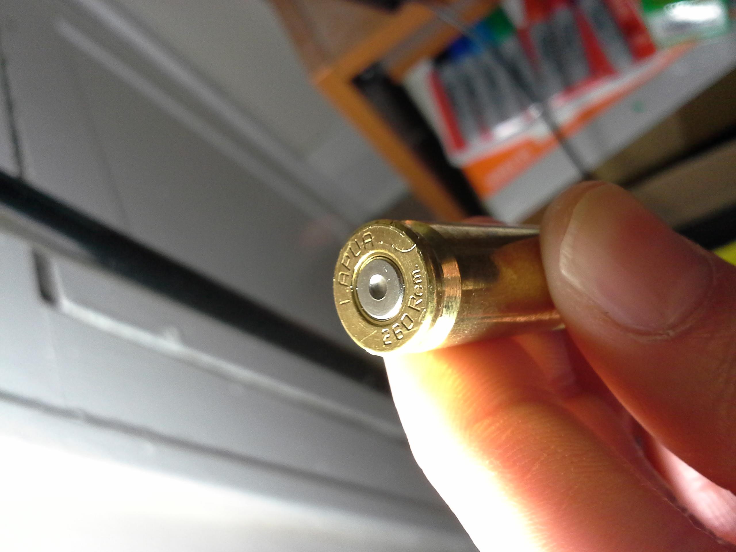

Brand new Lapua, 139 Scenar, H4350 42, CCI 200, 0.02 off lands @ 2750

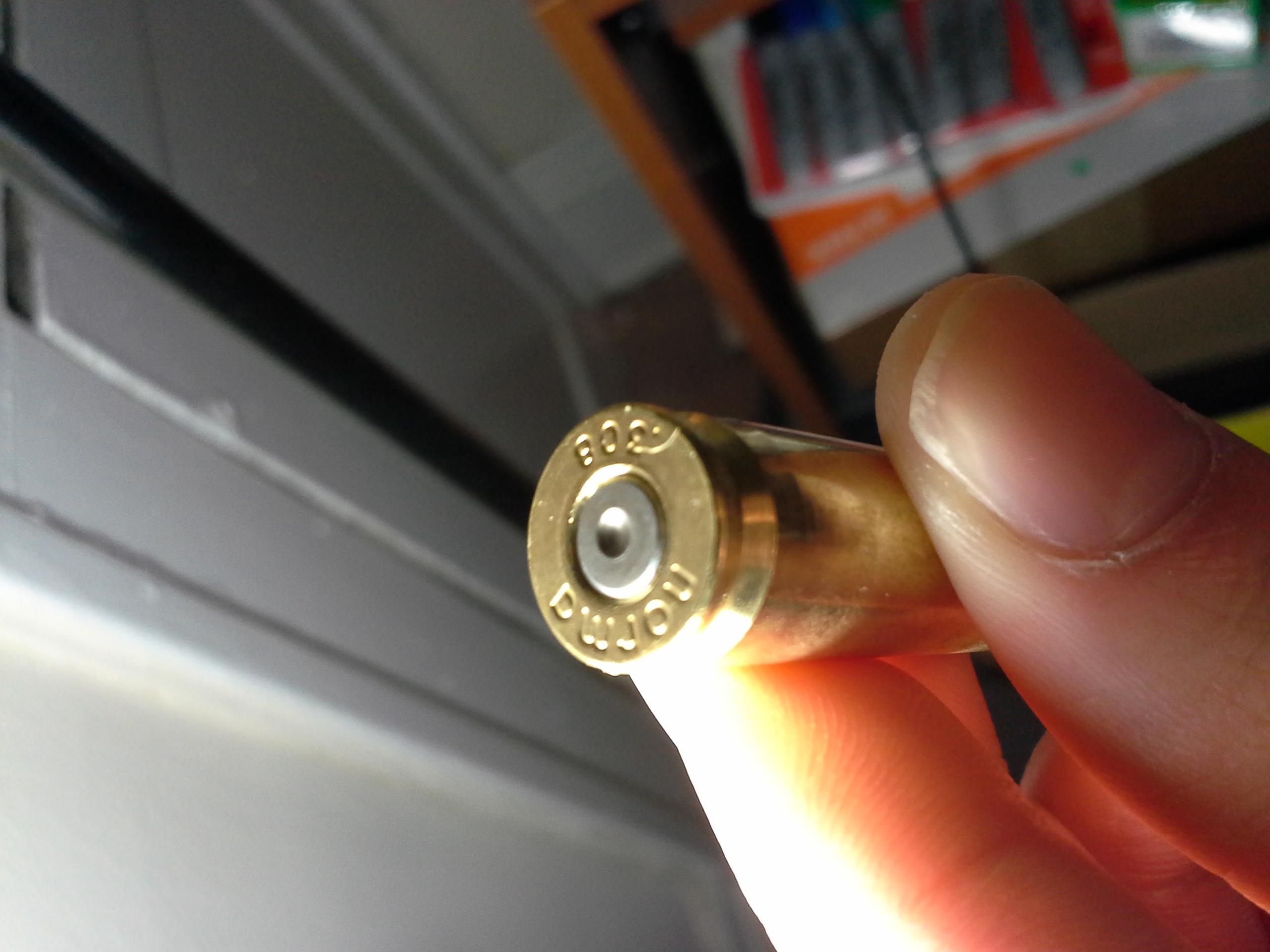

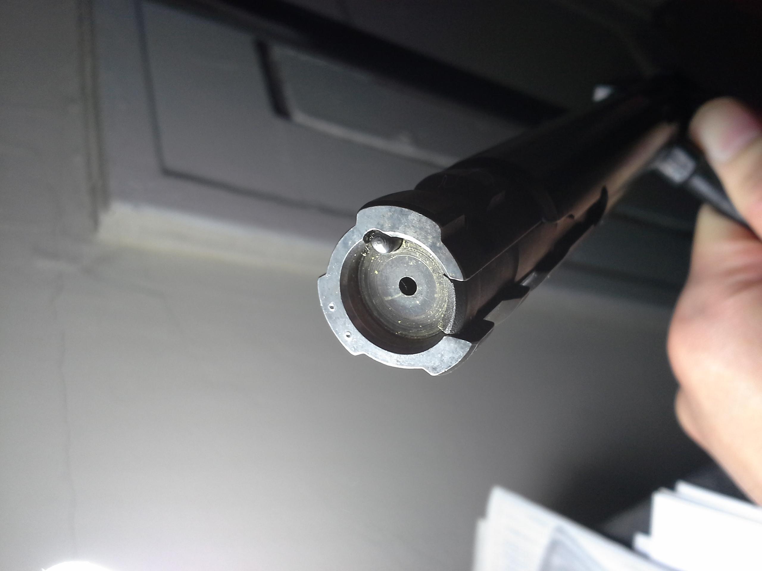

Bolt face
Are all the loads over-pressure? This is really confusing...Any thoughts?
Is it with the .308 barrel only? I am having similar issue with mine. The factory barrel there is not an issue. But I put my .308 Custom barrel Bartlein 22" I think it's a .298 tight bore and after 40 rounds it started doing what you pictured. I thought it might have been my reloads. The load has worked in all my rifles.
Have you cleaned the barrel once? Reason I ask is because I took mine home and the barrel had a lot of carbon fouling. It could have caused pressure issues. So I will have to go check this next weekend. I shot the factory barrel and cleaned it good once and it is fine no issue. I would have switched the barrel out and tried it but it is getting cut down at the moment.

Bolt face
You are too close to the lands on the .260 load. Start off further away and see if it doesn't help.

both barrels. Also my factory barrel was not cleaned before I shot it. They probably shot a few rounds before letting the toys leave the factory but I doubt that would give much carbon fouling
No problem. When I got my AI it's what I had to do. Also it you start piercing primers, you can always adjust your firing pin. Frank has a good post floating around that explains how to do it.

You had similar problem as well? Though I don't have any primer crating or difficulty lifting my bolt, i am still trying to be on the safe side. Don't know if it would be worthwhile to try 155 scenar
Main thing for me was forgetting the idea it needed to be anywhere close to the lands. I shortened it up to about 0.015" off and it shoots phenomenally there. Pressure went down, velocity stayed good, and all was well. The firing pin does hit hard on AIs, so be sure not to let that fool you about where your pressure is. That's why I adjusted mine.

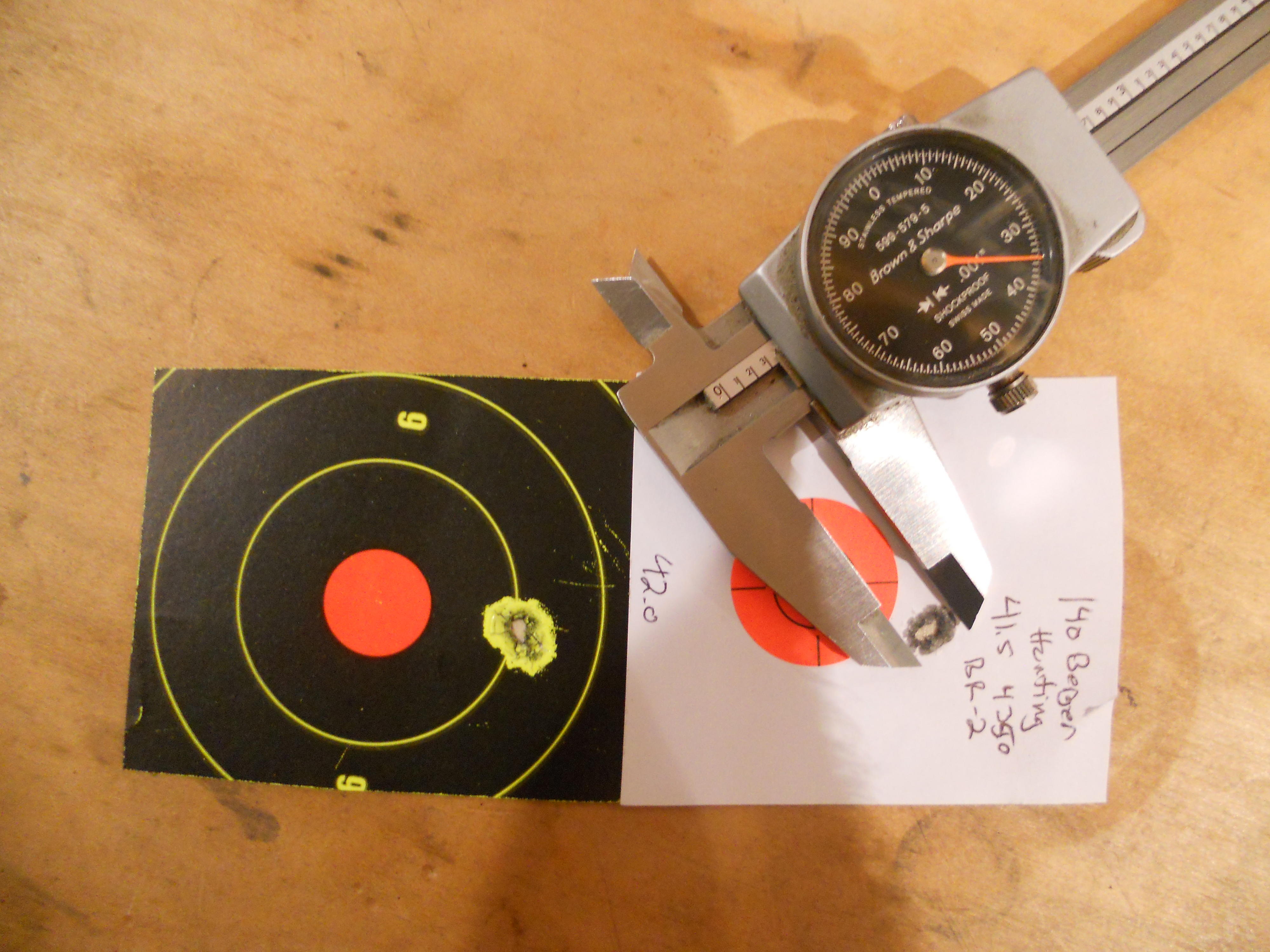

I shot some pretty insane groups today with the AT. It has a OTM/ Robert Gradous barrel and a TBAC 30p1 suppressor. I have been struggling with factory ammo and it turn's out that this barrel just doesn't like 140 amax's. These two groups were 41.5 and 42 grains of 4350 br-2's and 140 vld hunting bullets.
what length barrel? I am about to order on and wanted to shoot the 140 amax...kinda worried now
22 inches, I think I was on the high side of the powder charge for my gun. The amaxs seemed to kick more then the bergers, To be honest the groups weren't bad Id say .5 moa or so. I think if I went back with about a grain less or so Im sure they would tighten up.

Jake thats what Im talking about!!! Good shooting brotha. These barrels should all shoot like that with a good driver and load.
